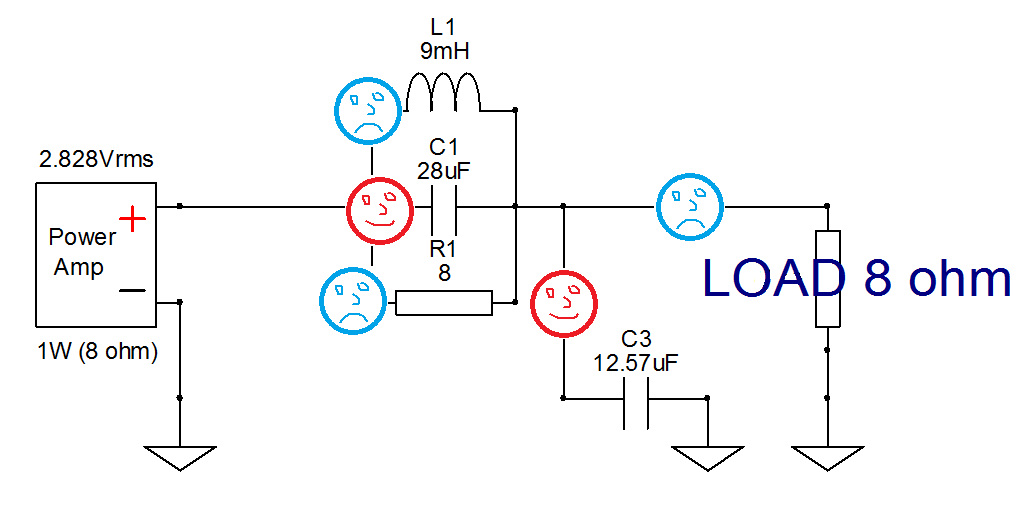

I thought of that too but then ultimately you have the impedance of the driver. Neither driver goes to 1ohm at HF. Or it is parallel of both drivers but that should be not worse than 4ohms?
But HF choose lowest impedance route and C1/C3 sits closest to amp and is far lower impedance route than route out thru drivers.
attachment.php
That said i did read your schematic wrong in that thought S1 driver was tweeter because personal draw tweeters visual on top over woofers, and that make a difference and is mistake by me, sorry : )
So by mistake thought it was a tweeter high pass route trying to have a second order electric filter, but it was a woofer route and calls for a low pass function instead. Therefor culprit as written in previous post is not C3 but C1, in XSim right click C1 and choose "Open" circuit or just pull C1 out of circuit to a empty place without wire connection and your impedance plot will change significantly in real time.
You probably have C1 there for some EQ correction and if important to keep it try add some x,xx R value in electric series, or a x,xx value inductor that hinders HF can pass the route. One can sweep the values up and down in XSim and see plot changes in real time and think this is very handy.
attachment.php
Ok thanks - I see the happy face short to ground = ESR of caps then... 😱:

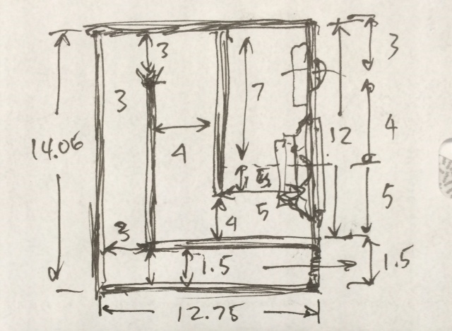

Xrk approx how far down the line is the driver? Looks about one fifth - I've seen some recent TL builds putting the driver approx one quarter down so wondering what these different approaches mean
Sent from my iPhone using Tapatalk
The plan shows 7in down a 48in line or about 15%. It really is something that needs to be optimized and values between 15% to 33% can all work. For this one, it was a practical consideration to provide clearance for the tweeter and to provide some sort of stub to help cancel the fundamental reflection null from the vent terminus.

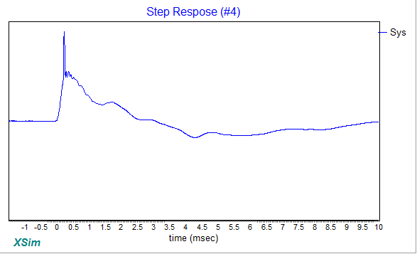

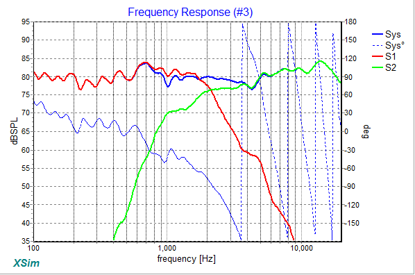

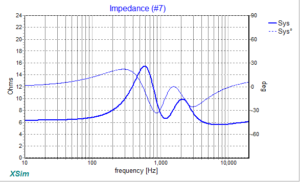

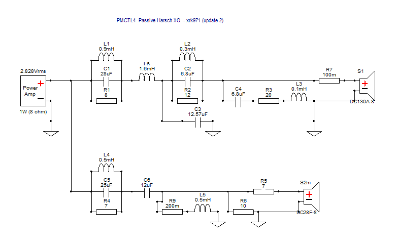

Passive XO update
I was having a real hard time translating the component values from PCD into a generic electrical schematic diagram. I was still missing the key inductor to make the woofer a 4th order low pass (a big 1.6mH unit). Once that was added and I found that Xsim has the opposite sense for time delay (positive value for setback is negative delay), everything seems to look good and matches what PCD has. So no more virtual shorts to ground via cap ESR anymore.
Here is rev2 circuit schematic:
512548d1446563045-low-cost-pmc-inspired-tl-monitor-dc130a-dc28f-xsim-diag-pmctl4-xo-v2-fix-2.png
Here is predicted SPL and XO response in Xsim:
512549d1446563045-low-cost-pmc-inspired-tl-monitor-dc130a-dc28f-xsim-diag-pmctl4-xo-v2-fix-2-spl.png
Here is Impedence in Xsim:
512550d1446563045-low-cost-pmc-inspired-tl-monitor-dc130a-dc28f-xsim-diag-pmctl4-xo-v2-fix-2-impedance.png
Here is SR from Xsim:
512551d1446563045-low-cost-pmc-inspired-tl-monitor-dc130a-dc28f-xsim-diag-pmctl4-xo-v2-fix-2-sr.png
It is a complicated circuit to be sure, and my next step will be to go in and slowly remove blocks to simplify to the extent possible and accept a more ragged frequency response. This is where spending more money a driver that is natively smooth helps because you don't need to mess with notch filters which aren't cheap. So perhaps a passive version could use an AC130F1 (which is as smooth as a midbass driver can get). Also, more attention paid to smooth rebates, and even a trapezoid baffle can remove the ripples even farther. In short, an active miniDSP version allows use of lower cost drivers and simpler cabinets which are then compensated by DSP. With an all speaker level passive approach, you want to spend more money on smooth drivers, smooth baffles, smooth lips/edges to avoid diffraction wherever possible. In the end, a passive line level speaker will cost more to achieve the same level of flat SPL and transient perfect that an active DSP can do for essentially no extra cost.

Plan for front firing TL
I just realized I never posted the plan for the TL as-built with the front firing vent. This plan is literally drawn on the back of an envelope. 🙂
Internal width is 6.0 inches. External dimensions shown are for thinwall 0.1875in foam core. Just maintain internal dimensions approximately at 5in, 4in, 3in, 1.5in deep for each leg. Each leg length is 12in. Driver is 7in from closed end.

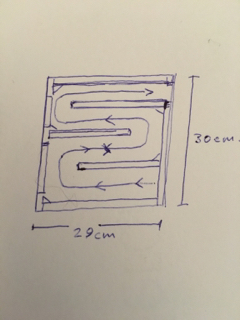

This is the type of TL line I had in mind, excuse the simple sketch. Line length just over a meter, around 105-110cm to tune the line to around 60-65hz (for the Faital). The relatively high fs makes it fairly easy.
110cm is closer to 77Hz. You should follow my sketch and reduce dimension of the internal width to 5.5in - as that has been modeled for the 5FE120 and will probably be accurate. Your line will probably work fine, but a bit short to reach 60Hz.
Just take the inverse of the line length in meters and multiply by speed of sound at 342m/sec and you get frequency for 1-wavelength, now divide by 4 for 1/4-wave TL. A tapered (narrowing) line will extend a little lower than based on this and an expanding TL a little but higher in frequency.
342/(1.1 x 4) = 77Hz
