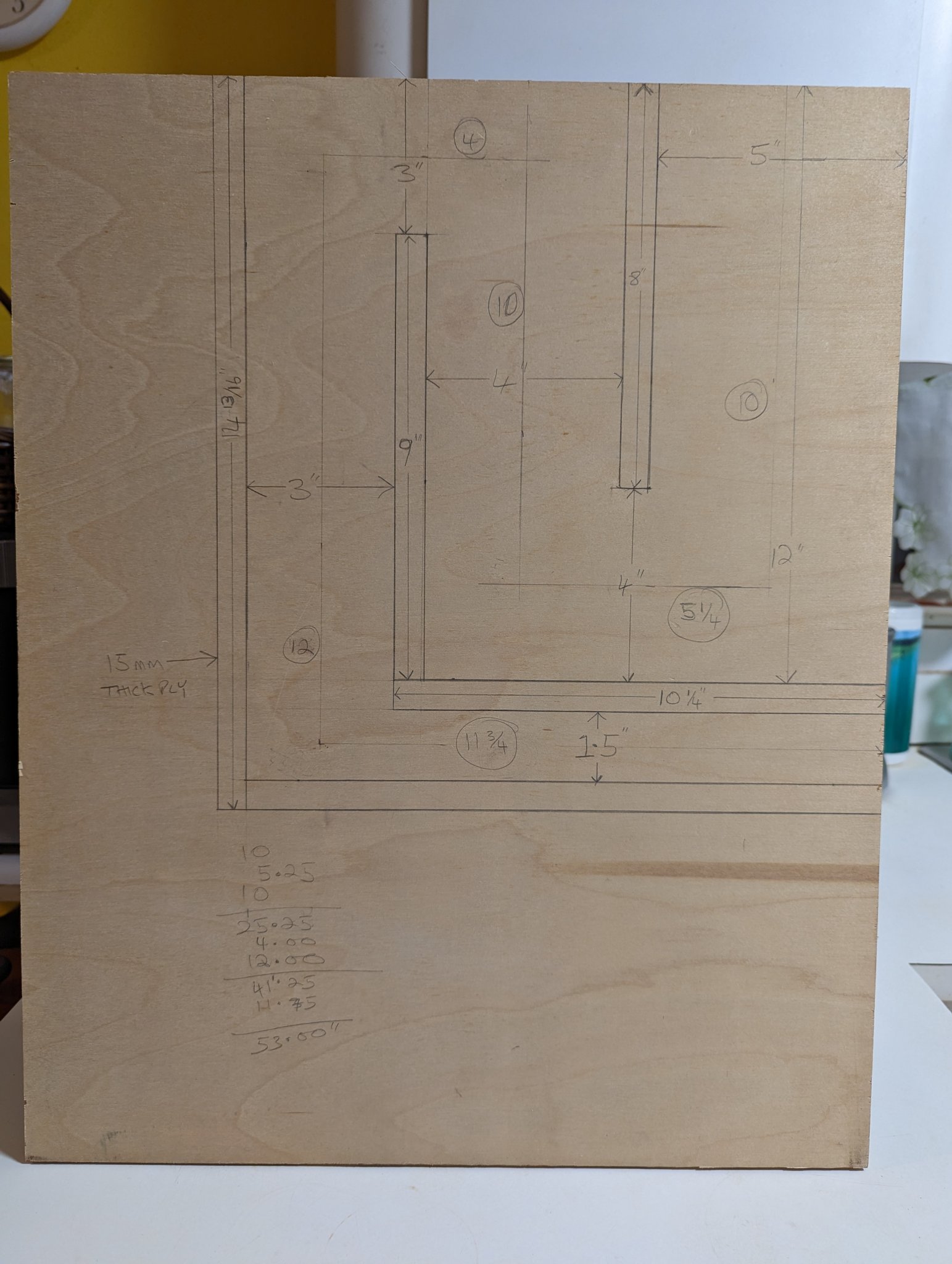

Me again, please indulge me. I drew out the TL on nominally 3/4" Ply. That way with the 6 " internal width I end up with the 7.5" speaker width.
I measured the length of the labyrinth using the centre of the path and have 53" which with the front baffle will be 53.75".
The internal panels are 15mm ply.
Your description says a 48" line.
How much of a difference will the 5.75" make and is it significant ? ( I tell myself yes, it is over 10% longer but I really don't know)
If yes, it is a significant difference, is there anything I can do to mitigate?
I attached a picture for your perusal.
The circled numbers are the labyrinth segment lengths.
Also, in general, given Vas, Qts, Re and Fs, how much difference with these values would be okay as a substitute?
e.g if all 4 mentioned T/S parameters being within +/- 10% be okay to substitute or a different percentage, maybe +/- 5% ?
Many thanks for any assistance you can offer.

A TL’s length is sort of like a woodwind instrument’s length. For a closed end instrument like a clarinet the lowest note is the 1/4-wave length. To calculate that, take length in inches and multiply by 0.0254m per inch. So 48in x 0.0254m is 1.22m. Since this is a 1/4-wave device, this length is 1/4 the length of a full wave or 4x1.22m or 4.88m long is the fundamental low note. The speed of sound is about 342m/sec. The lowest frequency is (342m/sec) / 4.88m or 70 cycles/sec or 70 Hz. This refers to the -3dB point. This number is approximate and assumes a straight TL. Tapering it narrow at the exit makes this value lower. It can only be accurately arrived at by a test build (as in your case) or by comprehensive simulation which accounts for the taper and the stuffing such as Akabak or HornResp etc. I think I designed it for 55Hz and this represents the -3dB point. To estimate what the extra 5in does it simply scales. The tuning frequency is the minimum saddle point between the two impedance peaks for vented alignment.
48/53x55 is 49Hz. This is 5Hz lower but may come at a slight cost of a little less bass amplitude vs the 55Hz tuning.
Why did I design for 55Hz? It is close to kick drum fundamental and still gives more bass amplitude va trying to extract a very low note and having too low of amplitude.
But a lot is adjustable via stuffing tuning. Your ears are good or use a mic and REW software.

Thanks very much for the explanation X. I have a better understanding of what happens with a TL now. I think I will probably go with it as is and play with the stuffing as suggested.A TL’s length is sort of like a woodwind instrument’s length. For a closed end instrument like a clarinet the lowest note is the 1/4-wave length. To calculate that, take length in inches and multiply by 0.0254m per inch. So 48in x 0.0254m is 1.22m. Since this is a 1/4-wave device, this length is 1/4 the length of a full wave or 4x1.22m or 4.88m long is the fundamental low note. The speed of sound is about 342m/sec. The lowest frequency is (342m/sec) / 4.88m or 70 cycles/sec or 70 Hz. This refers to the -3dB point. This number is approximate and assumes a straight TL. Tapering it narrow at the exit makes this value lower. It can only be accurately arrived at by a test build (as in your case) or by comprehensive simulation which accounts for the taper and the stuffing such as Akabak or HornResp etc. I think I designed it for 55Hz and this represents the -3dB point. To estimate what the extra 5in does it simply scales. The tuning frequency is the minimum saddle point between the two impedance peaks for vented alignment.

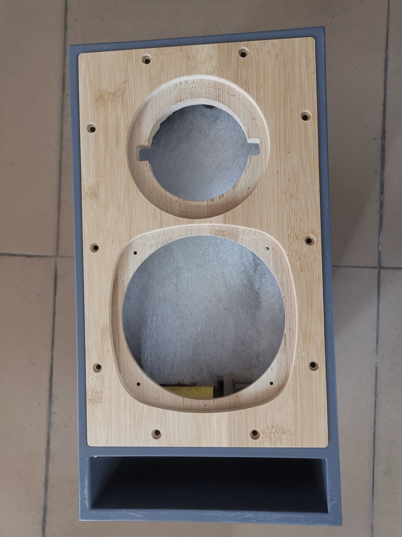

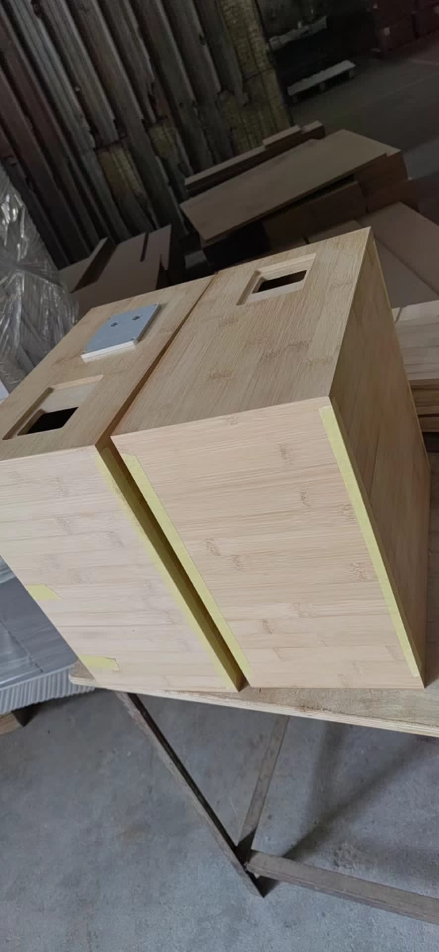

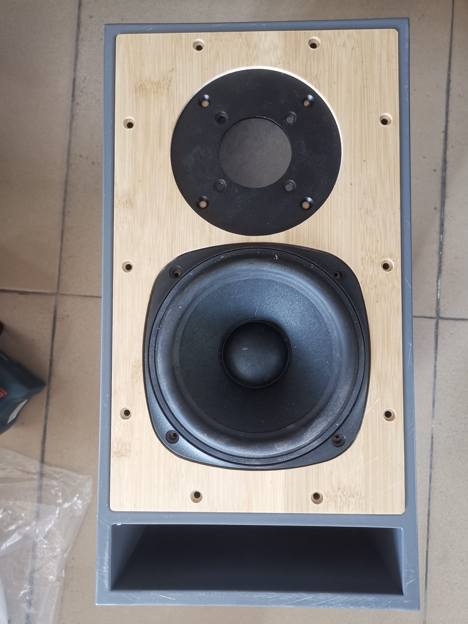

Progress on bamboo baffle TL speaker prototype now waiting for paint.
That looks very solid. Did you choose bamboo to create a stiffer baffle?

Bamboo is both stiff and takes on wood screws without splintering well. Mostly for the cosmetics though. Baltic birch is just as good.

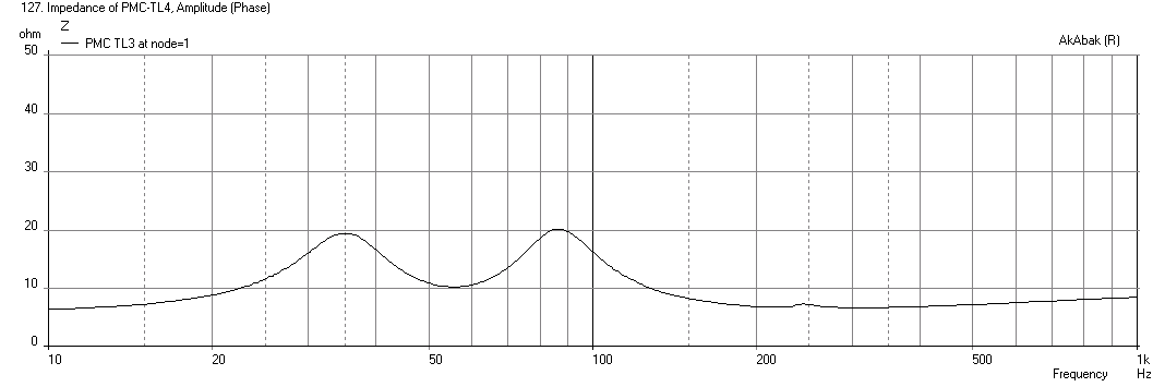

Stuffing density near the terminus (exit) part C, I have found in my simulations using Akabak to have the highest sensitivity to changing the overall bass extension in frequency and too much here will kill the efficiency. Foam lining (melamine foam is best) along first 2/3rds is important to stop the resonances above 100Hz, but doesn’t change bass frequency extension much. You definitely want polyfill or fiberglass etc fluffy stuffing in part A to reduce overall resonances to make the rolloff shallower. This can be seen as a flattening of the two impedance peaks in simulation and measurement. It is one way to tune the stuffing in practice as access to this part is easy by removing woofer. In my case, the whole baffle is removable, like an LS3/5A. One of the nicest things about a TL is that it really reduces the compressive loading behind the woofer and the sound is much more open in the mid range vs a sealed box.

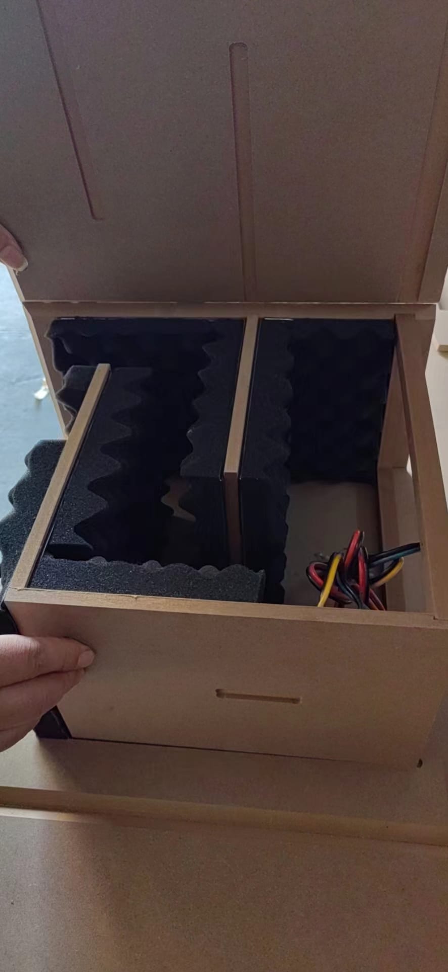

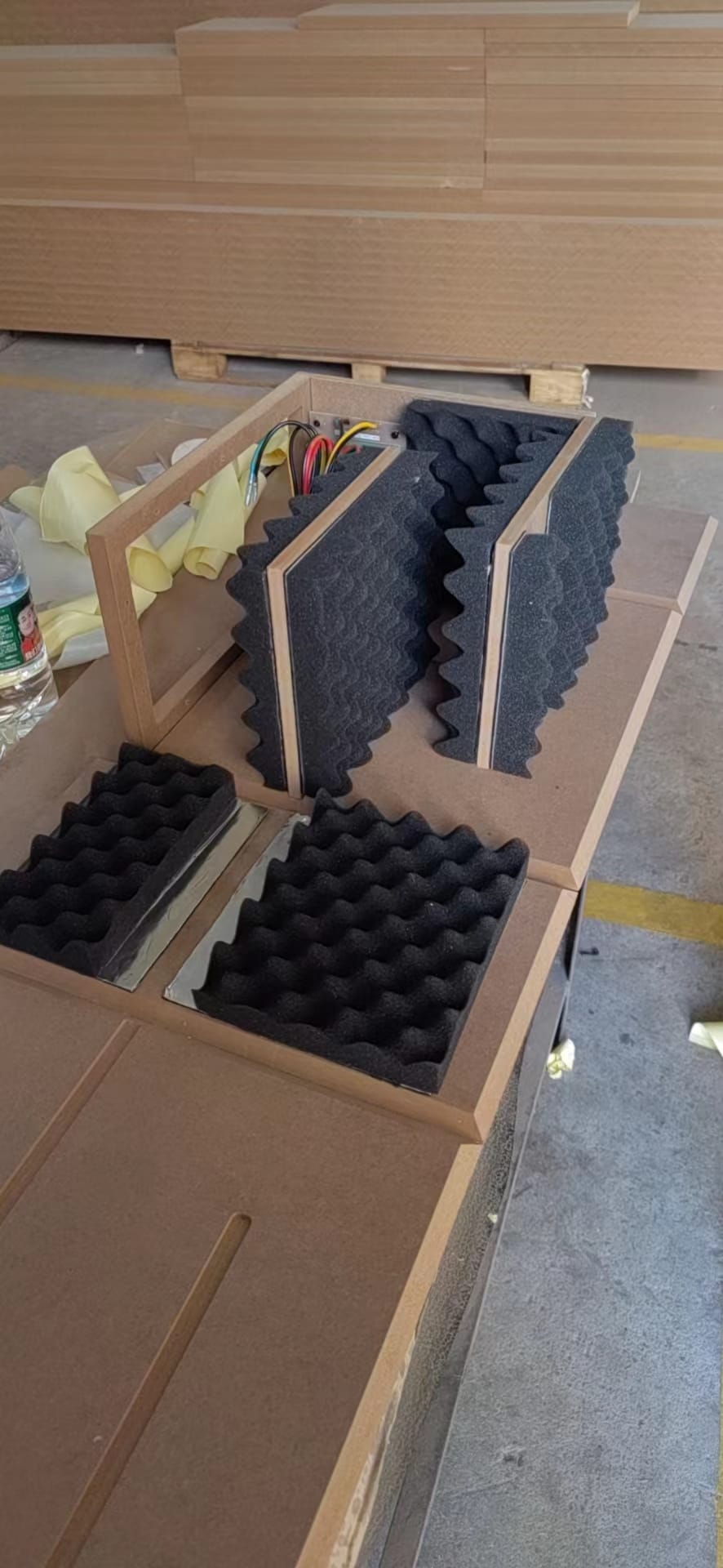

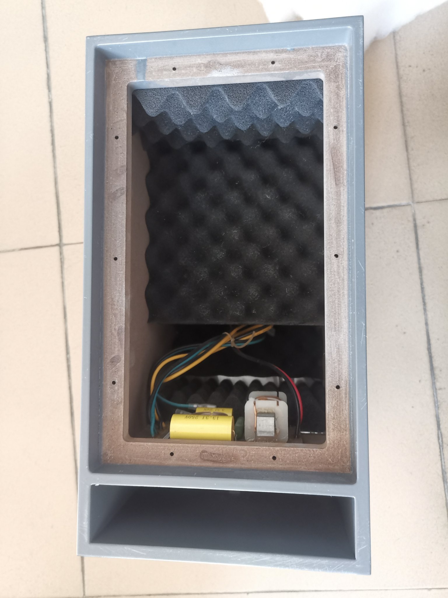

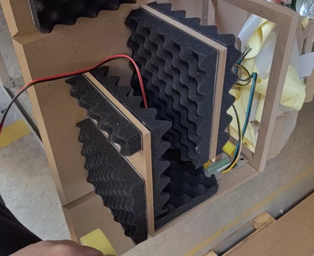

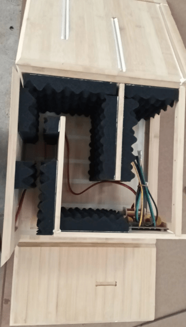

Here are some details on the damping pads internally:

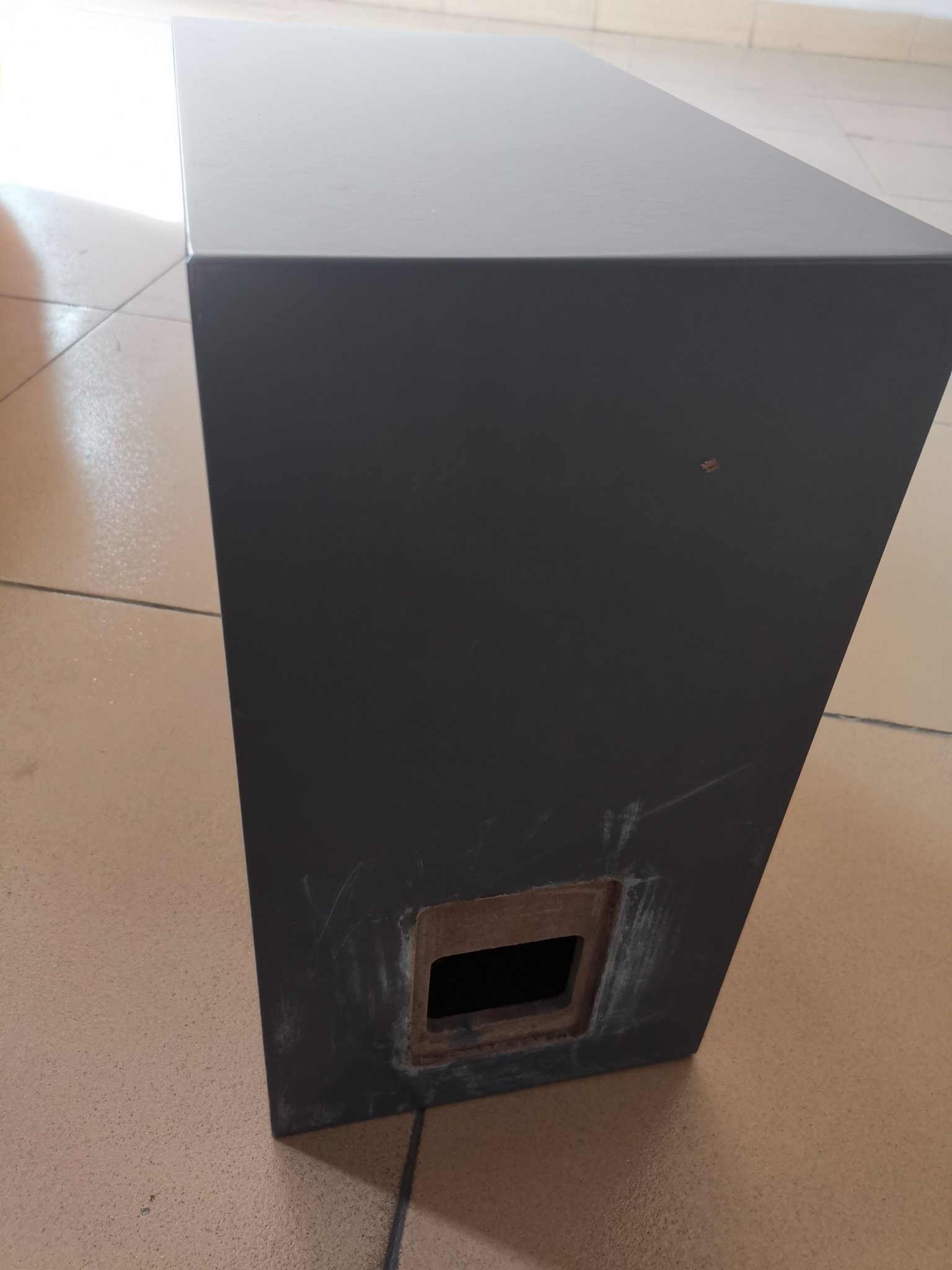

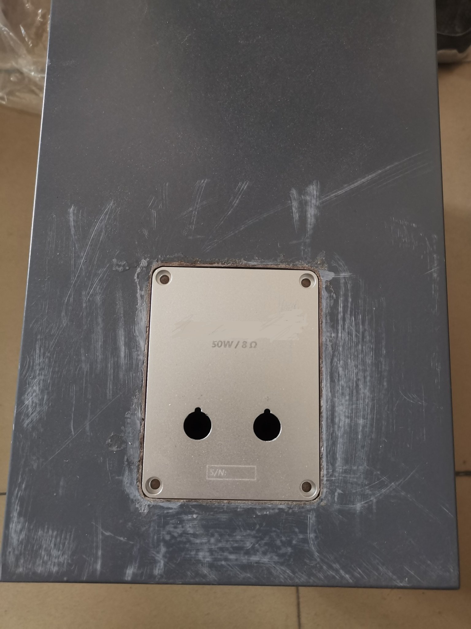

Backside with binding post plate.
Good analysis on stuffing/damping.

AND, thanks for the clear pictures. Looks like you have added damping pads added to the panels?
Was, you are welcome.
Good luck on your build. There is no risk. Just add the foam as shown and adjust fluffy stuffing to taste. Reticulated aquarium filter foam is an excellent alternative to stuffing at the terminus. The size can be precisely cut to fit opening. The length adjusted to suit and it keeps bugs and mice out of your speaker.
Yes, foil faced mass loaded butyl autosound damping sheets. Noico is one typical brand.
