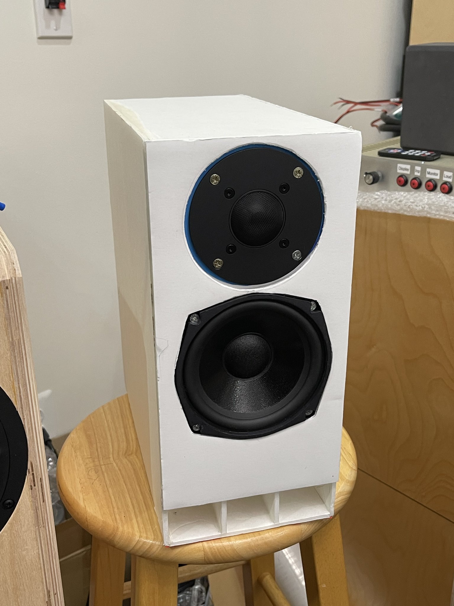

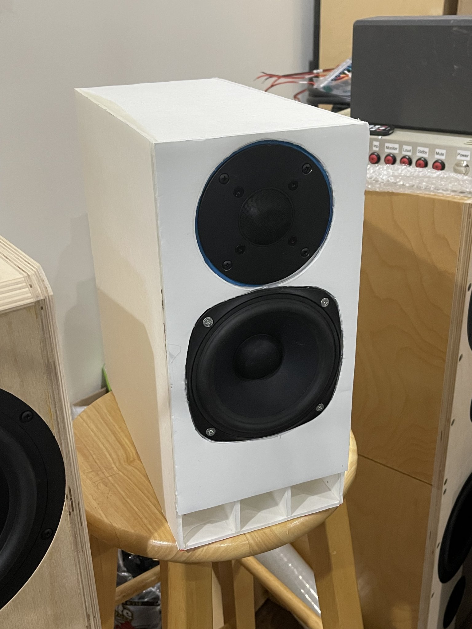

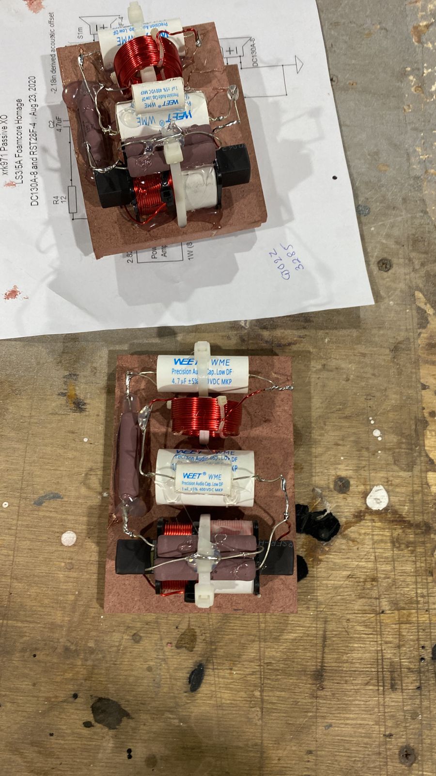

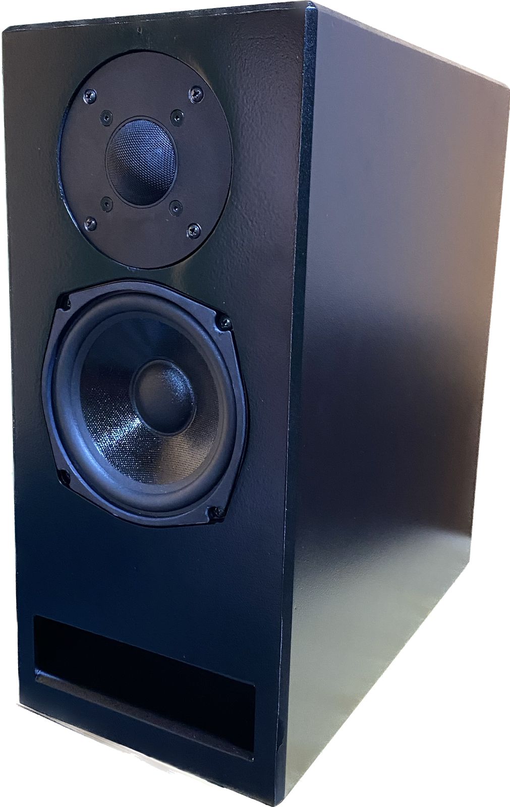

I was inspired by jmascreen’s efforts and installed the passive crossover from my Vanguard speaker into the foamcore TL. It went inside without a hitch and now using RST28F tweeters with DC130A-8. The speaker sounds great. Very nice balance overall and great bass.
This definitely deserves to be made in wood.

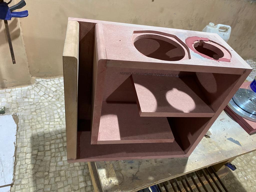

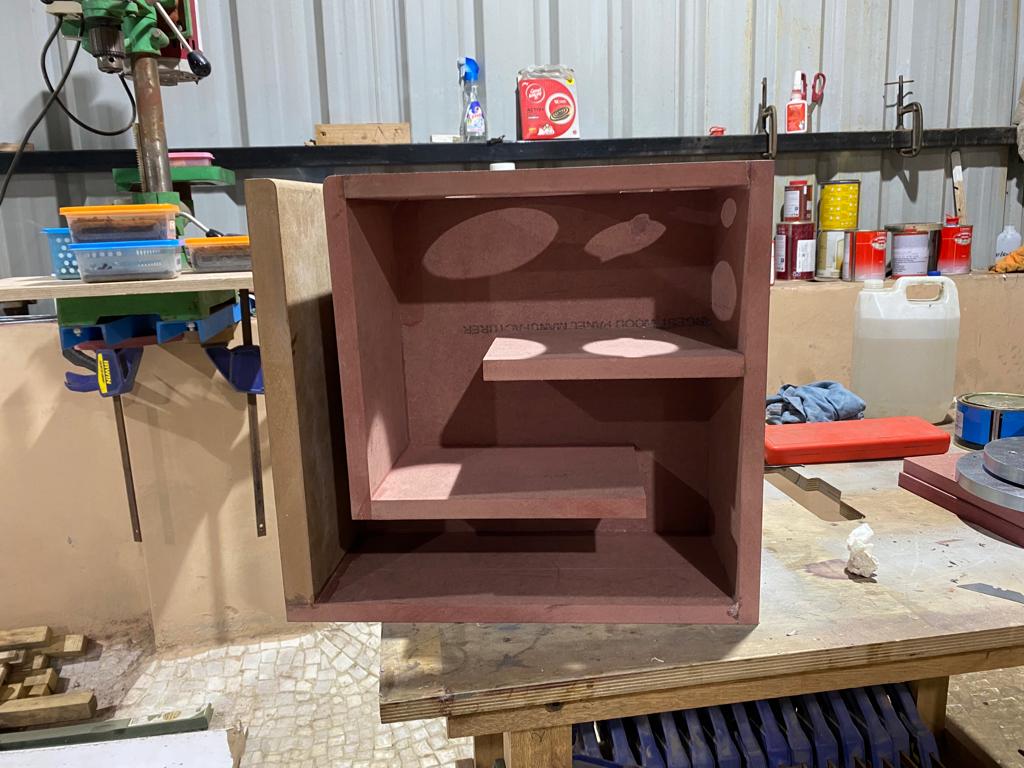

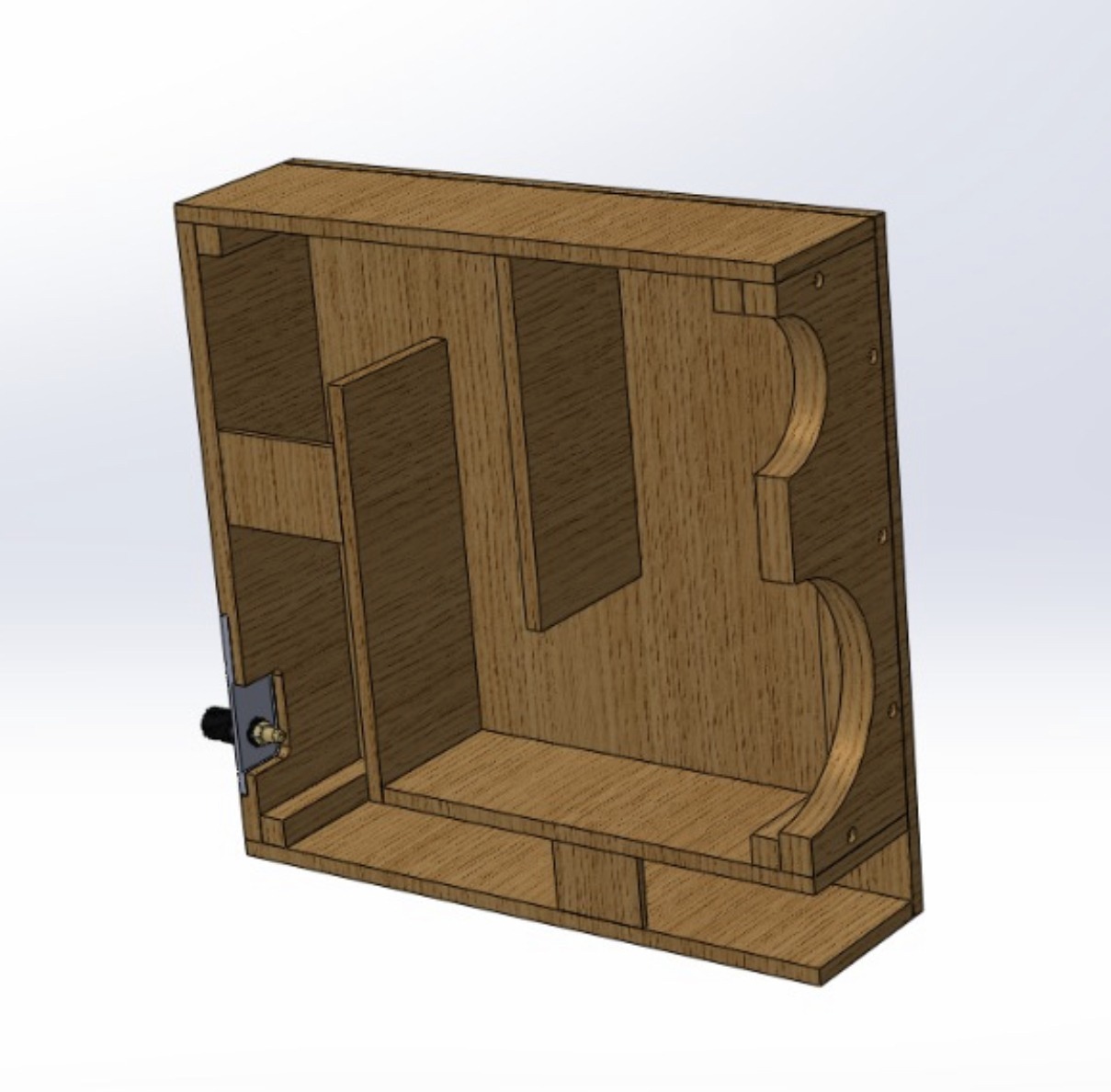

Hi Jmascreen,

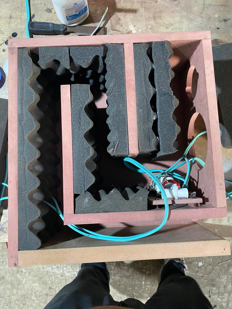

Do you have some more photos of the build of your speakers showing how you did the j get al TL channels etc? The speakers look great. Also, a shot showing the details of the front baffle. Did you recess the driver plate on the tweeter and woofer? Also, are you using the passive XO or doing this actively?
Thanks,
X
Sorry for the delayed response, got busy listening to them :) Here are the images

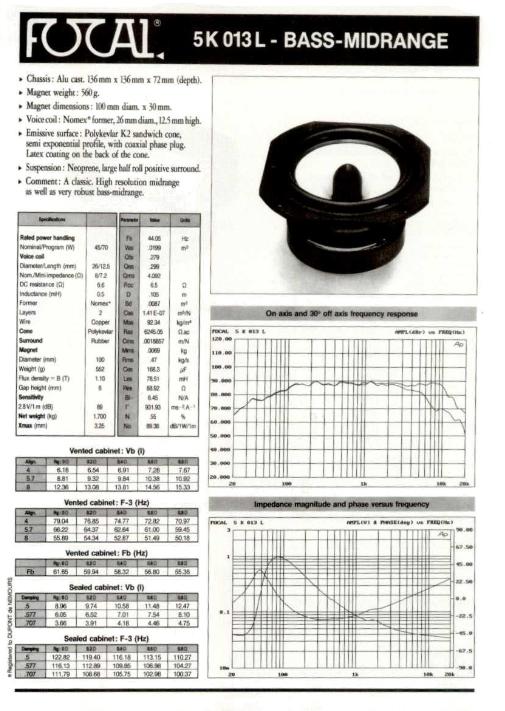

The TS parameters are similar in Fs, Qts, Sd, but Vas of CHP-90 is a bit bigger. It would probably work ok but I can’t guarantee if it will be optimal. Of course, you are on your own with the crossover.
One good thing working on your favor is that it’s a wideband driver so the breakup behavior is very controlled and the crossover should be simple.

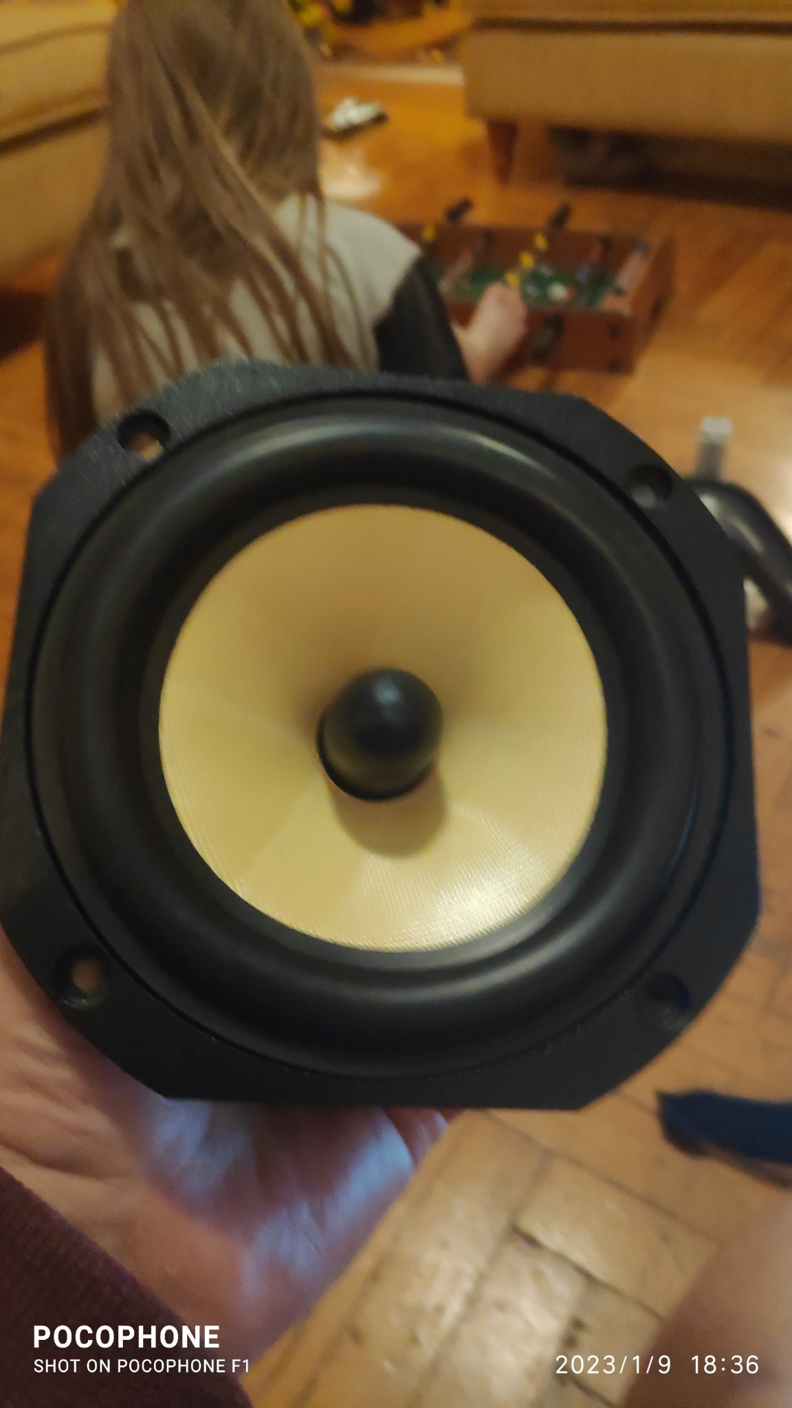

I intend to try it as fullrange widening the enclosure a little ( to 7" maybe) and I will see. So = 35inch 2 and maybe it works .
Elias
That might work - give it a bit more volume.

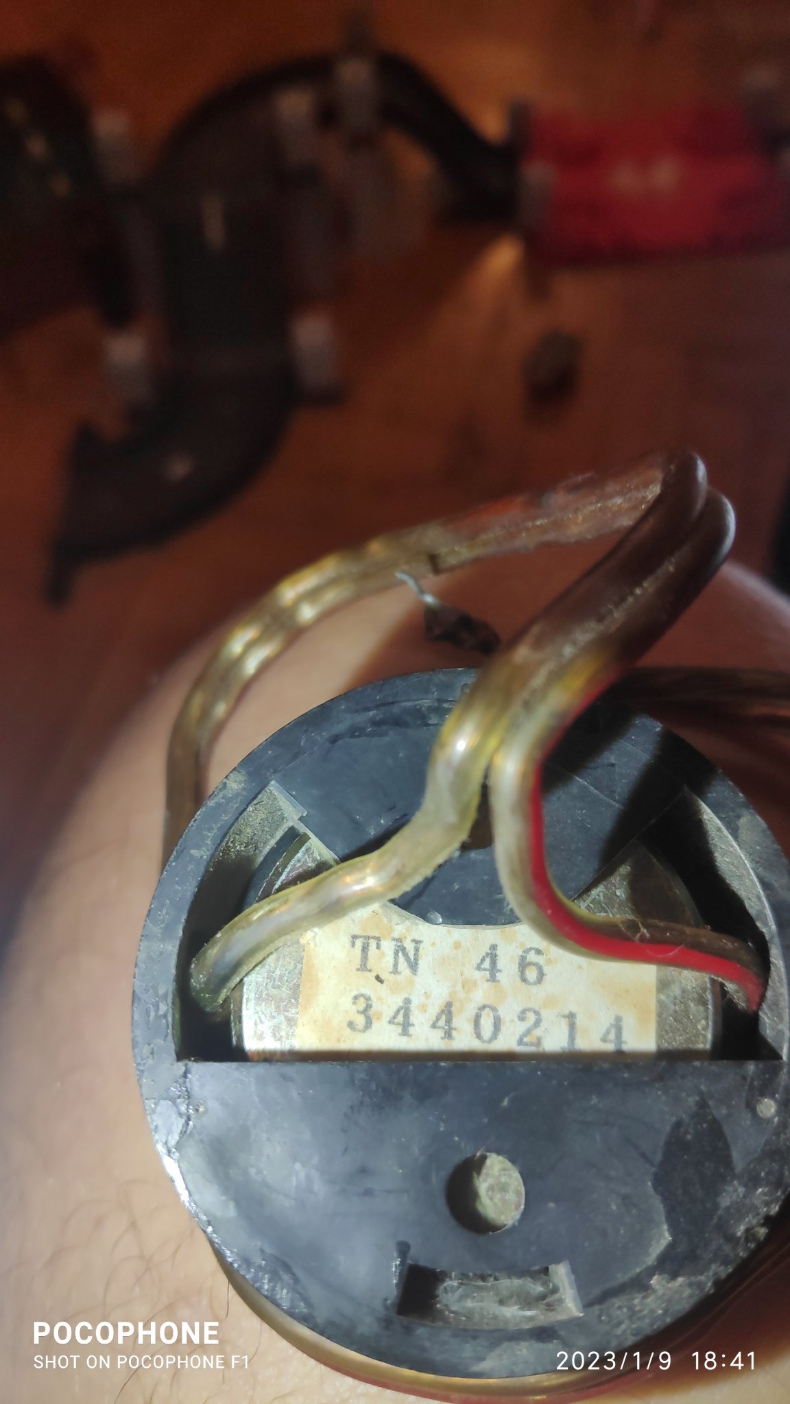

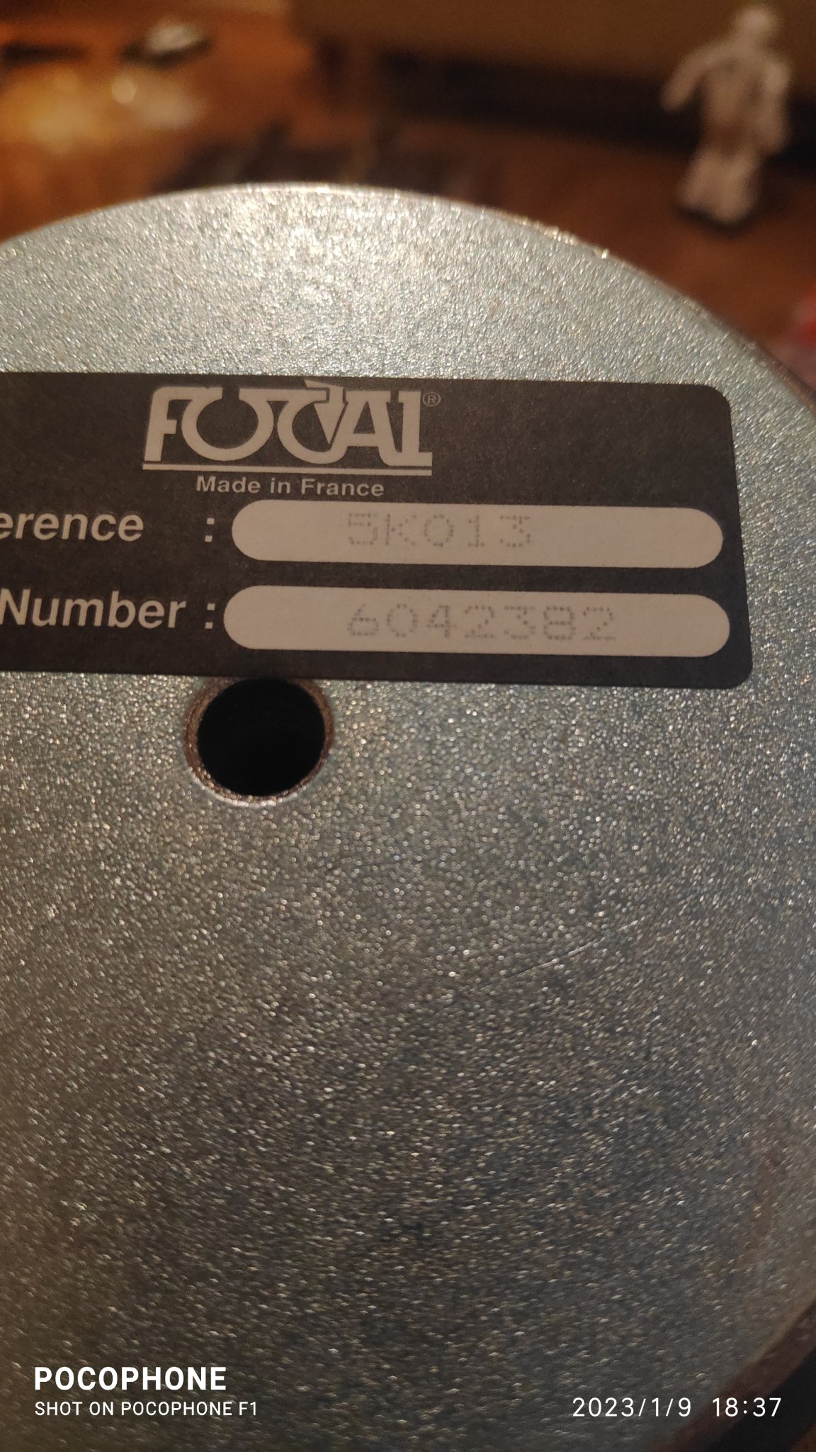

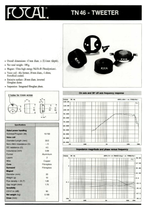

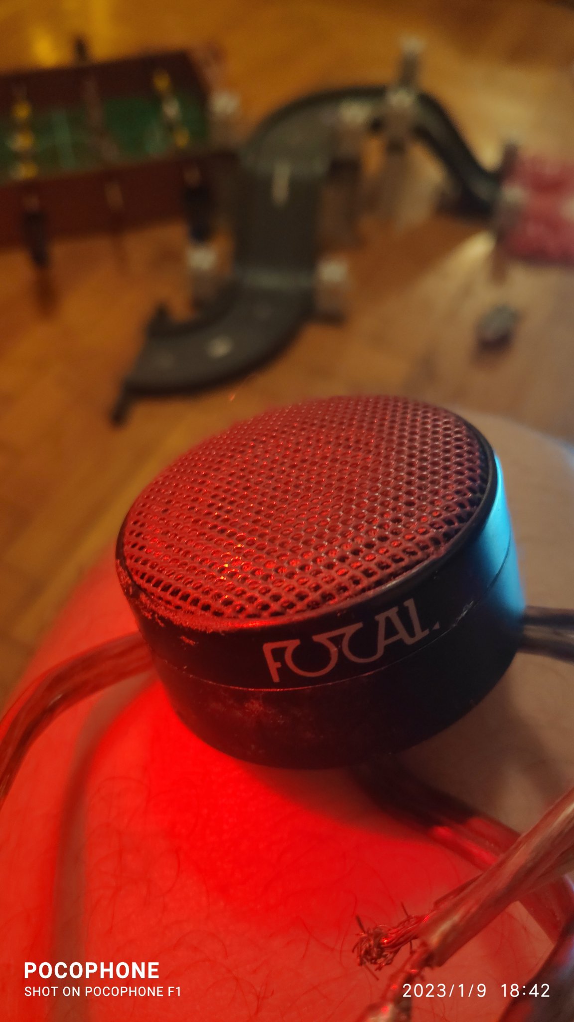

I don't get "encouraging" results :( . I dug these out of my closet. I'll probably install them (new baffle of course) & see what I can do with the crossover
Elias
