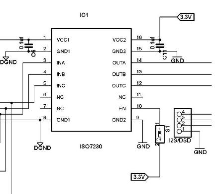

Can anyone explain to me what is the purpose of S1? It connects or disconnects the pin 10 (ENABLE) of I2S isolator from 3.3v voltage.
In datasheet pin 10 is shown to be permanently connected to 3.3v.
