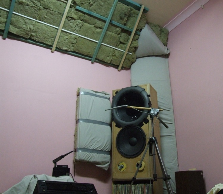

I tried that once. After this was taken I put heavy pleated double drapes over the wall with a gap behind them, and along the sides. The rockwool is 200-300mm thick at the ceiling with a gap behind it. There were more at the ceiling reflection points.putting tons of damping material around the room

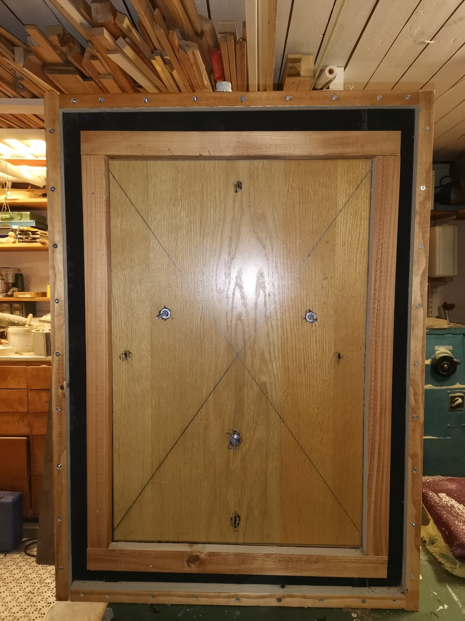

Effectively absorbing something like 50 Hz is impossible in a small / normal room with resistive absorbers, -if you at the same time wish to have some wiggle room and also avoid damping too much of midrange and higher frequencies.
Panel / membrane absorbers along the walls requires much less size and volume to be effective at low frequencies.

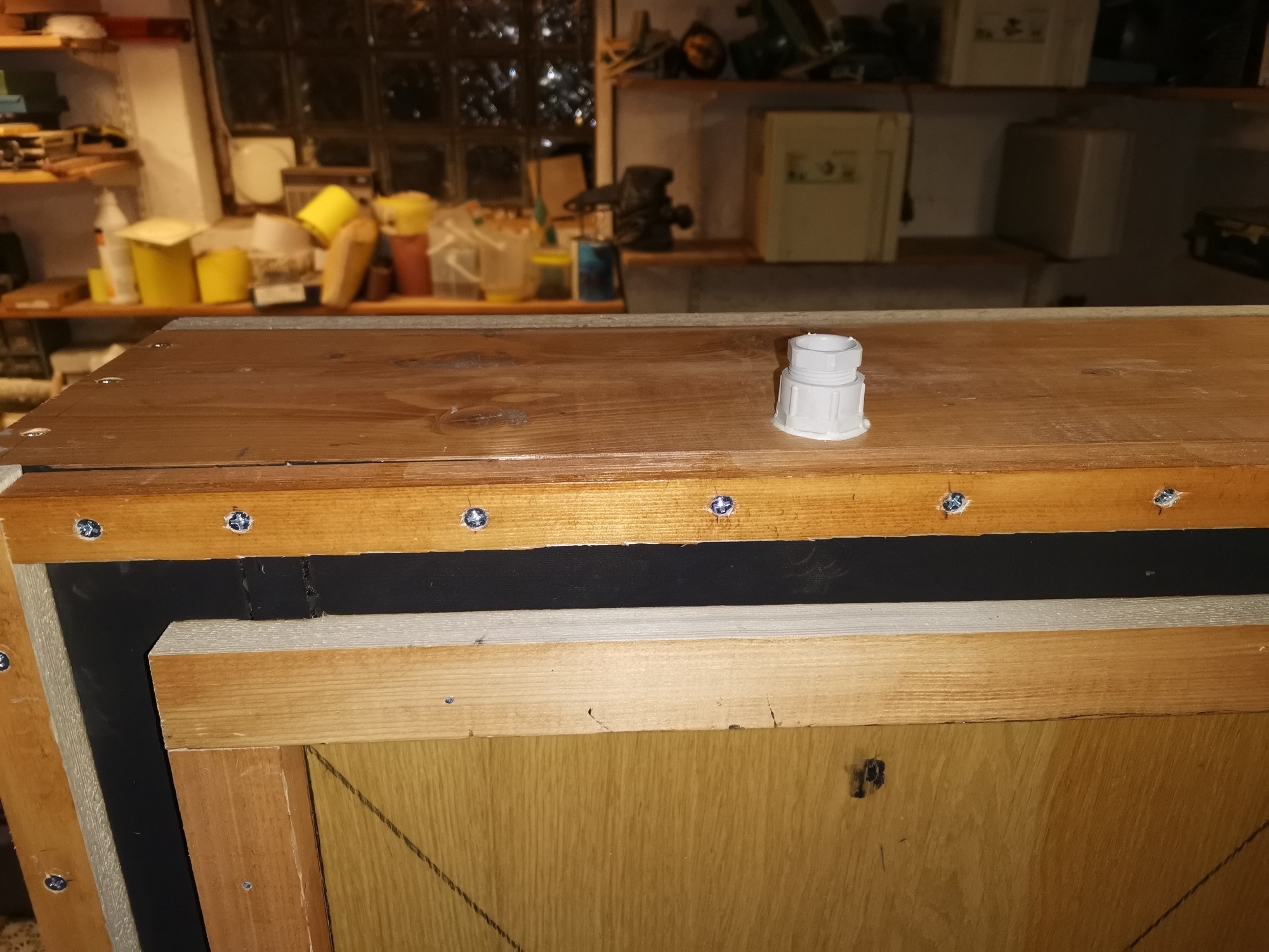

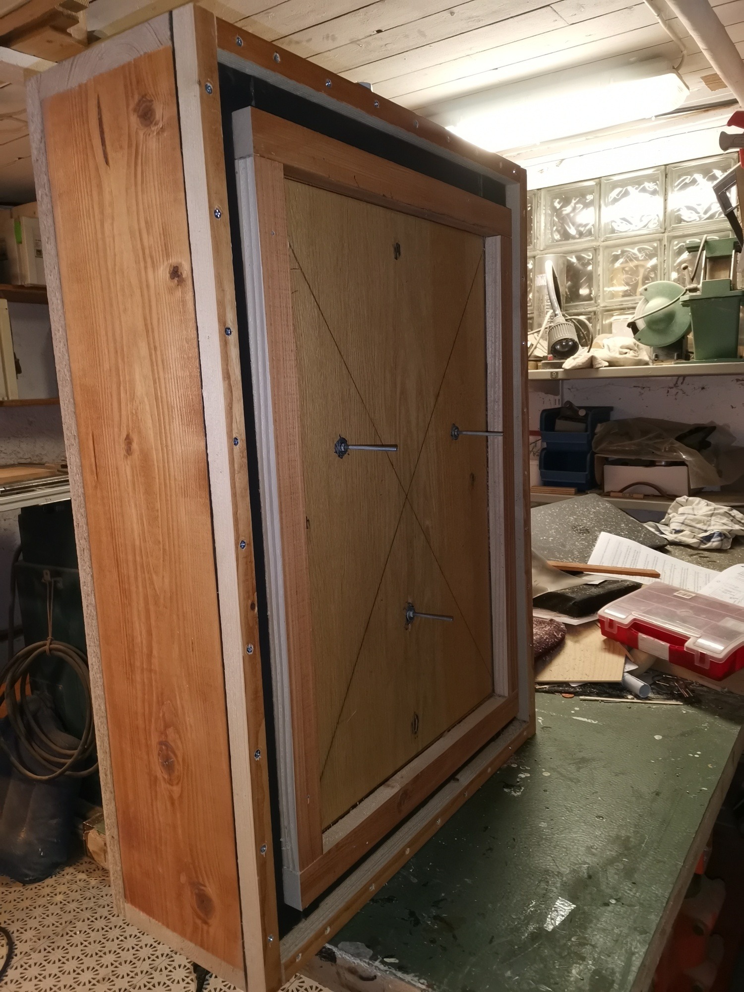

The pictures show a tuneable prototype I made from scrap material. The idea is simple, it is the same as a slave bass driver = A soft flexible surround + a stiff membrane which can be weighted down so the box can be tuned to the wanted resonance frequency. The black part is very soft rubber (like a regular rubber band), the panel is veneered MDF 0,704 kg/m², 11 mm thick, the 3 long screws are used for adding weight to the panel and are sealed off with o-rings + washers + nuts. The grey cylinder on top is a cable gland for Ø 12 mm = the same as a REW microphone. The cable gland is classified as IP 67 = water tight to 1 m below water. Position of it places the microphone 1 cm behind the frontpanel / membrane and 2 cm in front of glass wool inside the box.
So, by playing a bass sweep and measuring with REW, the microphone will show the resonance frequency of the box and by adding weight to the panel the resonance will go lower in frequency. The back is 22 mm particle board sealed with screw and rubber strips, so if the tuning is too low in frequency the back can be taken off. One can then saw off a cm or two to decrease the internal depth and by this increase the tuning frequency while having the front intact.
The box is ugly, after all it is only a prototype for fine tuning to a specific frequency which means: What weight / surface area do I need with this particular size of surround material together with the depht behind the the panel and the glass wool inside the box? For some later nice looking boxes it is important to not change width of the surround or its material or depth or amount of glass wool inside. One can for later ready made boxes have a nice looking fabric in front with a little air gap.
MLV (mass loaded vinyl) has a surface weight of 3 kg / m² and upwards depending on thickness and added filler material (barium sulphate) and it is expensive. If one uses regular vinyl flooring (solid not foamed) 1 mm thick, it has a surface weight of roughly 1 kg/m². Left overs can be bought for cheap at any carpet store. I would use 1 large layer 1 mm thick vinyl flooring as membrane giving a surround width of about 2-4 cm and then add layers with a smaller surface area on top. Use double adhesive tape for the extra layers and check the resonance for a 1st box. For later boxes, glue could be used for the extra layers. The extra layers could be any material, steel, rubber, vinyl, MDF, etc but a flexible soft material would be preferred for a limp membrane with little / nothing of its own resonance.
A ps: I made an identical box with the same veneered MDF sheet as front but without the rubber surround. If I push the one with the rubber surround large puffs of air can be felt at the cable gland and next to nothing for the one without the surround. To be really effective the panel on a panel / membrane absorber must be able to move freely!
