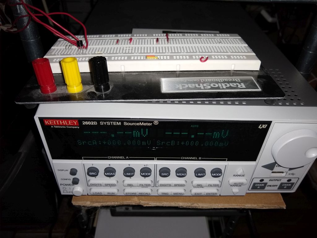

For matching the Pass Stash, I used a Keithley 2602B and a custom Python program that I wrote. The cable harness from the 2602B to the plug-in board is simple solid core copper wire built by me. The plug in board is a Radio Shack ordinary item.

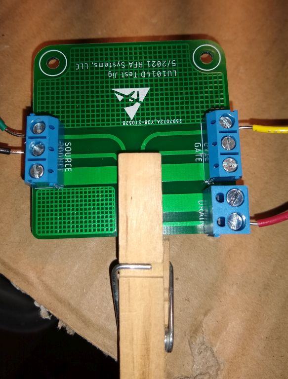

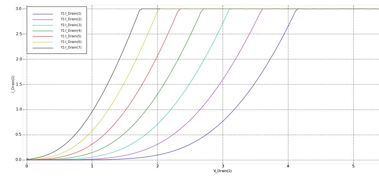

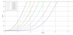

Nice setupLD1010 device on adapter PCB. You will have to take my word for it that there is a device under the clothespin.
Great, the LD1010D also has those triode-like curvesThe adapter PCB is a little "fiddly". It may be advisable to run the LD1010/LD1014 over a piece of very fine grit sandpaper.
Nice setup
JPS64 designed this PCB. It works. I am delighted to have it. It may be available for public consumption. XRK has the say in this.
