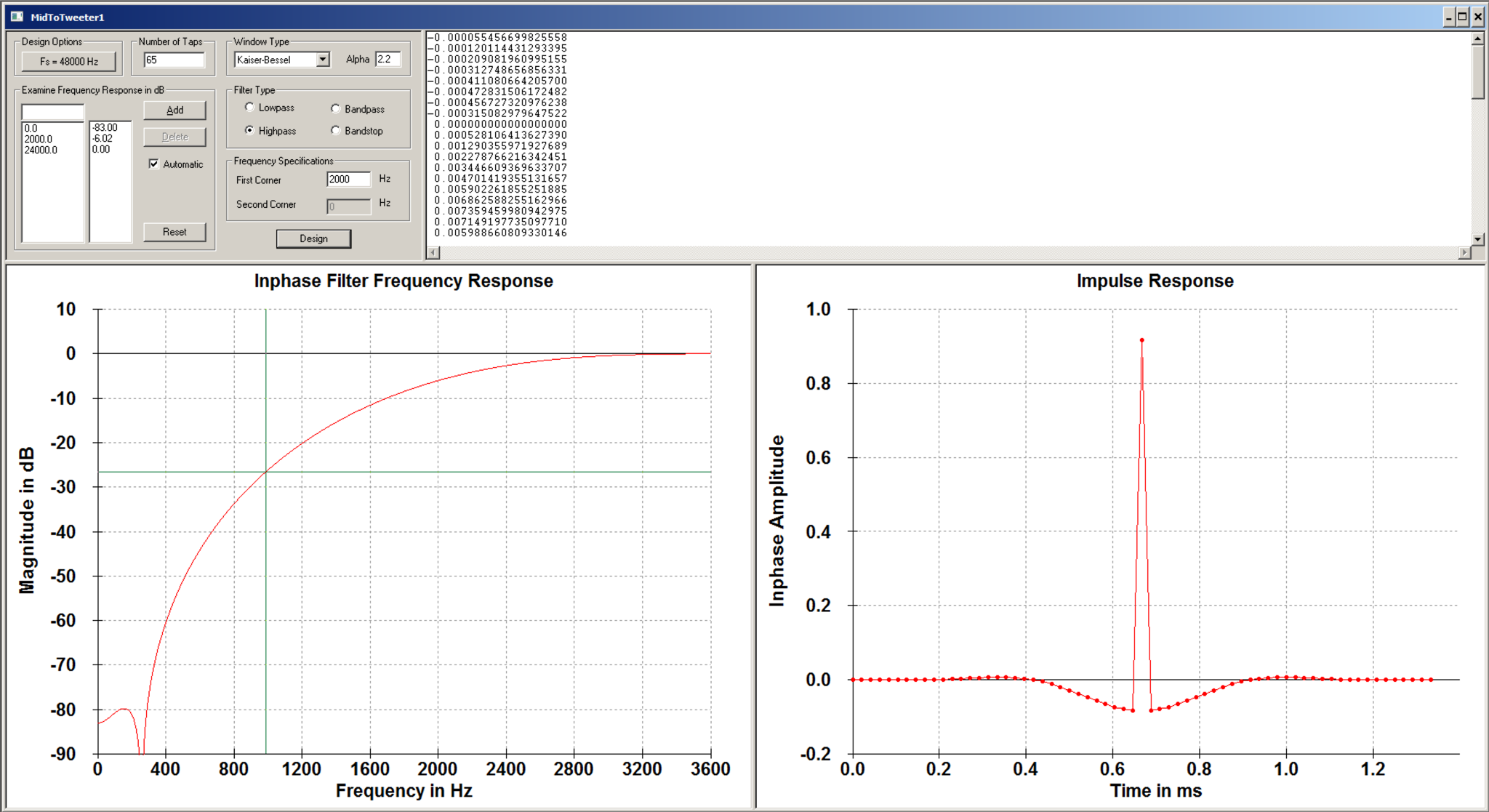

Very steep xovers don't sound good .. especially EVIL digital FIRs (the most common type). You want a smooth transition so there are no kinks in the directivity.
I won't go into why FIRs are truly EVIL cos there are many here who believe they are the bees knees 😊
Er. MiniDSP and others offer IIRs for filter traditionalists.
More to the point, FIRs can be designed to have almost any slope depending on the filter length and other parameters.

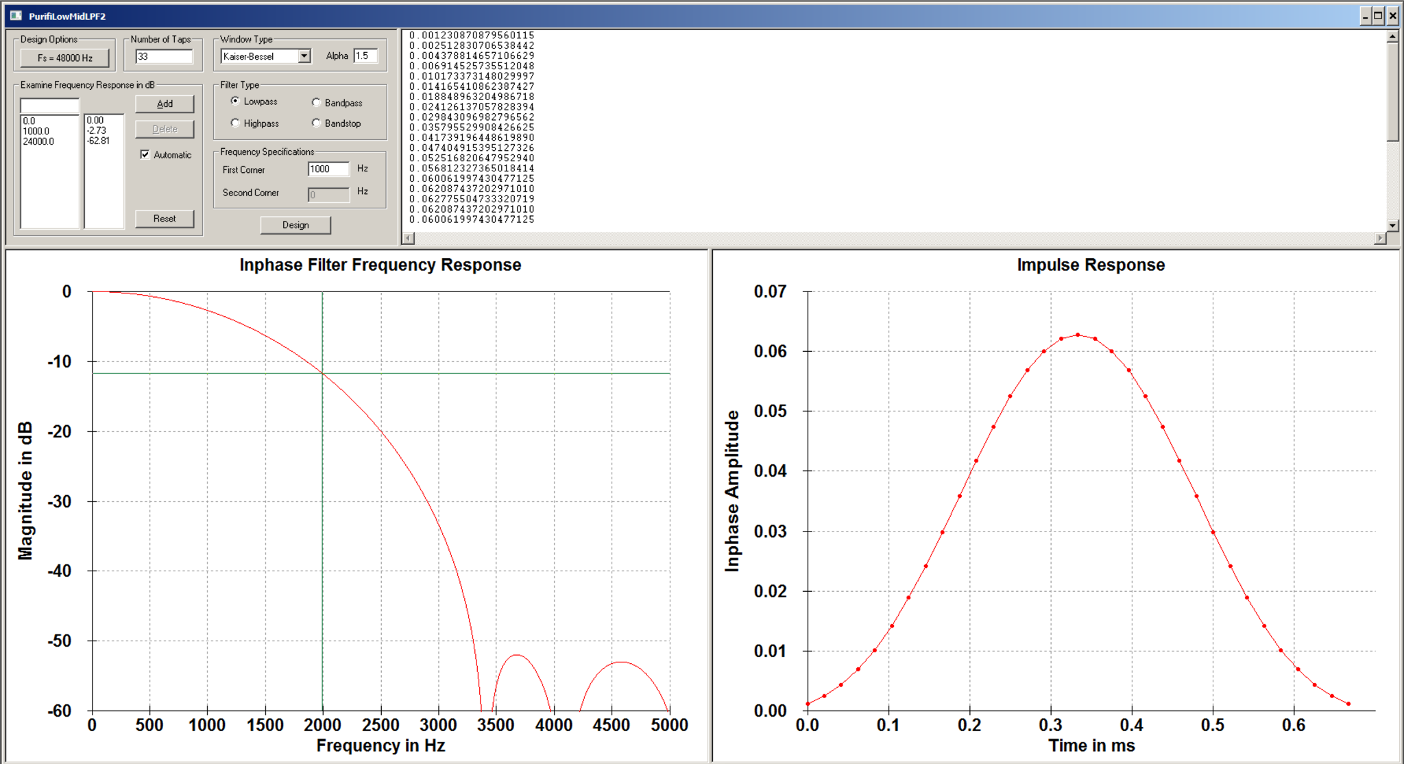

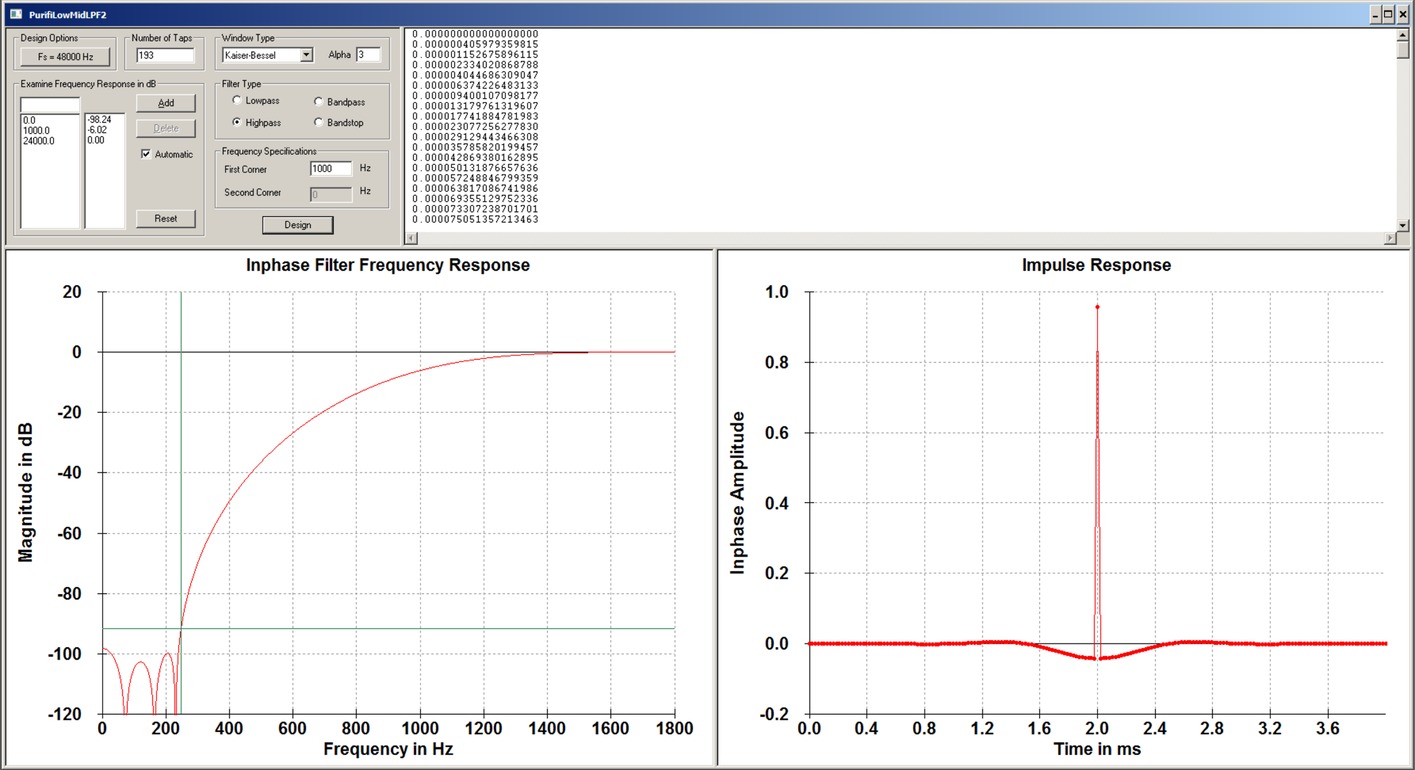

Here's a shallow slope lowpass FIR, -3 dB at 1000 Hz, -12 dB at 2000 Hz, and about -50 dB at 4000 Hz, followed by a medium slope highpass FIR with -6 dB at 2000 Hz, -26 dB at 1000 Hz, -50 dB at 500 Hz, and about -80 dB at 250 Hz. The last is a classical example of a steep lowpass FIR which falls off the edge of the world after the cutoff frequency.
The first is not far from a 2nd order analog LPF for the first octave and chance, the second is close to a 4th order Linkwitz-Riley HPF, and the last is what most people consider a typical FIR.
So why use an FIR for a similar response to a standard filter? Two reasons:
First off, FIRs are linear phase so the group delay is a constant, which to my ears matters especially for percussion instruments. Flat group delay in the low mids around 250 Hz matters when reproducing sharp transients such as snare drums. Snares are supposed to be rude, making you blink when a drummer smacks them hard. FIR crossovers preserve that quality, whereas analog and IIR crossovers do not, making the drum a bit too polite for belief. Moreover I hear linear phase around 100 Hz as helping bass guitar and kick drums from running into each other. I haven't done a careful listen for other frequencies, but seeing as how the ear uses interaural time difference (ITD) below about 1350 to 1500 Hz for localisation [1] I have little ideological problem with using FIRs at 2000 Hz since the overlap could extend down to the ITD sensitive range.
Second, FIRs can be tuned for useful attenuation outside the passband as shown by the steep HPF example, again -6dB at 1000 Hz, then -19 dB at 700 Hz, -36 dB at 500 Hz, followed by -90 dB at 250 Hz. The rolloff is not far from a Linkwitz-Riley 4th order for about the first half octave (implying almost a full octave of overlap when used with the complementary LPF for the other driver) but it increases dramatically beyond that point. This means the tweeter doesn't have to deal with much signal outside its passband as neither does the midrange, which could help tame drivers with resonances beyond the crossover point.
Conclusion: like any other tool FIRs can be useful or harmful depending on how they're used. As an aside, phase response is worth considering but only until 2000 Hz or so.

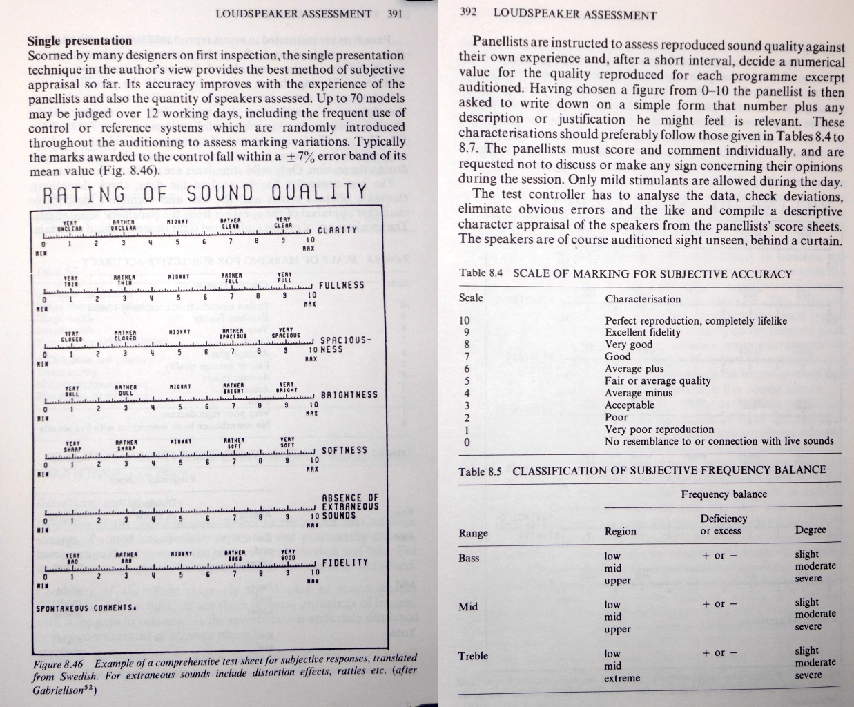

In my Book "High Performance Loudspeakers - 4th Edition 1991" by Martin Colloms (Monitor Audio), there are tables and descriptions matching measurement and tonal observations vs. audiophile descriptions...
Let me take some pictures of those pages and be back ! 😉
T
@ginetto61 : Here are the pages in question, concerning loudspeaker assessment :

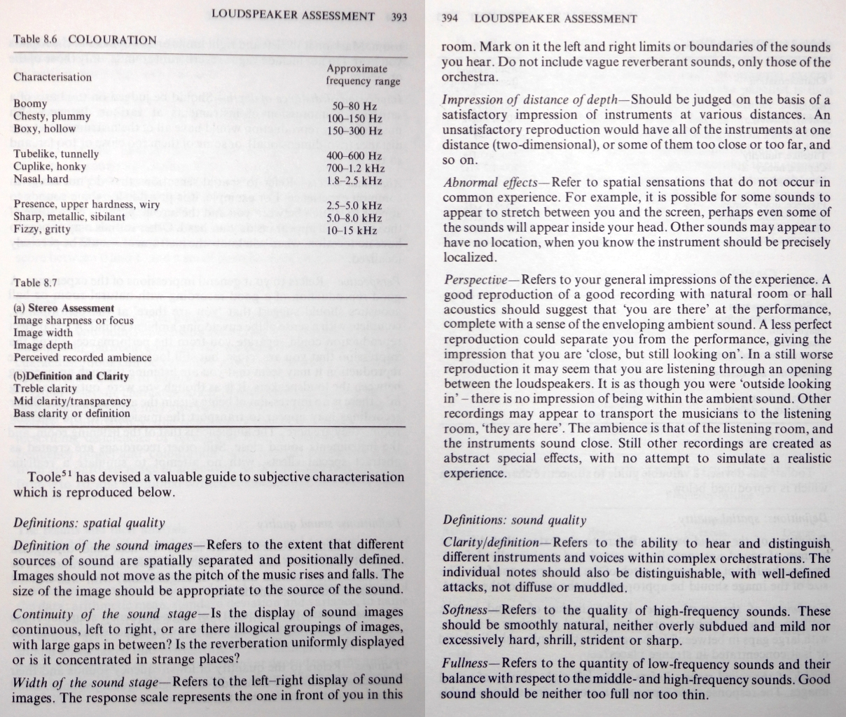

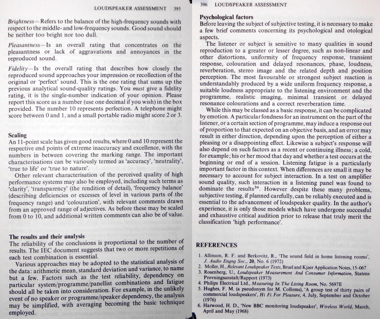

Hi sorry for the belated reply@ginetto61 : Here are the pages in question, concerning loudspeaker assessment :
