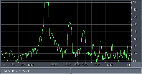

Here is results of narrow band burst centered about 1700Hz:
The peak drive voltage was somewhat higher than for above results. Once again response shows mostly simple harmonic structure, some intermodultion structure, and a very low apparent noise floor.

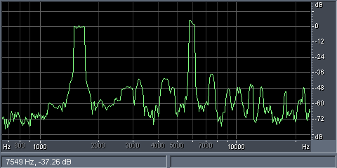

Results of dual peak bursts with centers about 1700Hz and 6kHz with same peak drive voltage as the single 1700Hz burst:
Intermodulation components dominate. Energy for the harmonics of the 1700Hz burst component have been tapped and taken up in formation of intermodulation components.
The apparent noise floor has risen. Harmonic distortion is always attended by intermodulation. The wider the bandwidth the greater the potential for harmonic content.
Inject continuous white noise into a loud environment and the perception is often a quieting effect. The damping muscles of the middle ear are brought into a near constant level of action. Inject noise modulated to the environmental noise sources and perception is of a louder environment with grainy texture.
