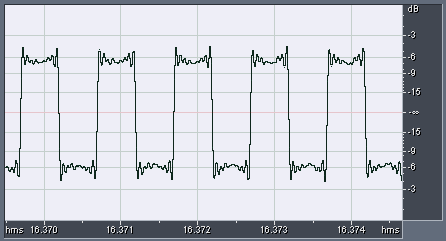

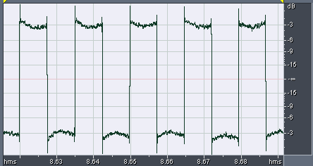

Square wave performance is a simple test. A recognizable square wave is readily observable in speaker performance when amplitude and phase of even just the 2nd and 3rd terms of the harmonic series are reproduced both with proper amplitude and with proper phase. Many, if not most speaker transducers, regardless of type, are capable of reproducing good approximations of square waves at certain frequencies. 1kHz square wave in and of itself is trivial; consistent square wave performance over the fundamental range for human voice and musical instruments is much greater challenge.
Very few designs rise to this challenge. This is not because speaker transducers and associated technology are primitive, but because they all obey the laws of physics. Even though ESL has low mass membrane, effective air mass loading across spectrum results in phase changes of acoustic output compared to input signal. Drivers with voice coils have additional phase changes across spectrum due to inductive reactance.
Physical performance is readily predicable, and quantifiable through measurements.
Tom Danley's Synergy horn takes hold of physics, and implements design capable of recognizable square wave over extended regions of spectrum, using only dynamic drivers and passive crossover.
A couple of pictures posted by Tom:
250Hz:
1kHz:
Really exceptional for a speaker designed for PA work, using nothing more than truly primitive loudspeaker technology.
Other posts to Tom's thread show some nice 1kH square waves too.

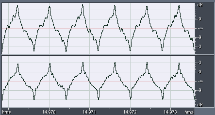

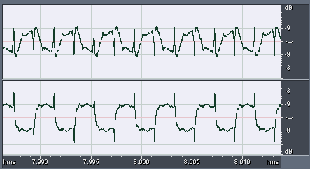

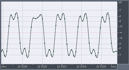

Here are results feeding square waves into small fully active speaker with DSP:
1kHz:
67Hz:
4kHz:
The DSP implemented fully active speaker smoothly produces square waves from about 60Hz to 4kHz. Above 4kHz too few harmonics of square wave are produced to yield square wave result.
