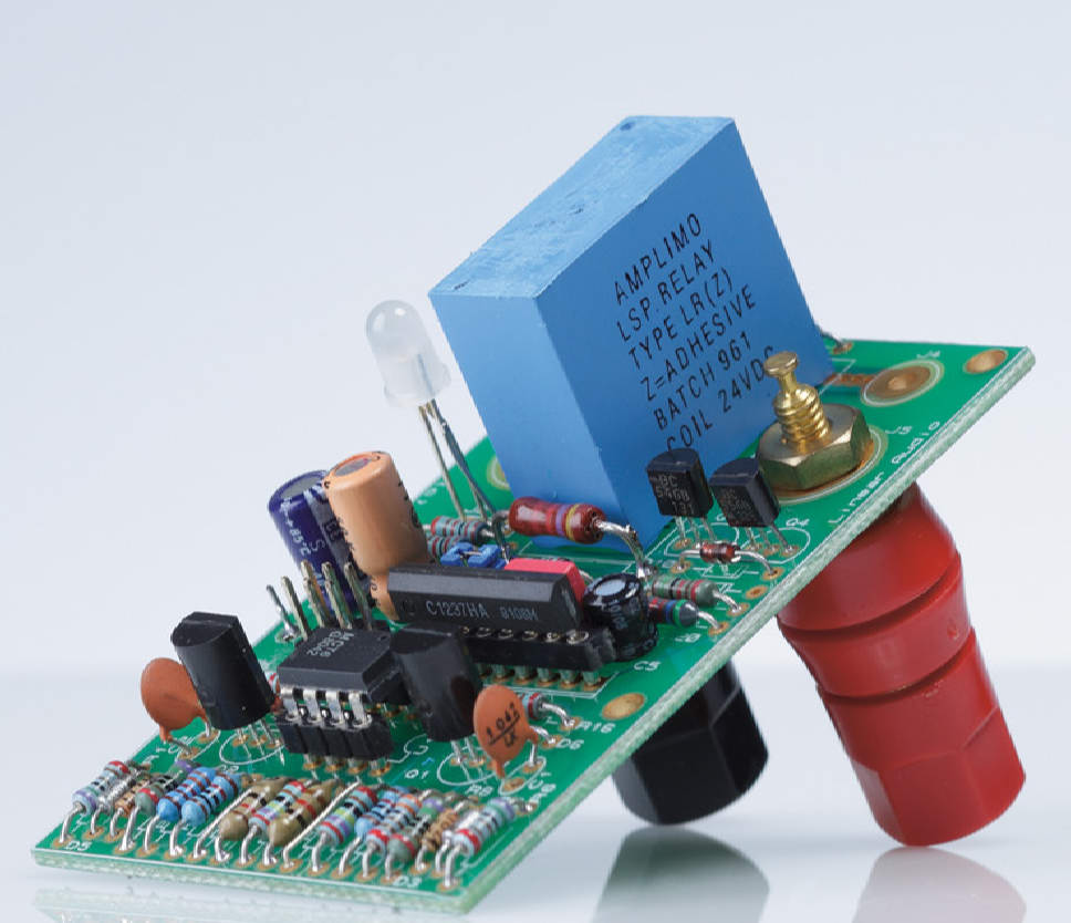

See pic of the relay on my ec amp protection board for size. I use one relay per channel and parallel the contacts.

hoka said:nice protection pcb, where did that come from?
Buy the May issue of Elektuur / Elektor and all will be revealed 😉
Jan Didden

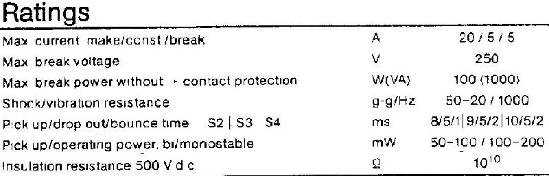

S4, 2 relays in parallel makes 40A, 8000VA AC or 800W DC from 8 contacts.
Factory box NOS SDS S4's were posted for 1 Euro/pc on this forum.
Or else:
these
mat02ah said:the best compromise is a Matsushita (Nais, Panasonic, SDS ...) S Relay.
Or else:
these
