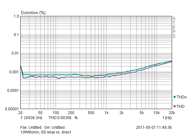

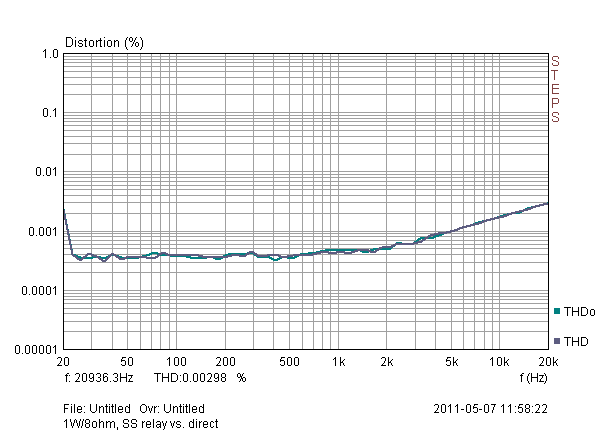

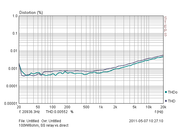

Look at attachments.. Do You mean, THD is ruined? Rdson is about 10mohm.Yes, the nonlinearity of Rds(on) will ruin THD long before Rds(on) itself ruins damping factor.

What MOSFETs and how many in parallel did you use for this? My experiments gave about 0.003% extra THD at 100W into 4 ohms. Acceptable for me but Douglas Self would probably consider it "ruined".

IRFB4110, 2pcs in series, not paralleled.What MOSFETs and how many in parallel did you use for this?
Those look great for amps with lower voltage rails. My test amp had +/-55V rails so I used some higher voltage parts with a somewhat higher Rds(on).
