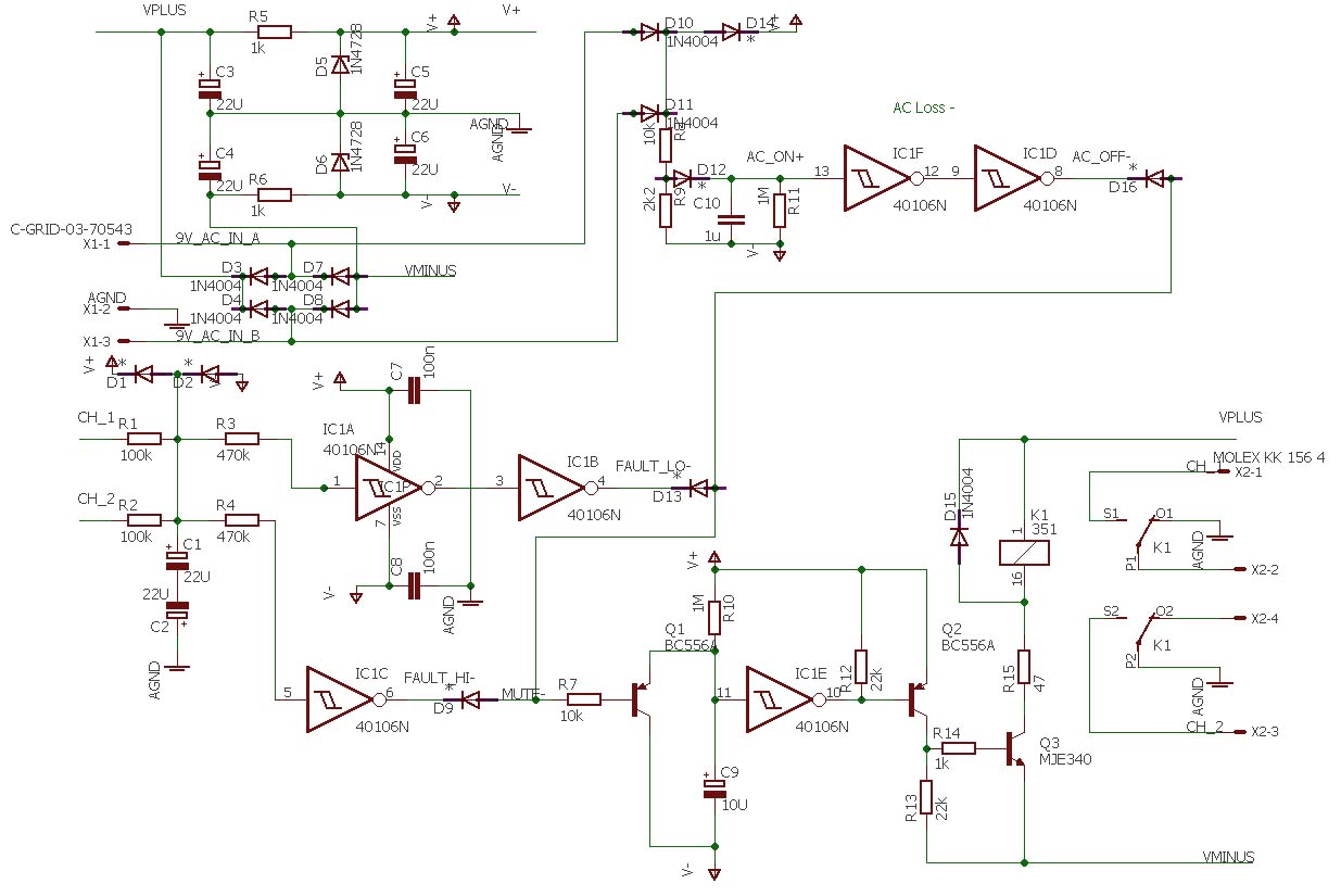

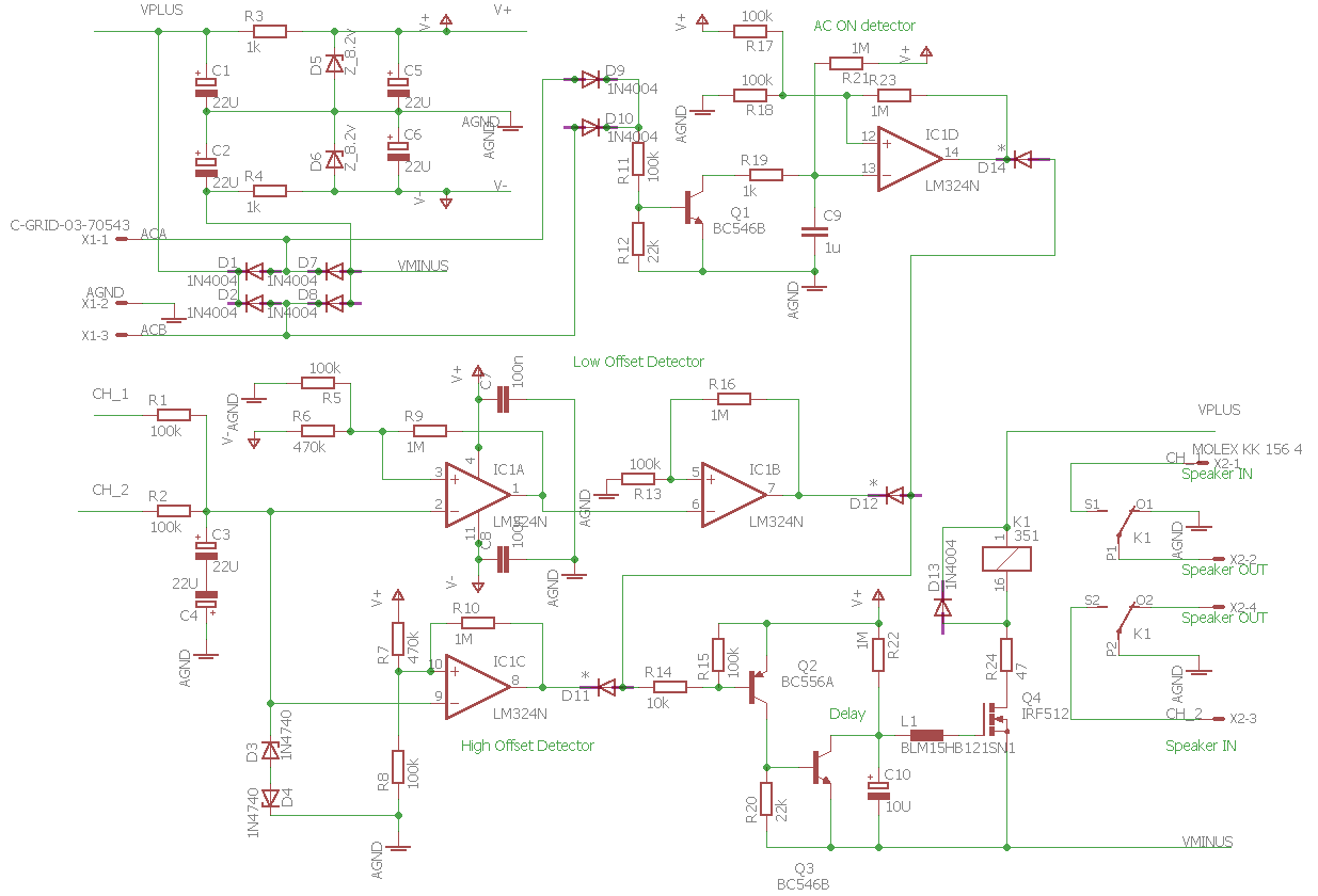

Below are three proto designs similar to the Hafler approach, using opamps, CMOS logic and discretes. These are just examples of DIY approaches that may suggest ideas for your own.

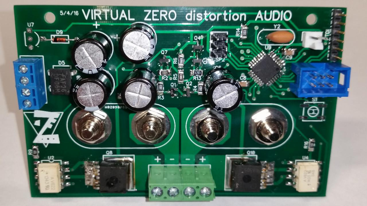

Hi Slowhands,
You may be interested in our complex approach:
21-st century power amp control boards
The boards are versatile, flexible (microcontroller-based), robust (we use solid state relays and "reserved" protection circuits), protecting not only the speakers, but also the amplifier's output stage (especially with rails control option in place).
You can find a lot of details, schematics, etc. in "How to build a 21-st century protection board" thread here.
Valery

This schematic is too complicated for build (SMD transistors, too complicated topology of detecting overcurrent, and too many electronic components....), so most people at DIY prefer simple schematic and TH elements...and easy available.
When i have time, i will layout this universal speaker protection but with TH elements...because i don't like SMD parts.
And if you see closer above schematic from SC is basic idea of that is published in EPE (it is upgraded version of SC published a few years ago)
Anyway interesanting complex schematic.
