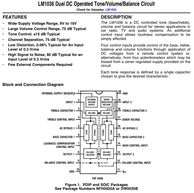

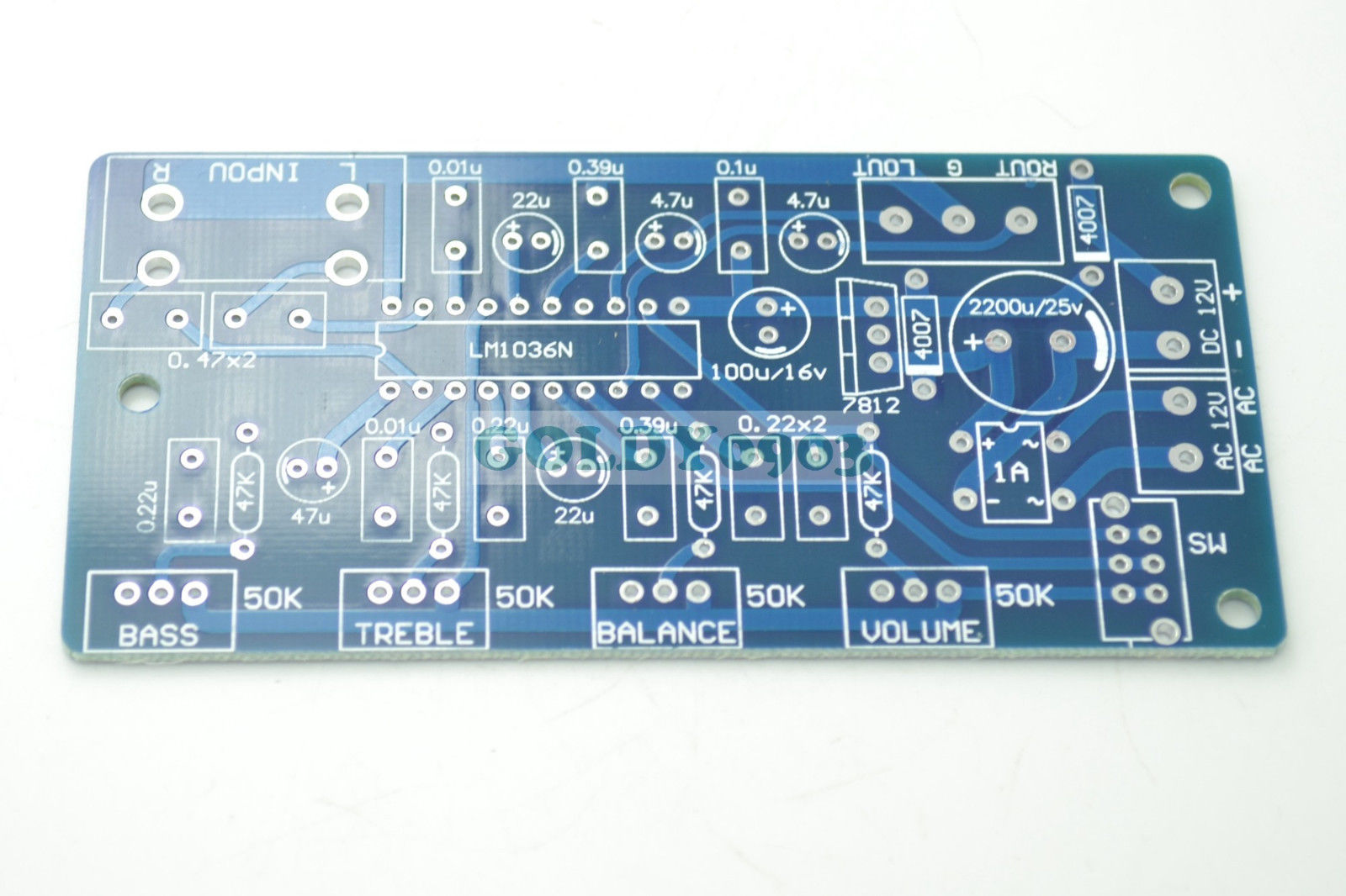

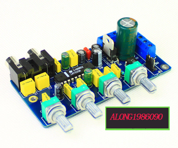

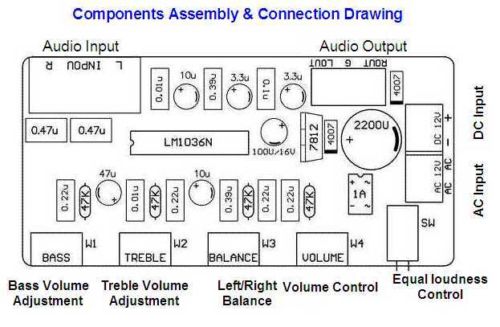

Later on today I bought a finished tone board with loudness based on LM1036N chip from TI.
I need to check tone caps quality on that board and maybe find if I can make variable loudness control on it...
Here are some photos and diagram, so if anyone can recognize what is there to tweak...

The caps look OK, typical polyester film types. The use of the loudness function (pin 7 of the chip) is detailed in the data sheets. You will have to see how your board is configured to know if its used or whether its left non-functional.
