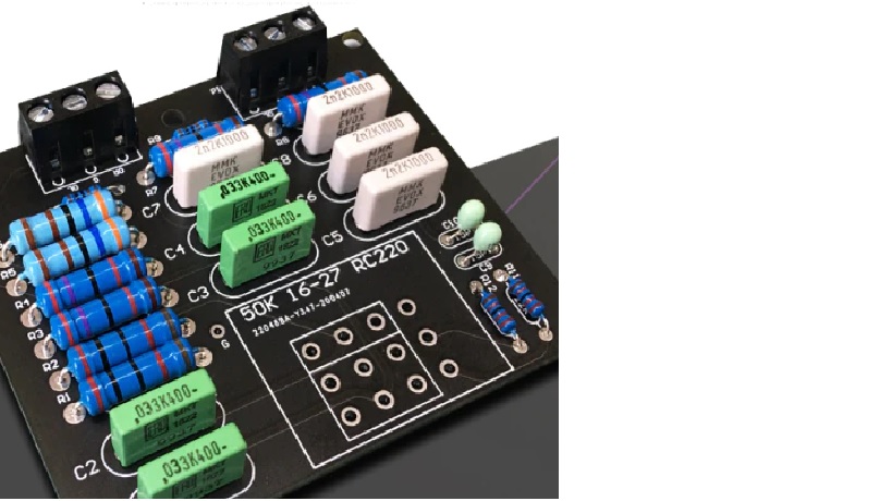

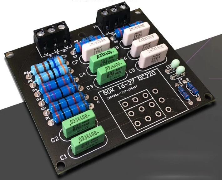

Here is a picture of the pcb. Interestingly, even though the same value 50k pot is used, different images show resistors of different values, if I saw it right.

a loudness PCB on which the capacitors (4 pieces of 2nF and 4 pieces of 0 .033 uF) and resistors were "calculated" for a 50k Ohm volume potentiometer.
POST-THE-SCHEMATIC 😉
You supply tons of not so useful data, such as brands / models / tubes / DACs , etc. but not the most important one.
Please do.
As a side note, not sure how a bare bones minimalistic Audio device such as a "passive preamp" ( a Pot in a box) mates with a Loudness circuit or any other added kludge, doesn´t that ruin the minimalistic Philosophy?

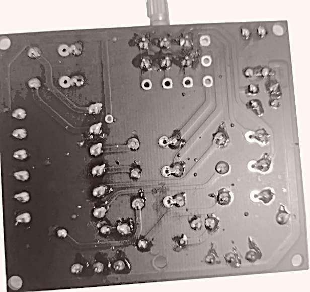

For the time being, instead of a schematic, I can only provide the following images, so far I know so much about switching.
