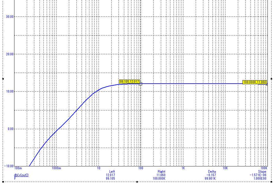

This is the circuit I have come up with after several audio trials. It only increases the bass frequency gain. The main advantage of the circuit is that it is incorporated in the feedback path of your actual pre-amp so no need for additional active circuit. It can also be bypassed using a switch between connections 1 and 3 when not needed so no feedback cap in the audio path. The pot is shown as R3+R9 = 20K (linear). R10 is optional and the value can be adjusted if the pot value you have in hands does not provide the required compensation. U1 is shown to represent the active portion of the pre-amp since my real pre-amp circuit use discrete parts and not op-amps.

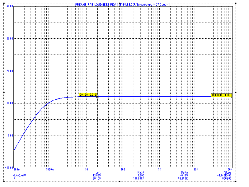

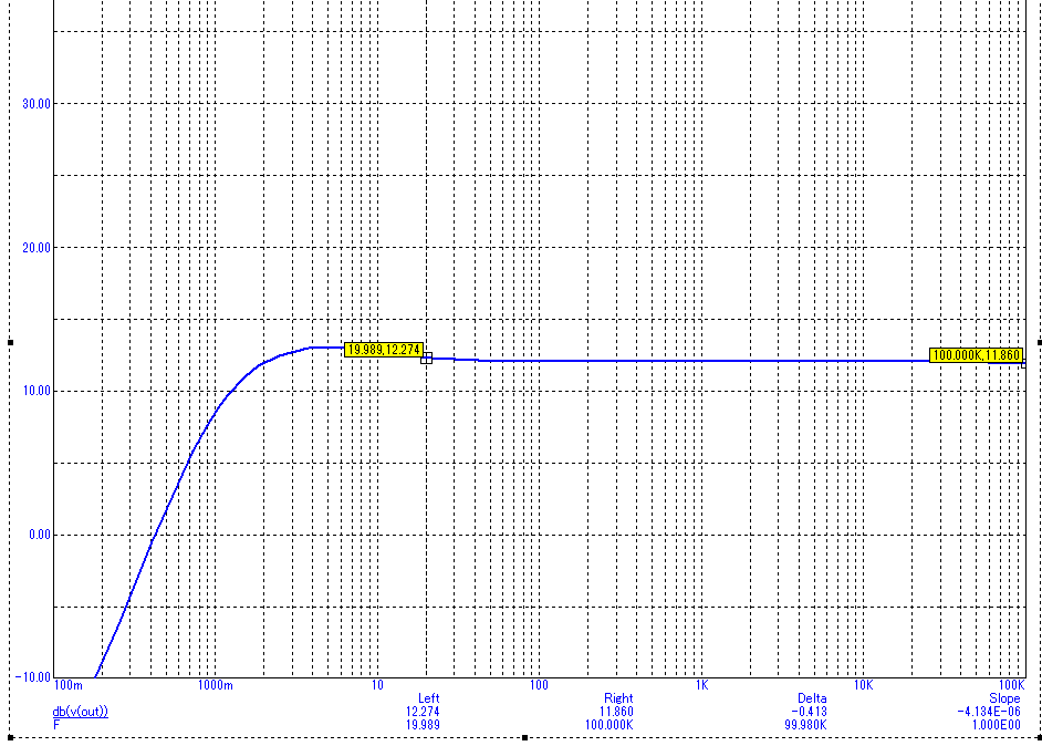

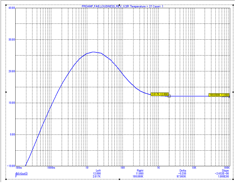

Hi
I have attached these graphs:
1) Max position of pot value
2) Min position of pot value
3) Bypass of the whole "Loudness" (bass only) circuit when not needed (between points 1 and 2)
4) Bypass of the "loudness" and the DC filter caps (when DC is not an issue)
Gain of pre-amp shown is about 12db.
It can be used with any opam such as NE5532, TL072, ...
The Loudness circuit is independent of the power supply voltage.
Thanks for your interest:)
Good luck
Fab
