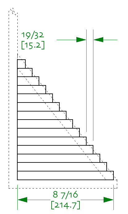

Quick question for Dave et al. If I were to use a stepped deflector at the base of my Coniston to add some additional mass, would it be possible to use MDF to construct this? (I vaguely remember the design sheet for a 'spawn' variant mentioning that you could use MDF for the stepped deflectors)
Ewan
Ewan
I don't think MDF would be a hardship in this application. The extra mass won't hurt. I would slice the top off with a standard angled deflector.
dave
dave
Thanks for the reply Dave. I have already decided on slicing the top of the cabinet and using the standard deflector to remove some of the mass from the top.
With regards to a stepped deflector is there a rule of thumb for the layout of the stepped deflector in a Coniston or is it a case of getting the steps to follow the front edge of the angled deflector as closely as possible? I know on the spawn family i.e G Chang the sheets mention that the 'steps' begin half a material thickness back from the front and then each subsequent step is a material thickness shorter.
Ewan
Ewan
Thanks for the image Dave, it should help me work out the dimensions of my deflector.
Ewan
Ewan
