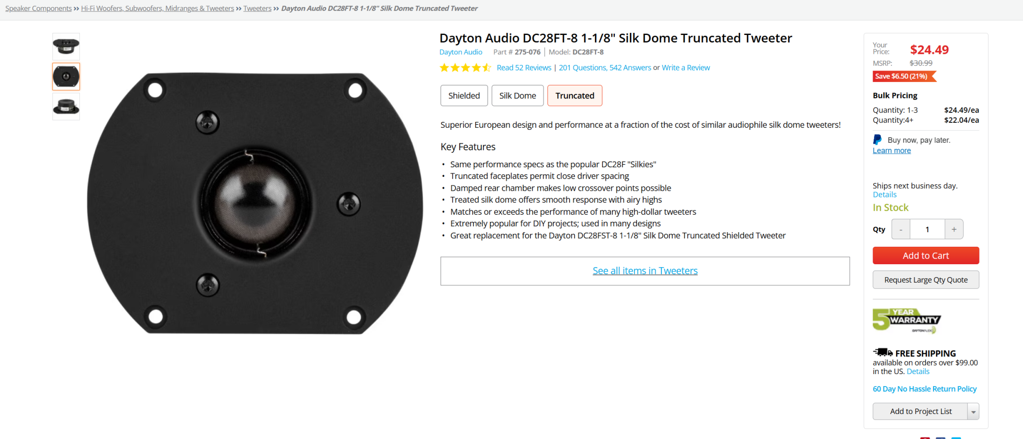

I prefer the Vifa's sound to the Dayton DC28F, although it won't cross as low as the Dayton, but your workshop guests won't spend hours trying to pick bits of fluff and mosquitos out of the sticky dome. Seriously, it sounds OK but is poor value here compared to the SB and Vifa competition.

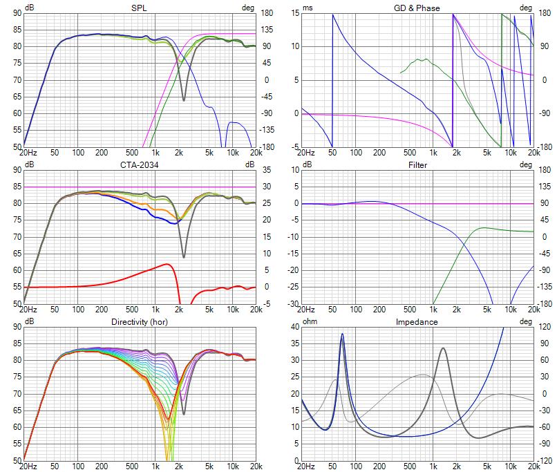

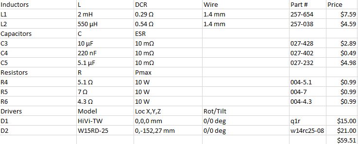

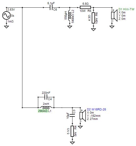

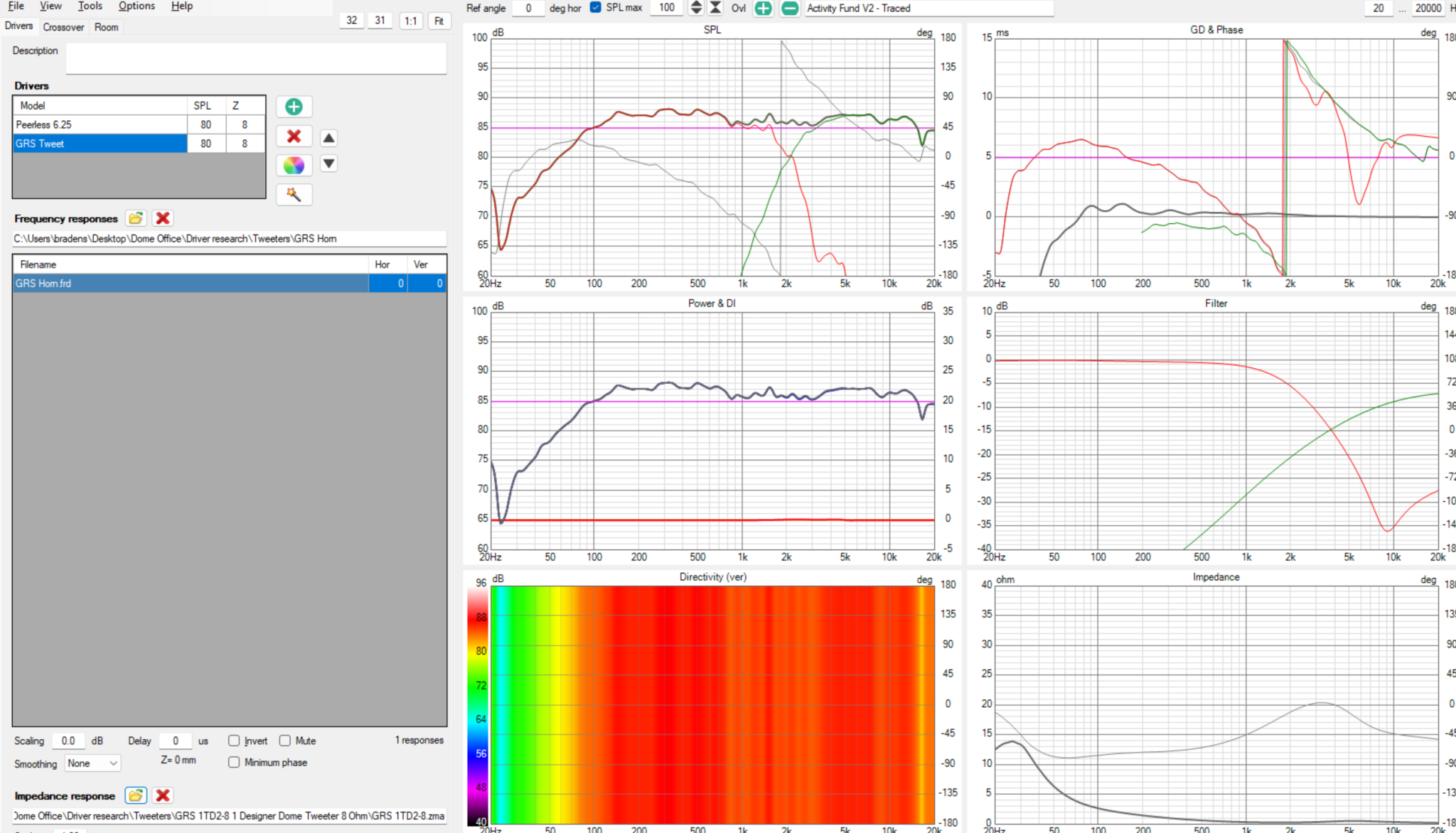

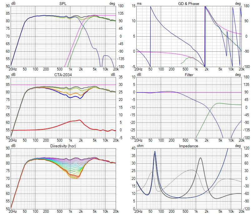

Here is the best I could come up with using your measurements for the Hivi and Silver Flute. I even put together a BoM. Just under $60.00 per side with quantity discounts.

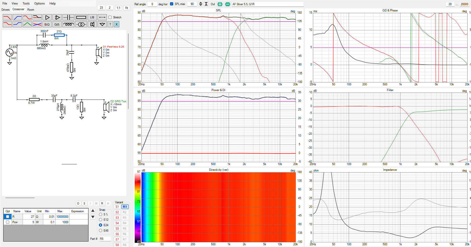

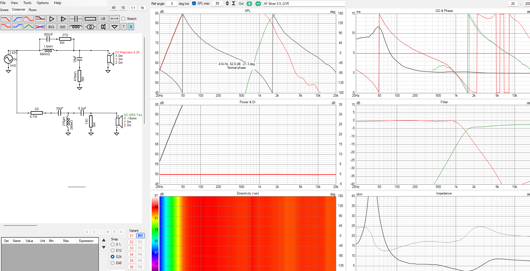

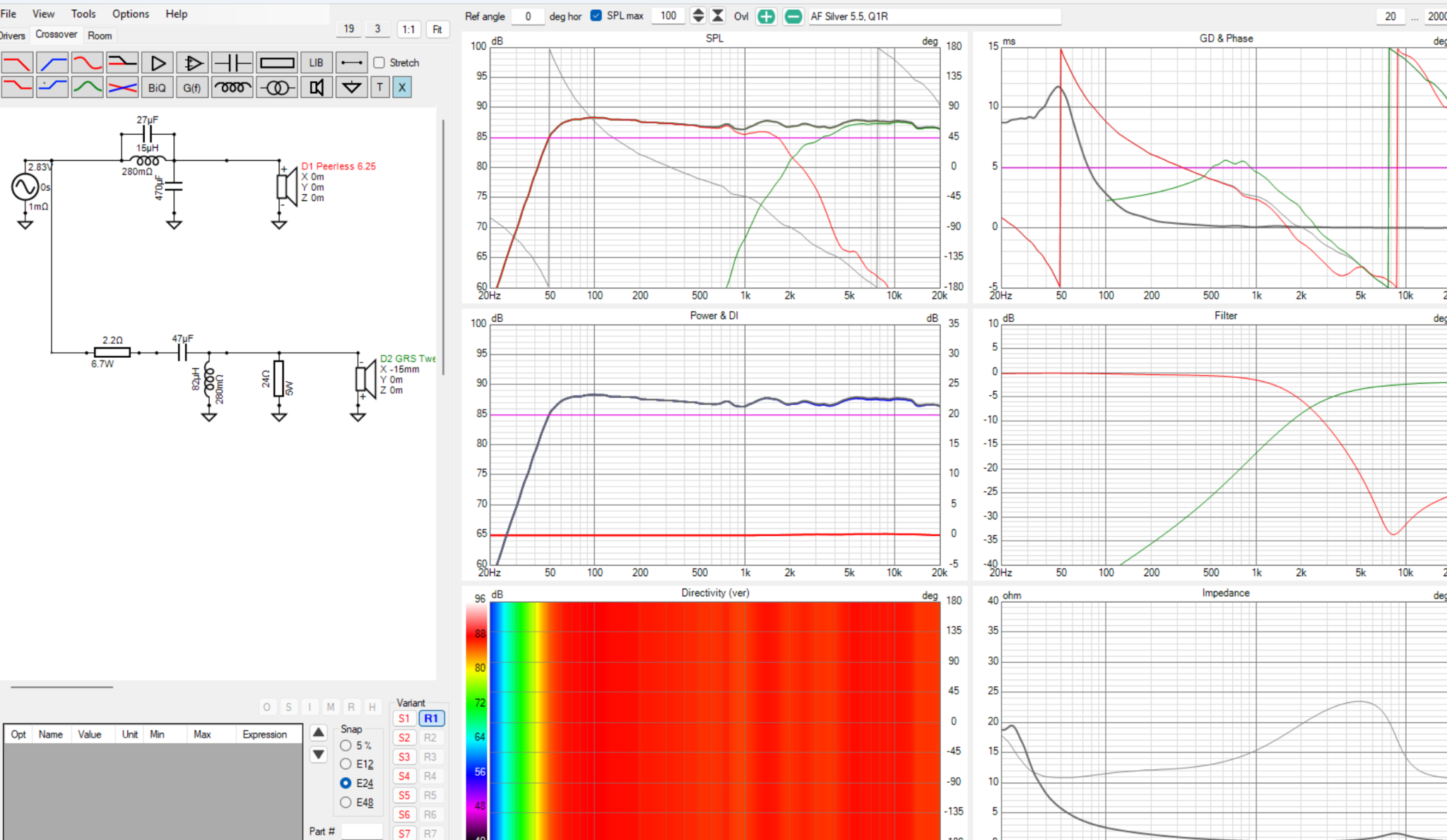

I think I should choose between one of these two setups

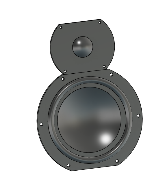

Silver Flute 5.5 X Hivi Q1R - $1372 for all 30 units

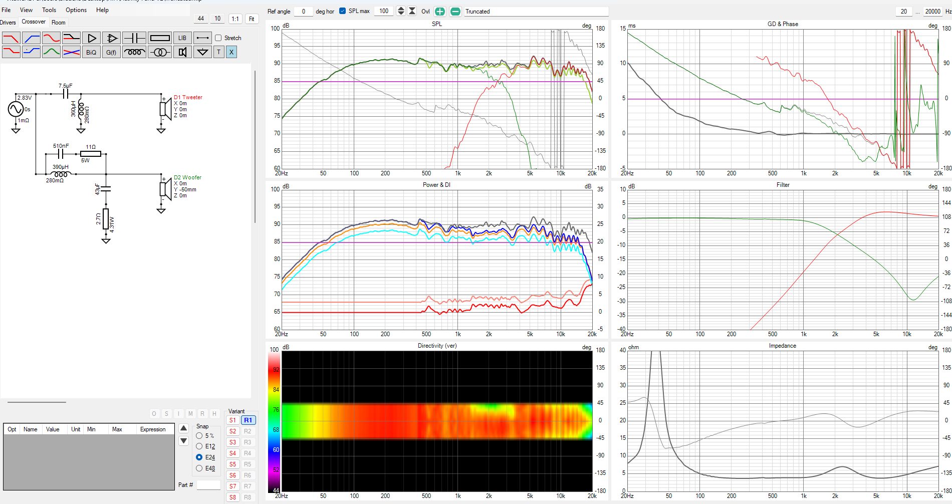

Dayton Trunc SIG180 x Dayton Silk Tweeter Trunc - $1650-1841 (higher number is using a little bit nicer XO components)
I'm thinking the truncated drivers is going to blow away the silver flute and the hivi

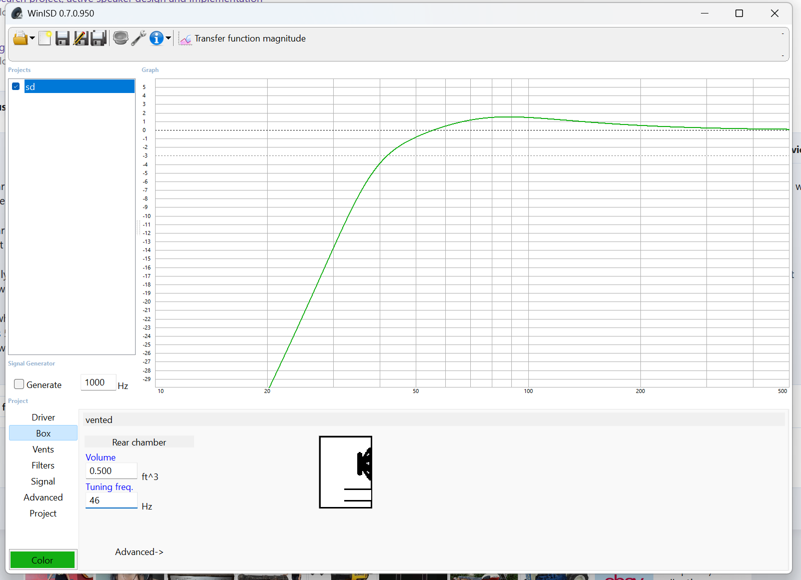

See what it takes to sim it at 86dB at 1k and above, and with a smooth transition below 1k to 200hz.. That would be closer to a real world filter. The woofer coil will be larger, and possibly more expensive. A couple more resistors will probably be needed.

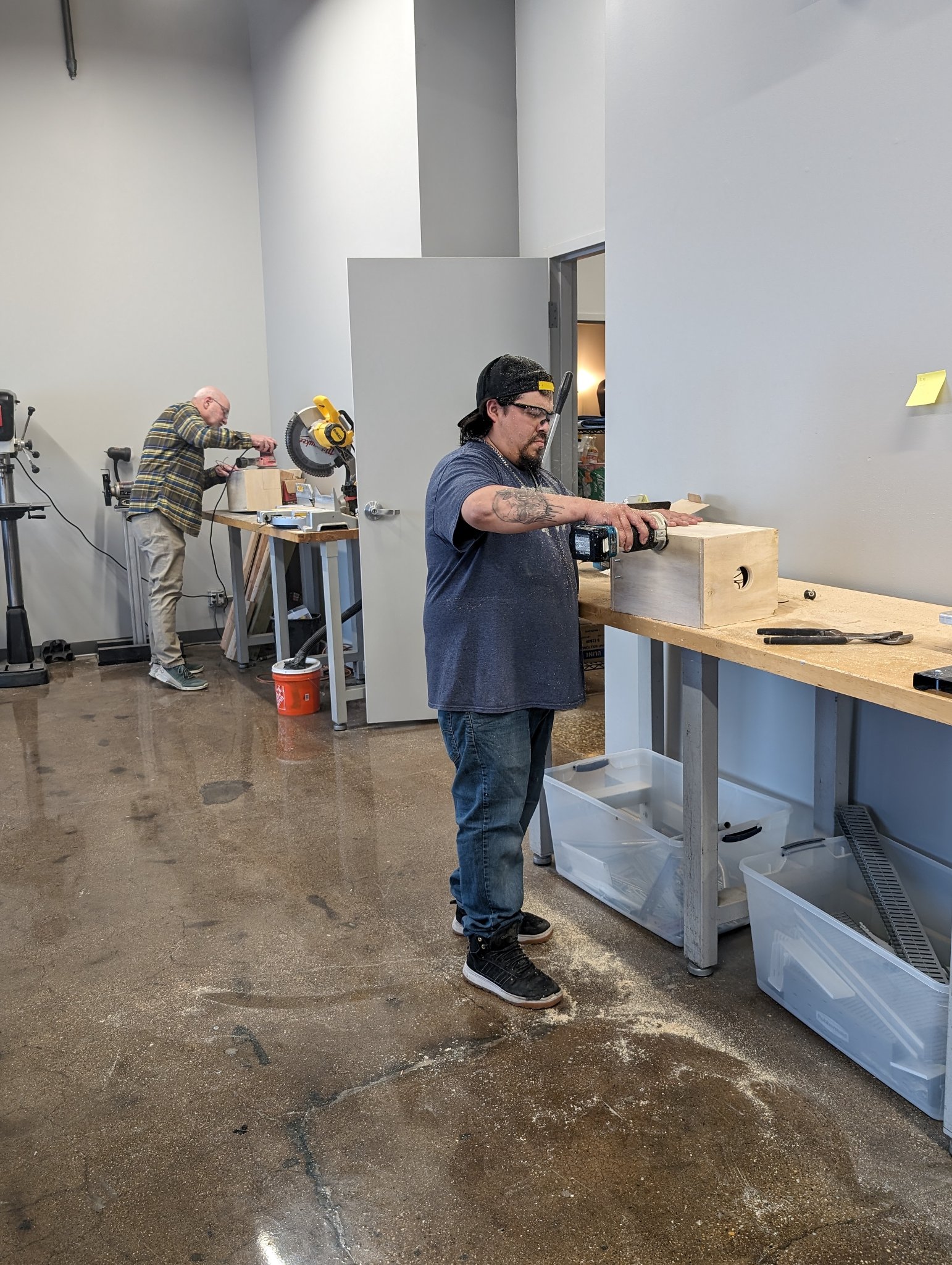

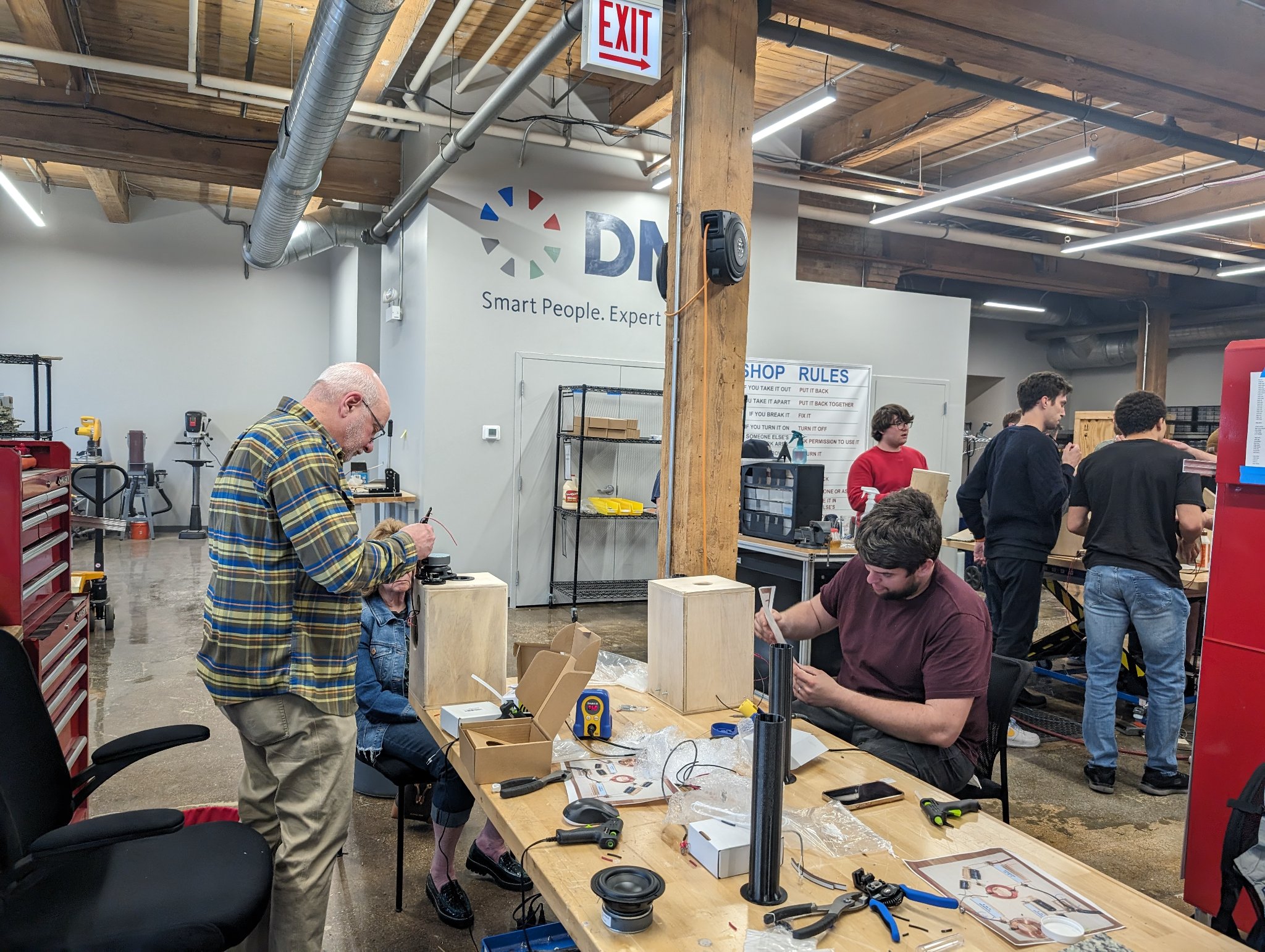

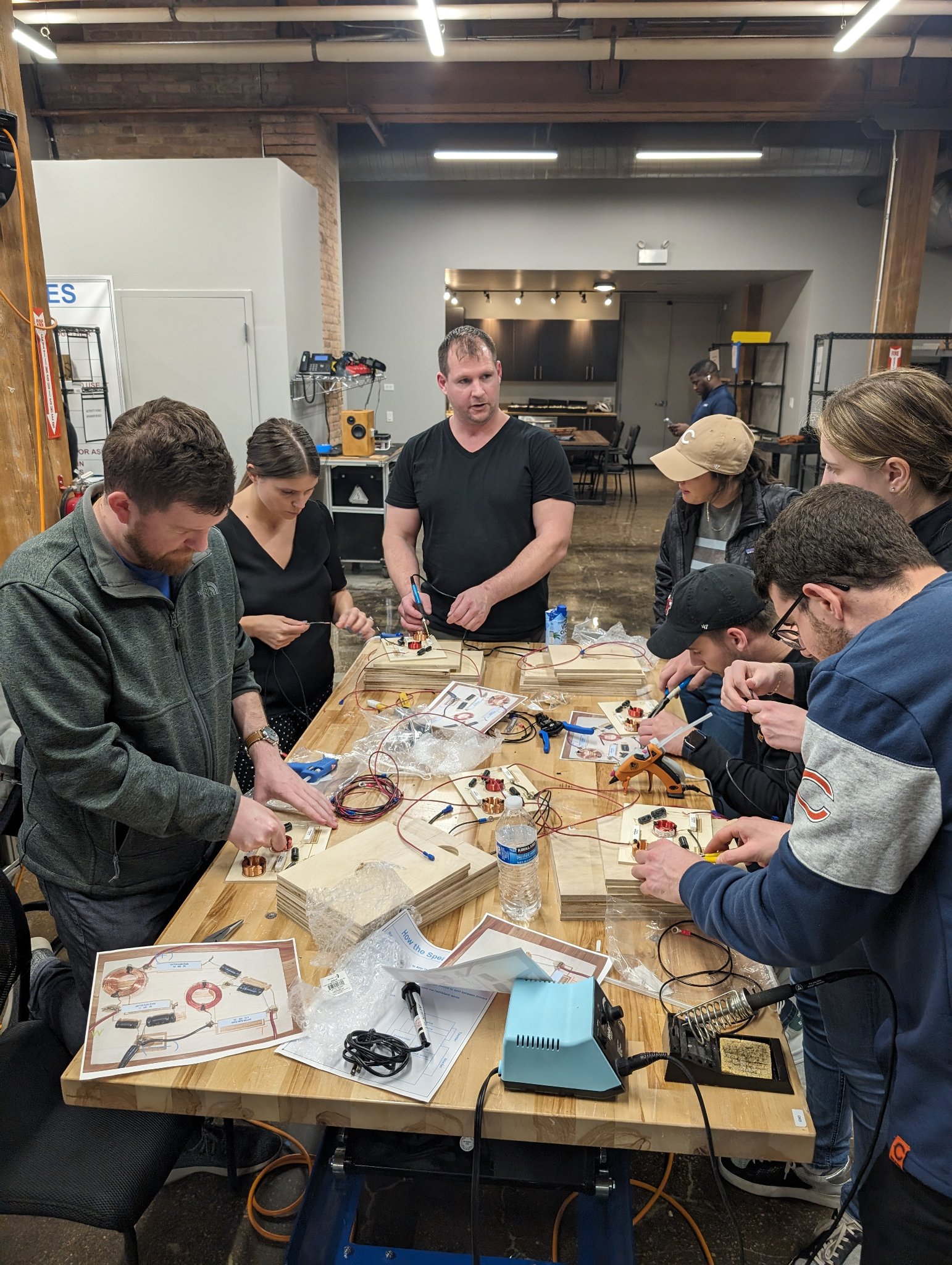

It's just me having 30 employees in the shop putting speakers together. It's fun for them since they don't manufacture stuff everyday. These are all engineering nerds. They love this kind of stuff for the same reasons I do.
Then they get to keep it.
I think if I spent more money I would include a cheap mono amplifier. That is what I did last year. That Amp ate up a lot of my budget. This year I want to make something nicer so they cna buy their own amplifier and choose how good of quality it is. Everyone here gets paid quite well. They can all afford an amplifier.
