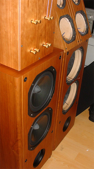

this is that boxes for the SV12 subs. each box is 30"W x 18"H x 24"D other subs are from my past so I dont have them for pics.
each box has 2 SV12s coupled to the rear wall XOed at 60Hz poweered by a Carver M1.0t.
full range are MTM using SS 8546 and 9900.

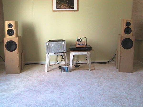

that is a nice settup man i like that im doing some thing like this ( found this photo on passdiy.com and have talked to the person too.. )
But ill be putting in 2 10" per box ( lower box that is ) and haveing the port out the rear.. and ill power all the 10 with 2 n-channels that i am working on ( one is compleet post pics later on in week..)
: O )
: O )

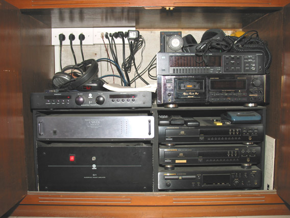

4. for acapella, acoustic and baroque music I actually do not turn my bass amp on at all! The signal thenis clean CD - simple preamp - power amp (no EQ, no processing).
the attached phot shows my home made pre amp and power amp. the boxes are from a local power supply company called Nova which I then screen printed.
the left side of the rack is the pre and power amps. the right side is fed via a regulated supply and is te CD players (63KI, Phonisophie, Marantz CD writer, Tape Deck - Pioneer CT93 and EQ for the bass)
