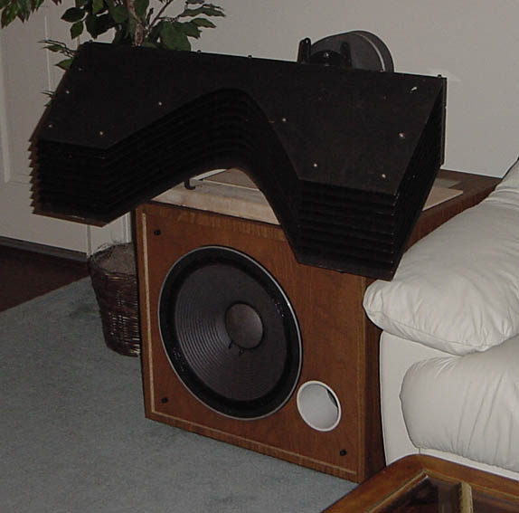

Below is a picture of one of my endtable subwoofers. They're 4.5cu.ft and the speakers are TAD 1601a's (about $500USD/pr. on eBay). They are tuned over damped with an electronic boost for a theoretical flat response to about 22Hz.
Enjoy🙂
