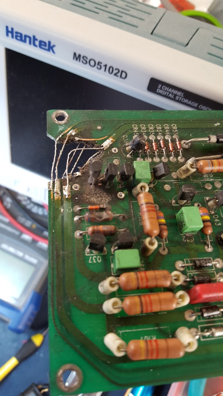

I adopted a ML332 that has some technical issues. The usual failures such as bad main caps are present. There is also evidence of some rather shady repair work on the right channel voltage gain board. Long story short that board has had a major failure and some traces on the edge of the board were disintegrated. Whoever attempted the repair did some real shady point to point soldering with un-insulated tinned wire. They also removed a chunk of the burned area with what appears to be needle nose pliers. Now there is a small jagged chunk of board missing. Not cool at all. The person who did this should be tarred and feathered.
So I am in the market for a replacement board. I am not concerned with the working condition of the replacement. I just would like a nice board to start with and I will troubleshoot the rest later.

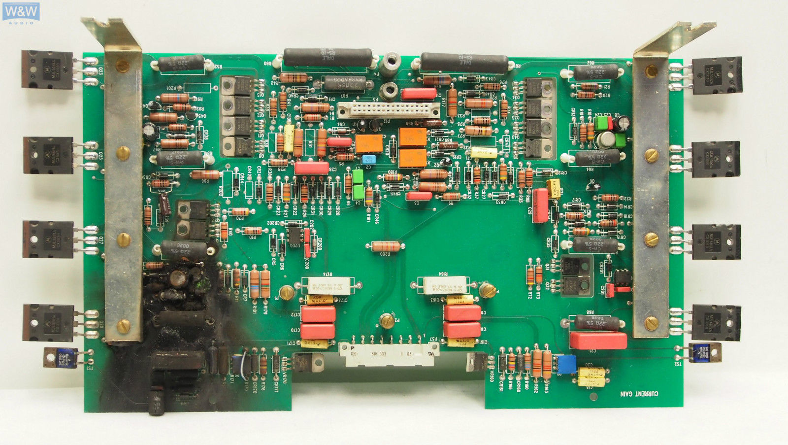

Henri did return my inquiry. He would not release the Gerber files to the public but also explained how he redrew them (probably in EagleCAD). I know how much that entails so I can't really be surprised that he is keeping them private. If the shoe was on the other foot I probably wouldn't let my work get passed around by strangers either. So I did not get the Gerber file but I got the next best thing. Henri pointed me to an ebay auction out of the Netherlands that had a pair of voltage gain boards. The bidding started at 75 euros and I placed my bid. The auction ended this morning at 7:30 am local time. I made sure I was sitting at my PC at 7:25. No bidders in sight until the last 30 seconds and I sniped it for @ 118.00 euros. So in a week or two I will have two fairly nice boards. I am grateful that Henri pointed them out as I would have never thought to look outside of the US with ebay.

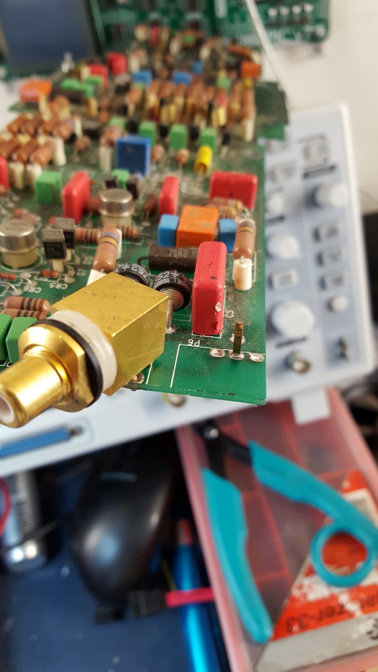

Okay, you asked so here it goes. I bought the amp as a non-working but complete specimen at a fairly cheap price. I will withhold the name of the retailer and the specifics of the deal as they have since refunded a chunk of money and swear they did not know it was like that. I am claiming a monkey could smell what went down in there. They told me they took it in as trade on a Krell.
I went in expecting at minimum some blown transistors and a full re-cap. I did not want a working amp. I wanted an amp that I could bring back to spec and grant it a second life for many years to come. When I took the top cover off I found the following:
The first picture is beyond words. To begin it is a pure hazard. Second there are missing supporting components (resistors and some melted components) that were not replaced. How they expected this to work is beyond me. The second picture shows how the "tech" did not know how to properly remove an XLR connector shell so he/she just cut the leads. Furthermore the four ground pins on the RCA block are snapped at the board. No amp should be subject to this level of stupid. I would rather see it crushed at the recycle center.

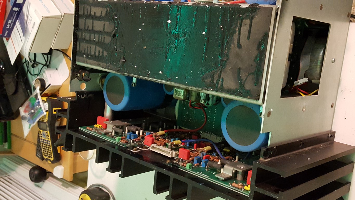

So we all know an amp of this age will have bad caps. I saw it the minute I opened the case. The black ooze that so many ML owners have seen. From what I can tell the amp was stored on its side. The ooze made its way to the top of the amp which does not really make sense. I was spared from having to clean a lot of ooze from the PCB's. Most of it went toward the back panel.New Cornell Dublier caps are on order from Mouser.

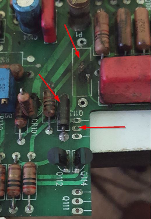

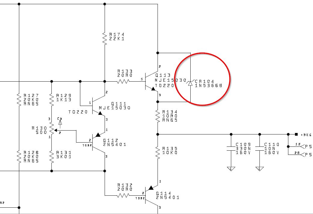

The right channel current gain board has some visible issues. One resistor has over heated and looks like a crisp. I took if out and it still measured the correct ohms. That puppy had a long slow cook. We all know resistors do not spontaneously combust so I begin to look for bad neighbors. Following the traces I see Q113 is next in line. I remove it and it tests good. Hmm. I impulsively pull Q111 and it also tests good. Then I glance at the schematics and I see what appears to be a snubbing zener diode across Q113. It reads current flow in both directions so I guess it is bad and would make Q113 appear to be failed in a shorted condition and that in turn would get the resistors very mad.
I will have to repair the small burn mark area. I have ordered the diode and resistor and am keeping my fingers crossed 🙂
If there are any folks familiar with this board then I invite discussion about things to look out for and other potential failures.

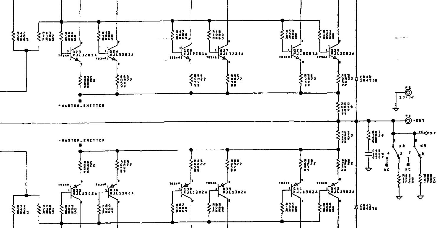

I received the pair of voltage gain boards that I won on ebay. I swear these boards look like they have never been installed in equipment. They were in the original ESD bags with the ML part descriptor label on them. I also installed the blown zener, resistor and output transistor from the right side current gain board. Installed new main caps and now installed bus bars etc to get all caps ready to charge. No heat sinks are mounted. I am doing this because I want to replace other smaller electrolytic caps but I don't want to order those until I am sure I have an amp that is breathing. From what I read in the user manual this amp does not have Class A biasing on the final output stage but has Class A biasing on the stages prior. I cannot run the amp for long without heatsinks for sure.
This time when I first power up with the Variac dialed up to 78 volts the poor variac lets out a loud hum when I press the power button on the amp. I was expecting the initial charge of these four huge 50000 uf caps to be a burden on the variac but I couldnt be sure if it was the caps charging or an actual short loading the variac like that. I cycled the variac on and off a few times to keep the small fuse in it from popping. By the 3rd or 4th time the variac began to quiet down as the caps found a little equilibrium. Both LED'S on the soft start board are now lit and the front panel LED is blinking at 1hz. Good sign! I push the amp from standby (1hz blink) to ON (solid). I hear a flurry of about 7 to 8 tiny signal relays quickly come on in succession. Voila!, the main LED is solid and the amp appears to be keeping all magic smoke within the semiconductors. There are NO output stages mounted though so I am not out of the woods. The other Class-A biased stages are beginning to get warm so I shut the amp down gracefully. I am not touching anything in this amp with bare hands. The power supply sections on this beast demands respect. It can send you to the ER quickly. By putting my finger near the smaller T02 transistors metal tab I can feel the warmth beginning build up.
So ultimately here is where I need advice. The final output T03 transistors (24 in total) are out of the picture. I don't want to solder them all in only to find out something else is wrong and then have to unsolder them again. Each channel has 12 T03's. Can I leave 10 of these out of the circuit without fear of damaging anything? I am not going to drive a complex load; maybe just a small bookshelf speaker for testing. I have attached a diagram of how the T03's are configured.
Thanks!
