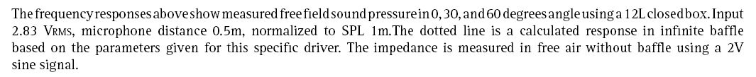

Why do so many SEAS cones show that weird ragged response,
raised by 3-5dB, from around 400Hz to 1200Hz?
Below each response picture, there is a note, this one for ER 18 RNX.
So the response is fairly flat if you stick it on an infinite baffle and listen at a 60deg angle.
At a lesser angle the response still rises by 5dB from 500Hz.
Btw BMS also measure their drivers in a box (11L for the 6S117 & 5S117) without the hash. Although they measure at 100W input rather than 1W.
You can see the baffle step pressure build up on BMS curves
too. Personally, I don't like the way Seas plots driver response.
They don't say what the baffle measures are, where on the
baffle was the driver installed, were the edges treated.

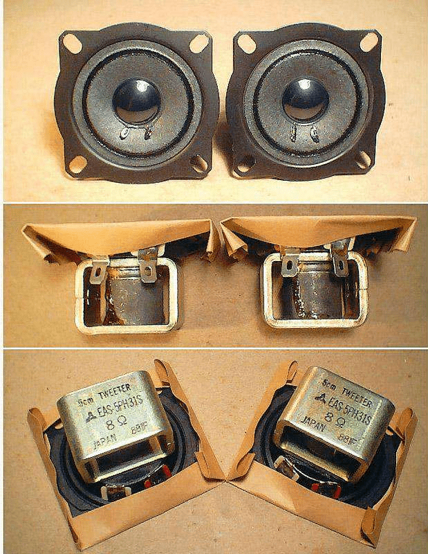

I'd say the vintage paper cone tweeter is a LOT better sounding, if rolled off in the highs.
So what else to try that does NOT sound like the Morel?
I like the sound of the paper cone but need more extension.
