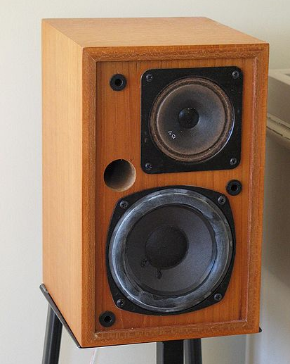

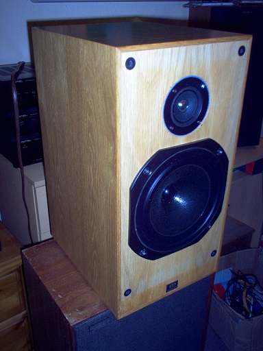

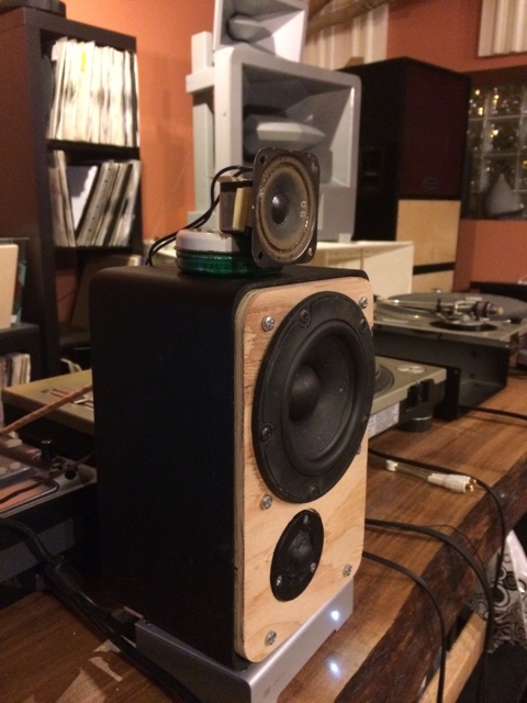

I am glad you are getting my unscientific, subjective but real point. In a lack of ring radiator tweeters I have temporarily (maybe not) settled on a paper cone mcintosh tweeter. After this tweeter my morel cat378 needs to be thrown in the trash. I hear you system7!
ps: notice the burned vifa tweeter at the bottom of the cabinet. I am glad that thing burned. At least got some function out of it.

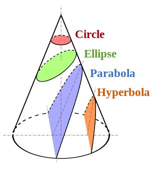

I don't look at frequency response so much these days. I get more interested in geometry. :cool:

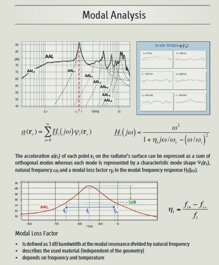

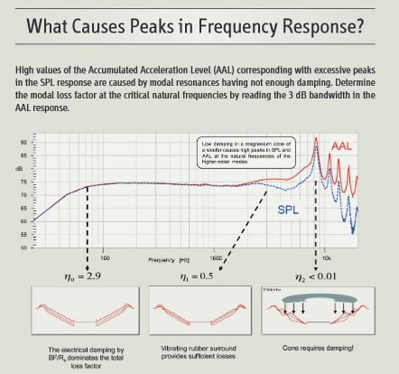

But what is a good driver? Often just a sweet compromise of all the interrelated variables. The below is some Klippel Literature and some real world drivers.
Breakup and Surround issues with cones, for instance. IMO, it's mostly in the geometry and the material chosen. I'd like to see some Klippel analysis of tweeters.

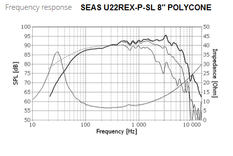

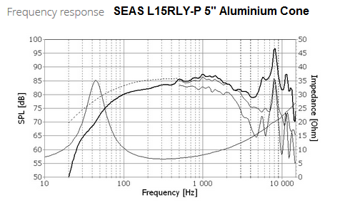

Why do so many SEAS cones show that weird ragged response, raised by 3-5dB, from around 400Hz to 1200Hz?
It is more pronounced with their metal cones but still visible with poly and paper ones.
I believe SEAS do their anechoic measurements in some fairly typical boxes, rather than infinite baffle or a standard IEE baffle.
IIRC, they use about 11L closed for 5" drivers, 25L closed for 8" drivers, etc. So what you might be seeing is a baffle effect.
