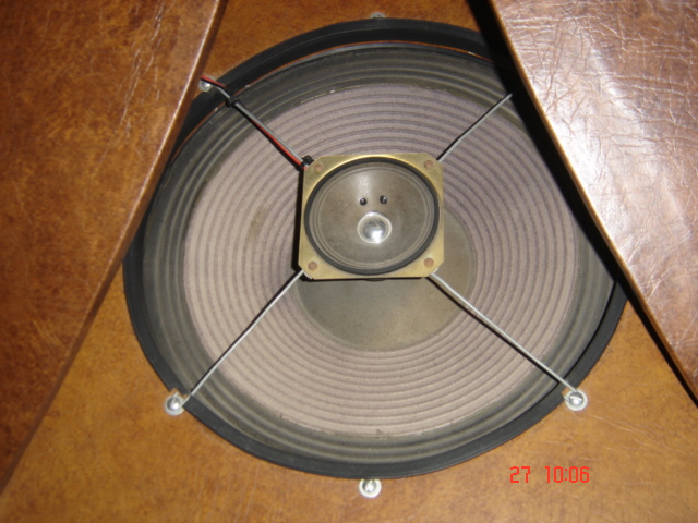

Osvaldo, have you ever measured what happens to the FR if you put a tweeter in front of a woofer like that? It is not nice.
What happens?
ME Geithain are doing precisely that very successfully.

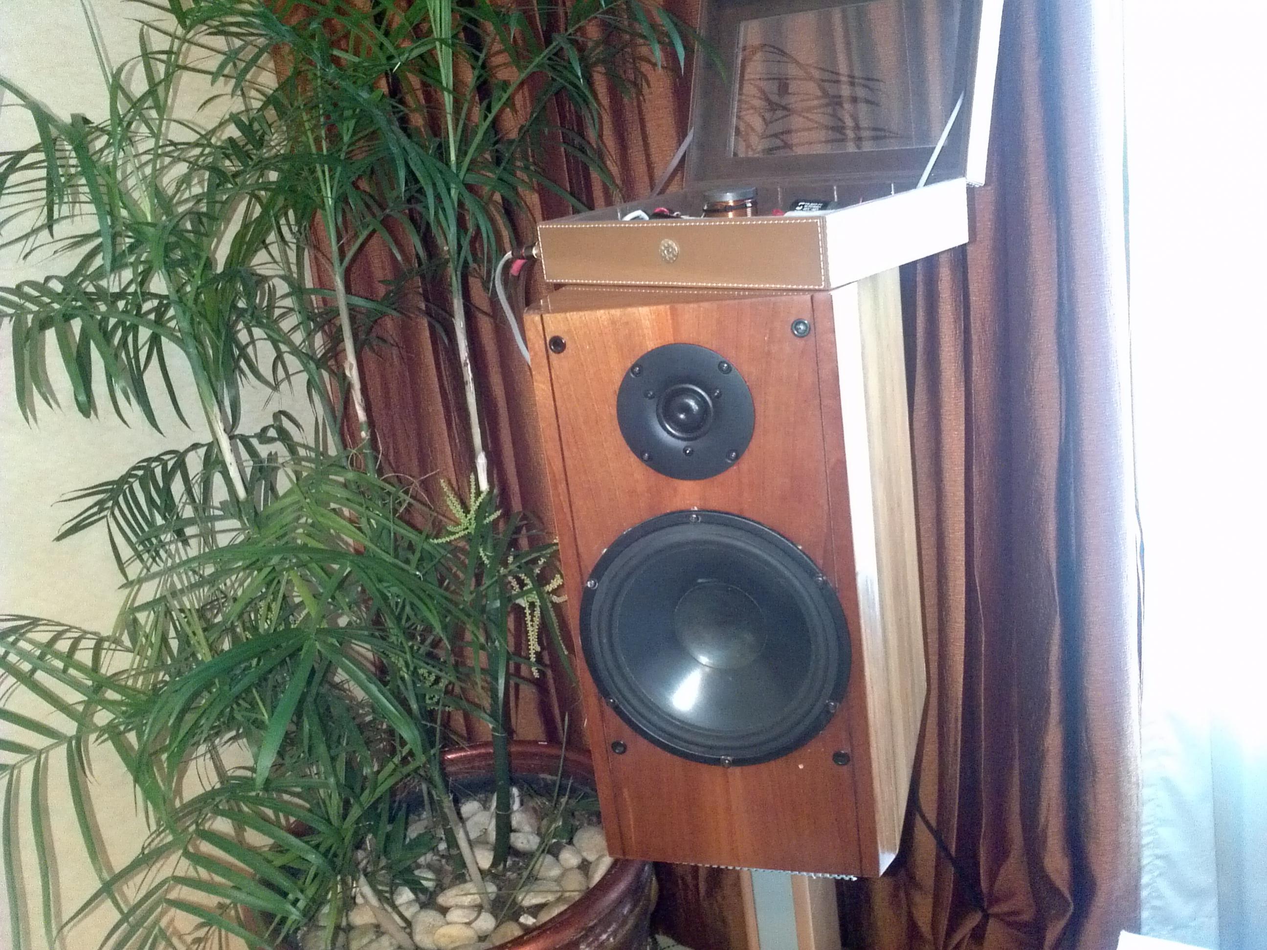

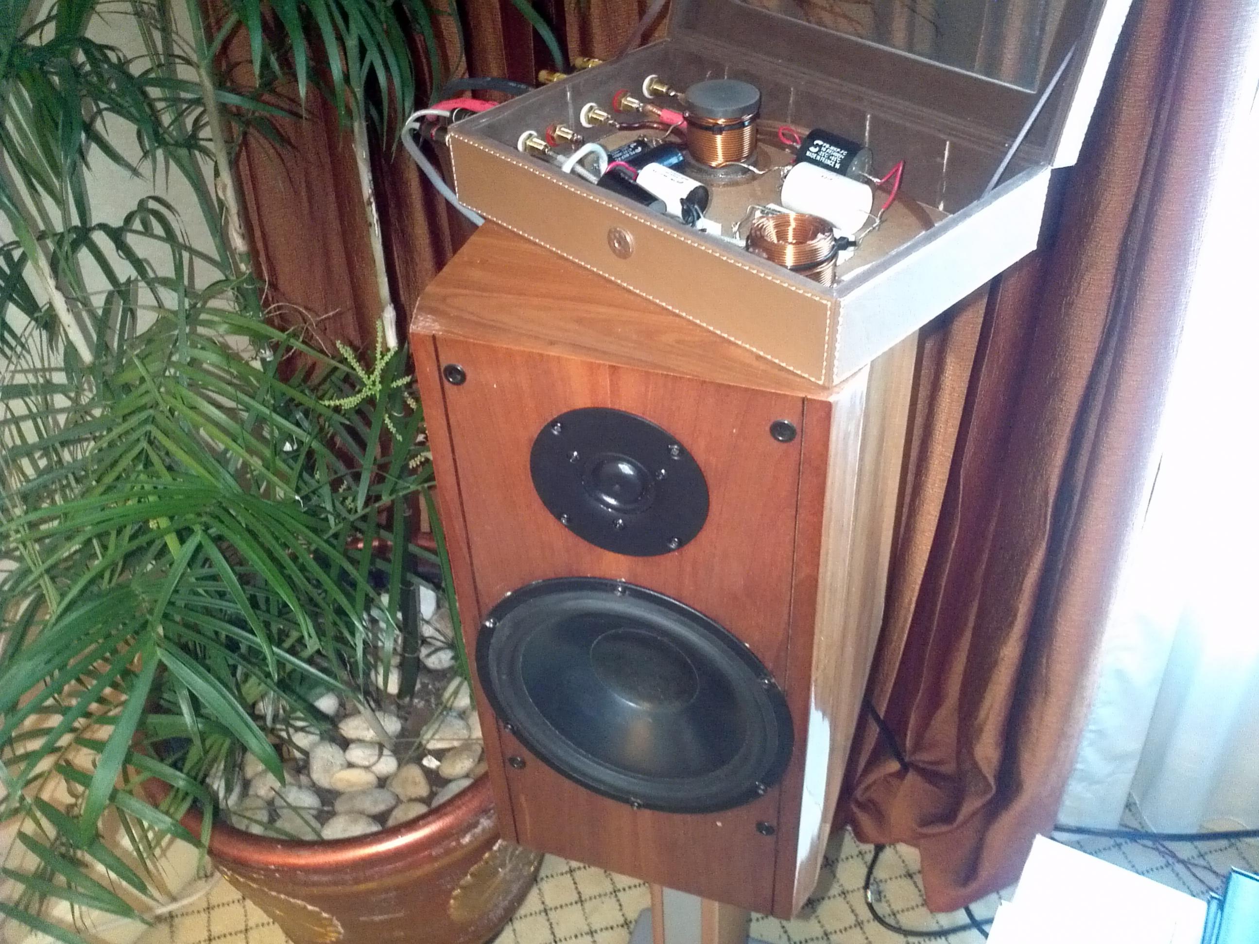

Hey, that's cool. Did you put the crossovers outside the cabinets? Does it have any impact on the sound to put the crossovers inside the cabs? Like, is there an advantage to put them outside? By the way, that looks like a cigar box.
Hi fake out,
yes the crossovers on all my speakers have external crossovers. As a novice without any measuring equipment, I am constantly adjusting the crossovers.(I suffer from itchy finger syndrome).
I got tired of constantly removing drivers to TWEAK the crossover so all I need do now is open up the case and add or remove the components fairly quickly.
They are actually leather bound jewelry boxes I picked up locally here in Surabaya.
Makes it damn easy now to satisfy those itchy finger moments
As for affecting the sound I can't tell you scientifically but I would guess that removing copper from behind a woofers magnet would probably have small affect. Plus it just looks bloody nice with a glass panel so you can see into the crossover....
As long as the cross-over frequency between woofer and tweeter is not more than about 2 kHz, and the listener is not closer than 2 meters to the speaker system, diffraction of the woofer's sound wave by the tweeter should be not noticeable at all. At 2 m or more, the woofer's sound wave has completely filled in behind the tweeter.
Wavelength corresponding to 1 kHz frequency equals about 33 cm or 13 inches. So wavelength of sounds from the woofer is at least twice the diameter of the tweeter.
Is there something else that I'm missing that would affect the sound quality?
