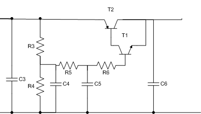

Hearinspace said:
This is all coming out of Rod Coleman's filament supply and it has me interested in learning more about Gyrators in general. On a search I did a while back I found a couple of older articles that put the capacitance multiplier in the Gyrator category - but as the Gyrator is called an impedance inverter (ie. use C as L or L as C) I think that might be argued. Anyway, the whole thing's is fascinating and I'd like to learn more. . . .
The article you quote is a capacitance multiplier used to smooth the heater voltage.
EDIT Poor example using FET......(see :- http://www.pinkfishmedia.net/forum/showthread.php?t=39990 )
If you redraw the circuit, you will see the similarity.
I think he calls it a "choke" as it is dealing with a constant current heater rather than a "capacitor" which would imply voltage.
Andy
Edit ... pic added

Wandering into the world of transistors by way of interest in gyrators for tube filament supplies I tried the circuit that Andy posted the link to. I used an MJE15030 with the rest as spec'd but with a 100K adjustable replacing one of the 18K resistors and 47uF for the cap. The original article by Strict says this gyrator can be used as a filter choke in a power supply but with the values shown it hardly allows any DC though , and that with a lot of Voltage across it.
I tried the pot in both the Base/Emitter and Base/Collector positions. With the pot connected base to collector and adjusted to something around 100 Ohms I got the 120mA I was originally thinking to use the circuit for.
It leaves me wondering what the author was thinking when he published this. (This is not a criticism, I would really just like to understand the idea better.) In the original drawing he says that the max AC noise the circuit can deal with is determined by the voltage across the transistor which itself is set by the ratio of R1 to R2. But starting out with 18K R values that allow only 0.1mA with Vce = 5VDC+ (1.6mA at 30VDC) and calling it a filter choke substitute doesn't make sense to me.
The other thing not mentioned in the article is why he chose 47 Ohms as the value for R3 - something I'd also like to understand. This also has bearing on the value for C1 and it's equivalent L value no? Can anybody enlighten me here?
Thanks for any light you can spare!

This sort of circuit is often called a gyrator, but it isn't really a gyrator. A gyrator has the property that if you connect a capacitor at its output port, you will see an inductance at its input port, or if you connect an inductor at its output port, you will see capacitance at its input port. The circuit you're using is more properly called an inductor simulator. If you replace the capacitor with an inductor, the circuit won't simulate a capacitor, which it must do if it's really a gyrator.
Furthermore, this circuit isn't a very good inductor simulator. If it were, its impedance should increase indefinitely as the frequency increases. Analysis of the circuit with typical parameters used for the transistor, and a microfarad or so for the capacitor, shows that the impedance reaches a maximum of about 17000 ohms somewhat below 100 kHz. For rejecting high frequencies you'd be better off with a real inductor.
Consider just what the impedance of a 1 henry inductor is at 60 Hz; it's only 377 ohms. Yet the transistor, if properly biased in a suitable circuit should be able to present a series impedance of 10s of thousands of ohms at 60 Hz. Instead of using the transistor to simulate an inductor, it would be better to simulate a current source.
The analysis showed that the 18k resistor from collector to base is responsible for the fact that the impedance doesn't continue to increase as the frequency is raised much above the audio band. Some other method of biasing the transistor that doesn't bypass the inherent high collector impedance would need to be used.
I suspect that more than a single transistor is needed.
To The Electrician,
Thank you very much for taking the time to model the circuit and tell us what you found. It's very helpful. I especially appreciate that you put it in terms that I can readily assimilate at my level. A very good teacher I'll wager.
As I mentioned, this study is being fueled by my current interest in filament supplies for directly heated tubes , inspired by Rod Coleman's really good sounding design.
Your statement , "A gyrator has the property that if you connect a capacitor at its output port, you will see an inductance at its input port, or if you connect an inductor at its output port, you will see capacitance at its input port." has me wondering what is what in the Gyrator section of Rod's schematic. I also wonder how to figure out the impedance seen by the filament. Looking back into the emitter on the NPN , isn't it fairly low?
Also , until planet10's mention of it , I'd missed your post on the Tellegen .pdf . I very much appreciate your offer but I am not yet able to translate complex theoretical math into design and component choices so if his paper is more than 50% equations it's not likely I'd be able to make good use of it.
Thanks again!
Hearinspace said:
...has me wondering what is what in the Gyrator section of Rod's schematic. I also wonder how to figure out the impedance seen by the filament. Looking back into the emitter on the NPN , isn't it fairly low?
Thanks again!
In post #13 of this thread, Poynton says that the part of the circuit labeled gyrator is really a capacitance multiplier. I agree, and I would think the impedance looking into the emitter of T1 (also the collector of Q1) is very low. However, Coleman says that he considered using a current source at both filament terminals, but that the configuration he shows gave better performance. I'm not sure why that would be, but I can't dispute his findings.
But, the T1/Q1 combo isn't a gyrator as I understand the term. A gyrator should have a high impedance at its output terminal, increasing with increasing frequency, and this circuit appears to have a low impedance. I'll see about some analysis when the ice storm we're about to have here in the PNW is over.
