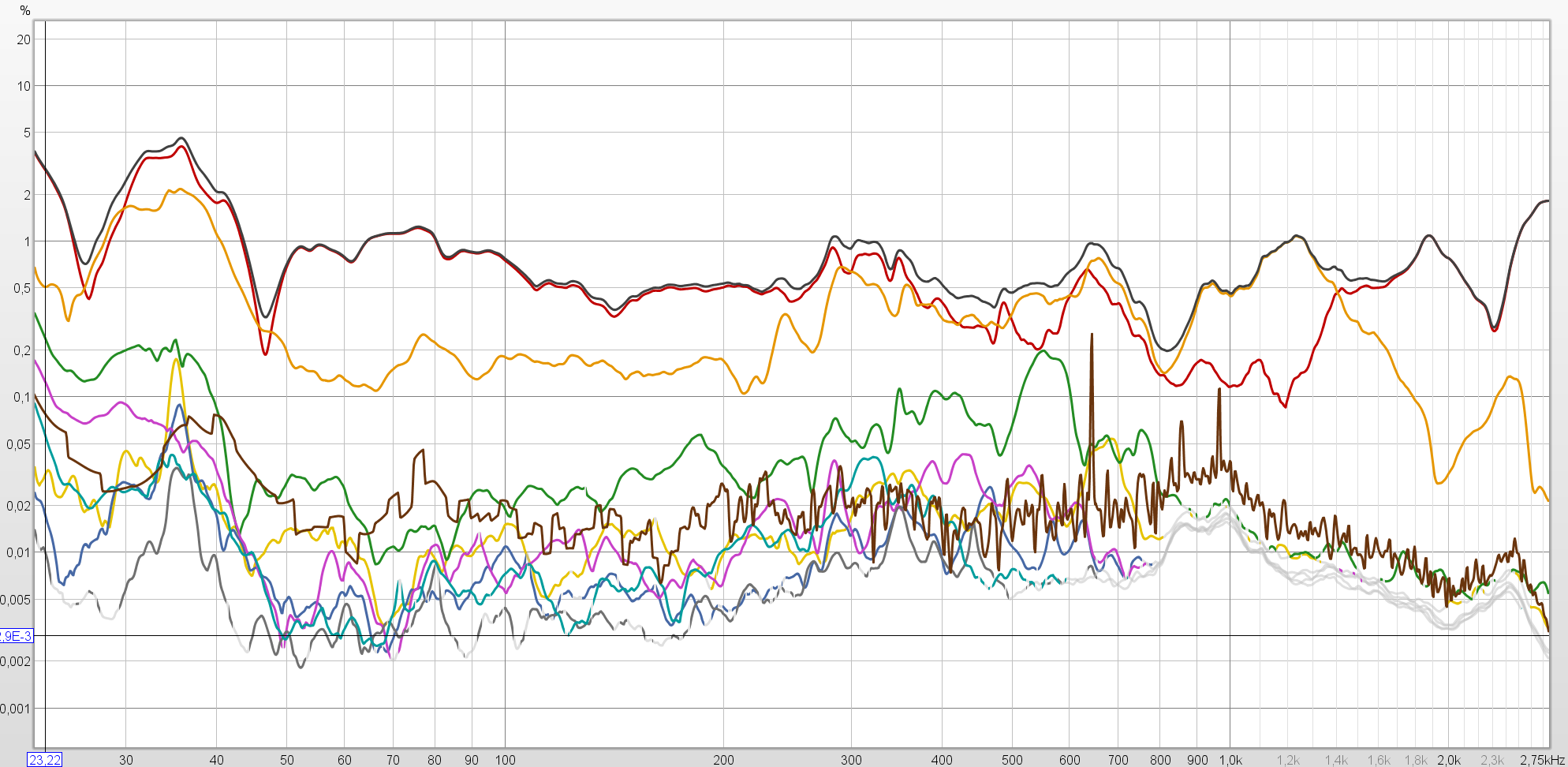

Ok, back to the topic. While measuring the woofers, I’ve learned more all the time and noticed that the distortion results are vastly different depending how much dampening material is inside and outside the enclosure, in the room right next to the enclosure and all around it, including the floor area between the microphone and the speaker.
And the required amounts are not small. I first put half a cubic meter of construction insulation wool right next to the enclosure, it helped a lot, the distortion was reduced. Then 1 cubic meter, still much better, eventually ending up with 2 m3 covering all sides.
I noticed an identical problem with the enclosure, if the enclosure is too small or if there are internal walls within 5 cm of the driver, the distortion goes up on some areas. Also if the enclosure is not fully filled, it’s also a problem, even if the enclosure dimensions and shapes are made so that the internal standing waves are low.
I don’t think most of the people who measure these at home know this, I certainly didn’t before. Meaning, different woofer distortion measurements over the net made in different conditions are not comparable at all. Even here in my case, the TD12X will show some a bit different results now that I have yet increased the amount of wool in the vicinity of the enclosure plus changed the enclosure to a different one completely.
This is why I measured the Acoustic Elegance TD12X again (the winner of the previous round) against the two new ones so that the conditions are identical for all three and the best one can be found without confusion.
Lastly, like I have said before, the db levels over the frequency band must always be equalized before the measurement. If the one driver is less sensitive than others, then of course in real life you need to turn it louder to compensate, again increasing the distortion.

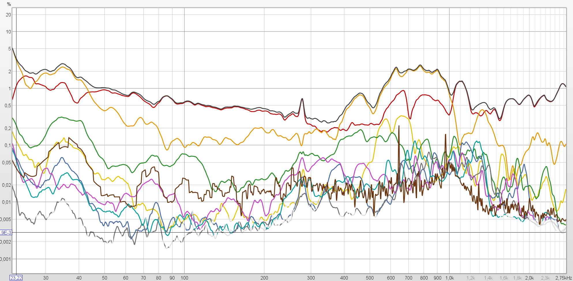

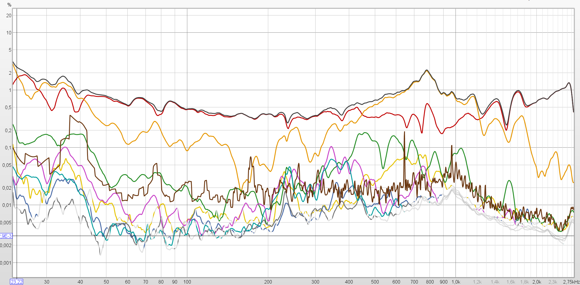

The second round results are measured at the same level as last time, a bit over 100db. For this round, I also modified and remeasured the 18sound by coating the backside of it's cone with self made 'anti resonant paste', because I wanted to see if I can make it sound more neutral on the low mid range area which is very pronounced. It really helped only little bit, flattening the frequency response slightly and reducing the overall distortion about 15% which is not much when you compare how much is still behind AE. But, it was a fun experiment and the sound did improve a tad, so not bad.
Oberton 12NSW600 8ohm
18sound_12NTLW3500 (diy coated cone) 8 ohm
Acoustic Elegance TD12X Apollo option 8ohm
BMS 12N630 8 ohm

After this measurement it became clear that for my application, the Acoustic Elegance has the lowest distortion, if you look at the 3rd harmonic (yellow line) on my 50-150 hz target area.
From all the drivers I measured, Oberton is the second best and it's a great option for people who are budget minded, live in Europe but still want to have a good sound. Like I said earlier it has an almost identical frequency response to the AE and it's quite flat.
Oberton also actually had the same or slightly lower 2nd order (red line) distortion at 50 - 200 hz than AE.
In free air Oberton also does not bottom out, I tried. AE does like most drivers do, so it's not a woofer for careless people. Oberton also has a bigger voice coil and judging by the extra sounds that come from the back of it, it probably has some kind of forced cooling so there is less power compression when played all day at the max volume compared to AE. It seems it can take quite a punishment. But not as much as the 18 Sound with it's four big voice coils, that is the number one power handling monster!
Bad side with the 18sound is that the frequency response shoots up above 200hz so it needs some EQ to reduce the levels there to sound good.
AE voice coil is quite small in diameter compared to others, but they have, according to the manufacturer used a very high temperature glue and other parts plus all the aluminum that conducts heat away, so for that voice coil size they are probably quite durable. So far I haven't been able to break mine. ;) At summer I will have some big parties so that will be the ultimate test.

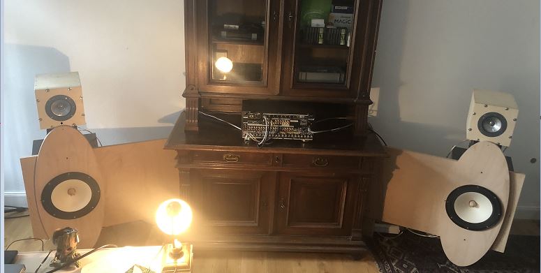

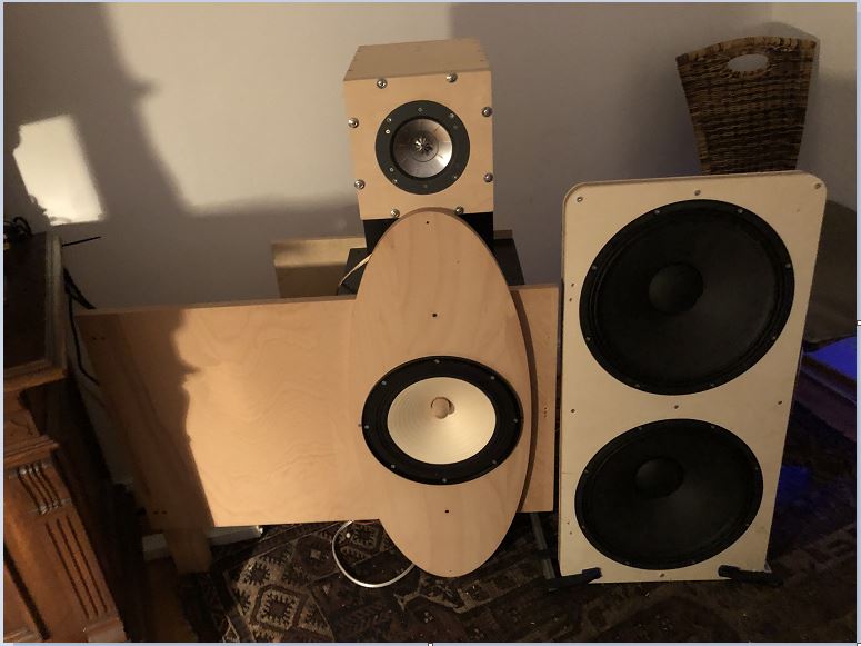

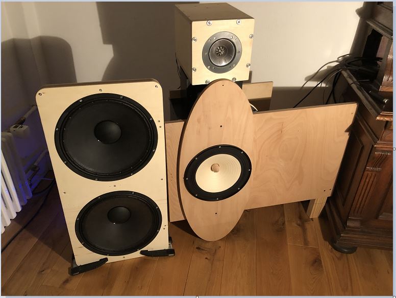

Here are the prototypes I built and am using right now. For a lot more rigidity and less standing waves inside, they are almost cylinder shaped, multi angle(for looks) enclosures. I used to build some box shaped enclosures but this is so much better for this kind of big speakers.
With wheels they are 135 cm high & 68 cm outer diameter. A bit smaller would work also just fine, for example 60cm.
On the left 2 pcs TD12X, and 2 pcs TD12M, on the right 4 pcs 18sound 12NTLW3500. Soon they all will be AE.
Internally they are divided in two parts, two upper and two lower woofers are in separate compartments, with the dividing wall angled one side higher than other to reduce standing waves between the ends of the enclosure. Each compartment has one port on the back, 20 cm in diameter and 20 cm long too. That size is quite spot on and works slightly better than 2 ports which I tried earlier too. In my quite big living room, with the room gain the response goes to 27hz at the 0db point, right below that it it dives very sharply down. Yes, a subwoofer would be required.. ;)
Reactions: 1 user
They are quite serious yeah, you could park a car on top of each without problems. Only the wheels under them would collapse.
Yes, on the left not visible in the picture, there is a mid range array with eight pcs of six inch sb17nac35-8, so I could compare the characteristics and the directivity against a traditional 10" point source mid on the right. Ten inches is a good size for a single mid when you really turn it up outside the house, plus I run it quite low, to 150 hz. I already had the Beyma 10" mid bass, so I just used that one for testing. It can take a lot of power too.
