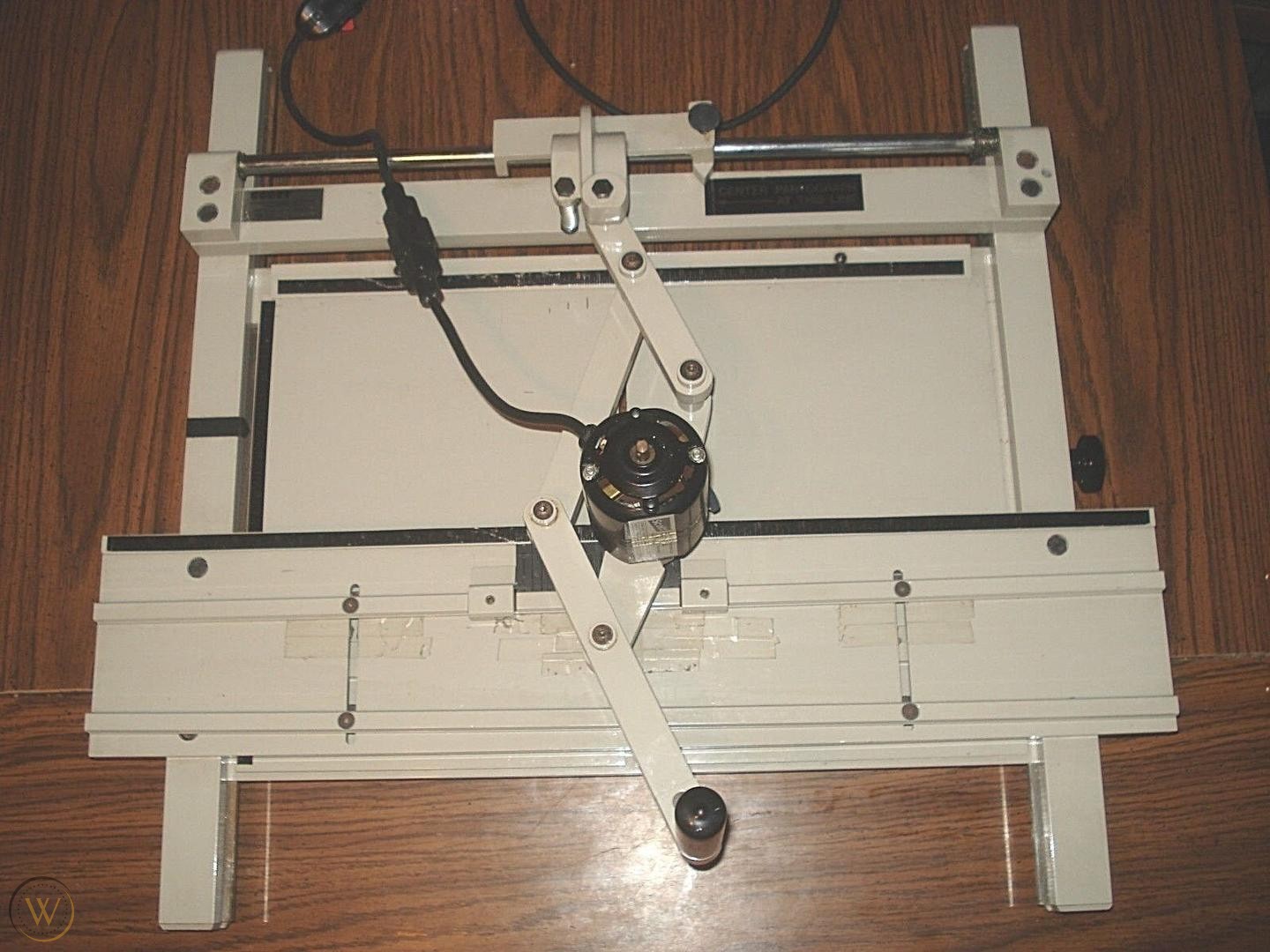

I still use one of these,an old manual Scott,and dated be damned!

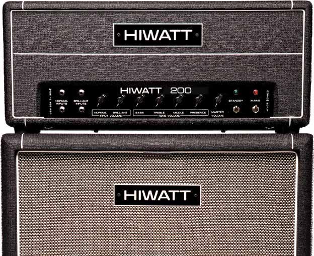

You would be surprised at how sophisticated a control panel you can make with one of these,if you know your way around the machine.Hiwatt is a good example: (web pics)
