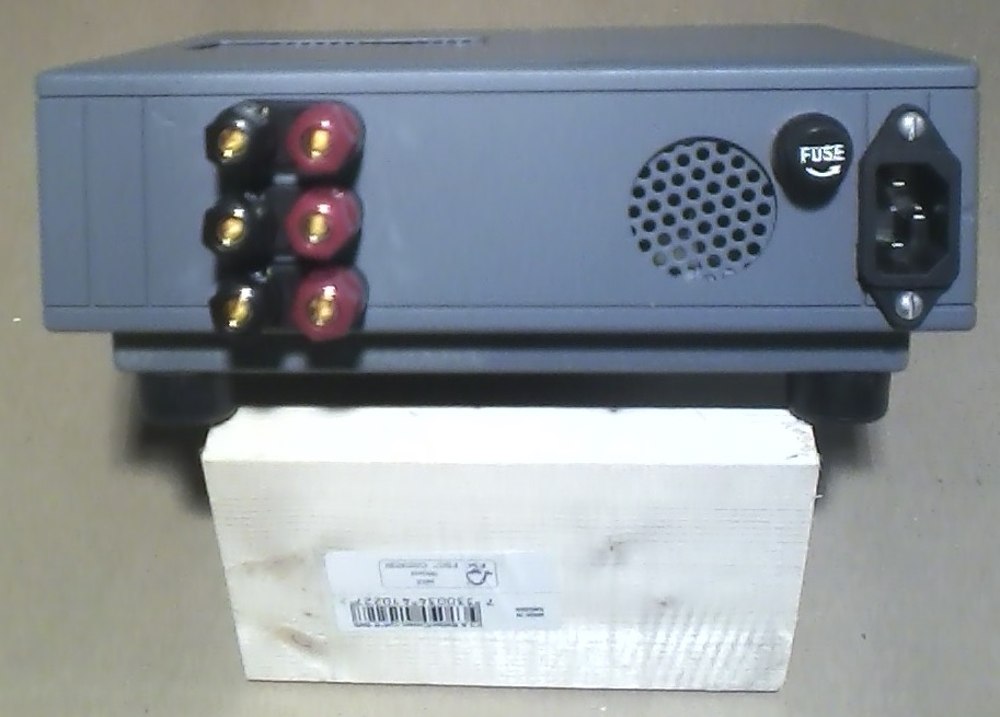

Pics os set up

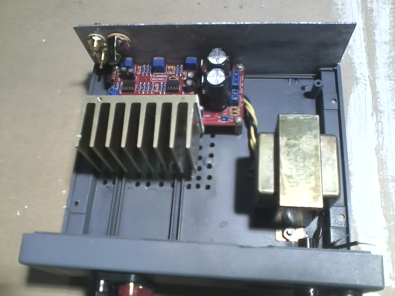

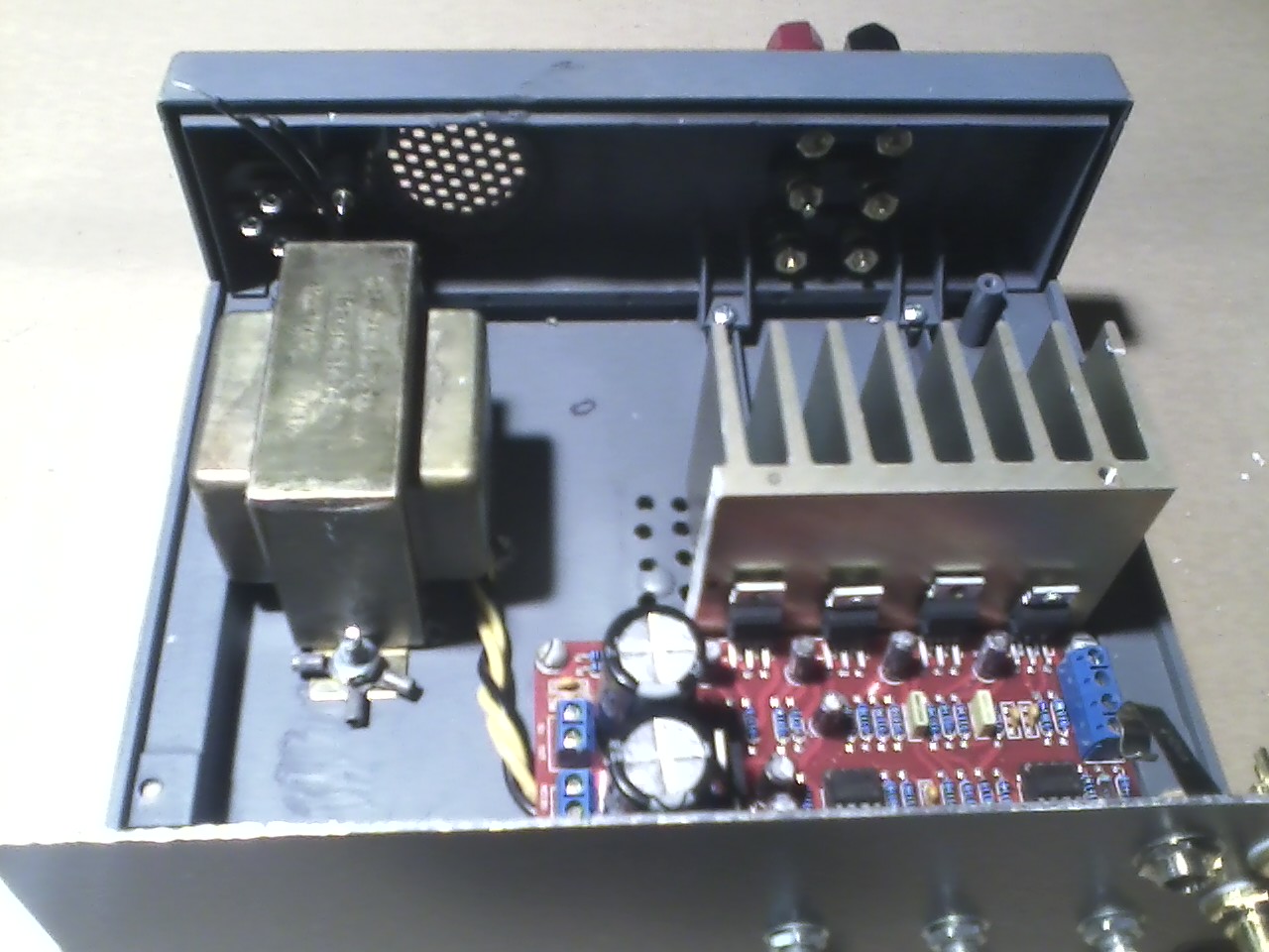

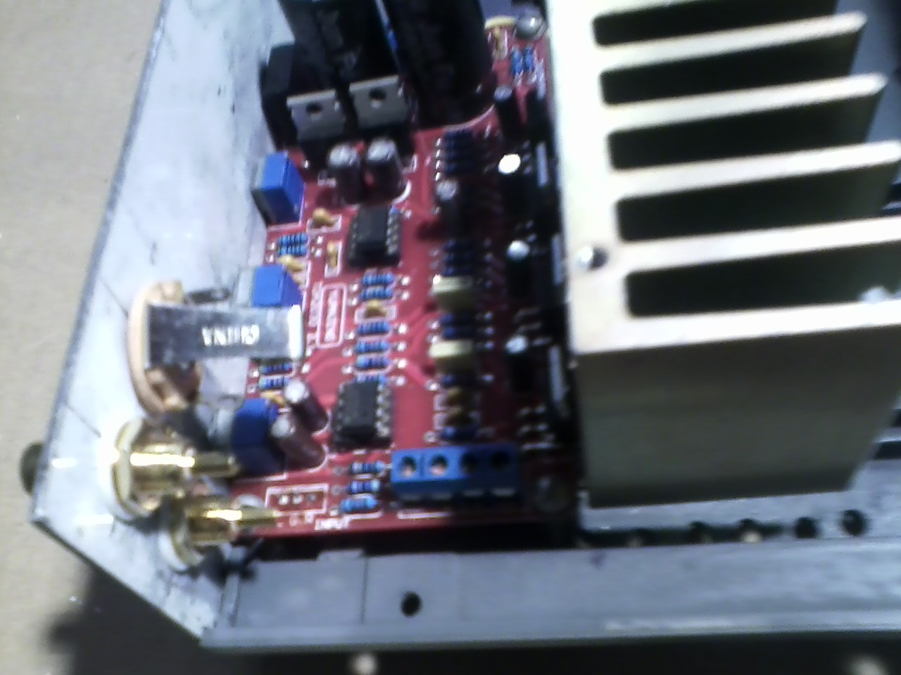

Here are some pictures I took tonight.
This is my 1st build. I've had the parts for years except for the assembled 2.1 board. I had the system sitting on my workbench playing with no earth ground and small heat sinks you see on lm317 chips. It worked fine till I turned the sub up to stoopid with 4 ohm load 🙁
This will be my workbench amp for the time being.

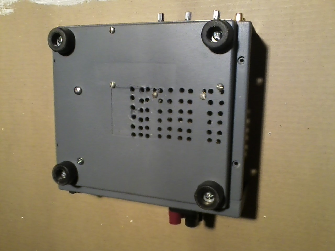

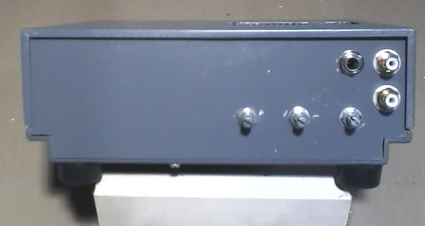

I want the rca's on the front so I can switch sources easily and a 1/4" guitar input for when I work on guitars.
Yes it is machine grey, only spray paint I had in the shop. I plan on making another front face, just scratched the 1st one up during the learning curve.

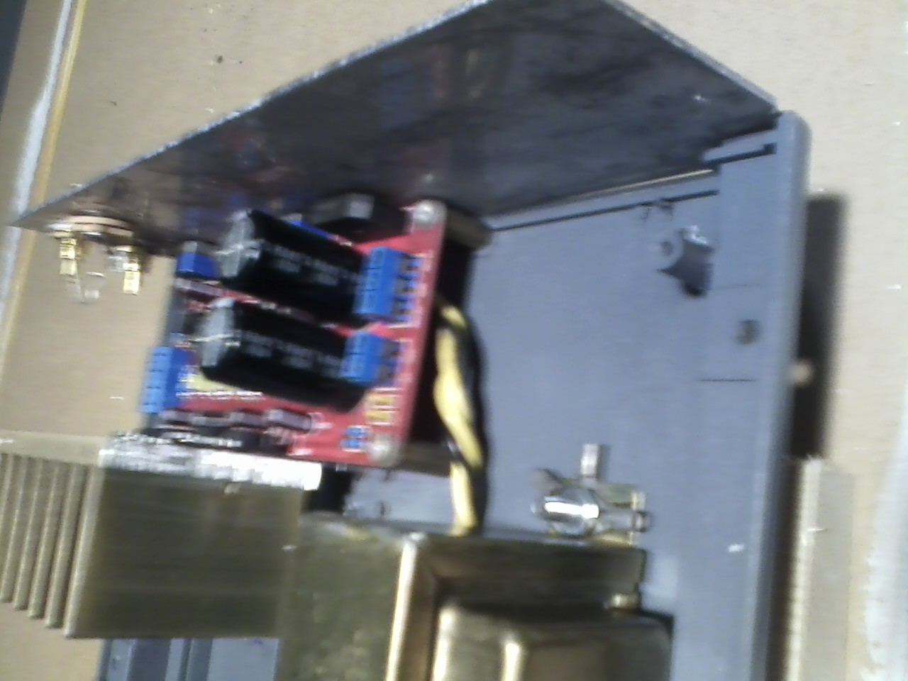

I do have some questions, the chassis is plastic;
My star ground on one of the transformer screws.
I need to run a wire from the earth ground of the plug to that point and from the negative lead of the large capacitors. Can I use the -in on the board where the negative secondary is attached?
On the speaker output do I need to run a wire from the negative posts to the star ground? The heat sink is negative, another wire?
Just want to make sure I get the ground proper.
Since the speaker output is a long run should I put a small cap across the outputs at the binding posts? Are twisting those wires required?
The transformer is a radio shack 12.6-0-12.6 2 amps. I know it is small but I had it on hand and it fits in this box. So I put a 2 amp fuse on the mains wiring and 1 amp fuses on each leg of the secondaries?
Yep, I know I forgot the power switch lol

I fired this amp up last night. Since I broke my 5/32 drill bit off in the heat sink I had to switch to a pair of 496 CPU coolers with fans, so I had to add an adjustable power supply for those.
The amp sounds fine. My radio shack 2 amp 12.6-0-12.6 worked out to 28 volts at the board with my house line voltage of 127volts and music at a loud volume.
For an input I used a sony CD walkman with the volume all the way up.
I tried it at 1/2 volume and it wasn't enough to drive the speakers to an acceptable level.
The test speakers are a set of voigt boxes I made a long time ago with Parts express 69 cent full rang driver, their FS is 100hz, rated at 89db @ 1 watt. For the sub I used my single 10" bass speaker I designed using a Eminence Delta 10 woofer, it is around 107db @ 1 watt so it really over powers the stereo set.
Some of the quirks;
The sub channel doesn't work unless the main volume is turned on and it is super sensitive, almost to the point of being impossible to adjust. You have to just barely turn it on to get that good sub sound where you don't hear it but you feel it.
It is crossed over too high. I have read where these are at 200hz and it seems to be there.
I may try adding a resistor on the output so I can actually adjust the volume of the sub. A more inefficient sub would definitely help but finding 8 ohm subs may be a challenge.
The tone control is also quirky, on this system it sounds best at about 1/3 of the way up.
Using my I pad analyzer with c weighting I managed to get it really close to the munson curve. The system is really heavy around the 250hz region, the sub seems to be right below that with a big boost down to 60 hz. The I Pad is known to be very questionable below 100hz without a break out box. Once my computer system is set up in the garage I'll be able to get better readings.
With no music the DB rating in my garage was 48db, the fans were 59db.
(way to annoying)
I played music as high as 89db but prefer it around 70db.
To get to 70db the volume is about 1/3 up, at about 50% you can hear the distortion kick up (90db) and from 50% to all the way up all you really get is more distortion but still sounds better then boom boxes.
I have the fans set at 9 volts so I will turn them down to the lowest I can get them to still work. 3 hours of music created no heat I may even try them with the fans off.
My test CD's were AC/DC Black Ice, Ozzy Osmosis and Queen Its a Kind of Magic.
For a 1st build I'm satisfied. I plan on ordering a selector switch so I can have more inputs and once I get some more drill bits I will attempt to put the original heat sink back on. I will also use my drill press the next time.
I also have some Pioneer 3 way 1100 speakers with a 10 inch woofer that I will test this out on next weekend and post here along with more pictures.
I do have another of these boards so I may try to backward engineer these and see if there are any tweaks. The 5533p's are in sockets so they can be swapped out.
Once my part time weekend work is over I have a pair of boards that use 2050 chips and those will be my next build.
They are bare boards so I can use better components and possibly bridge them.
Thanks for all the help!!
