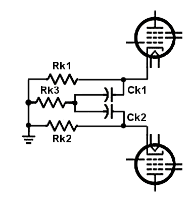

I saw something in the Baby Huey thread (great threads, and Kofi's is priceless!) and I'm hoping to get more info on it...
In the original version with cathode-biased EL84 outputs, there's a bit about using using two separate and bypassed cathode resistors (one Rk and Ck for each output tube) with the bottoms tied to a single 39 ohm resistor. This is supposed to reduce IM products and helps the clarity of the output.
I've attached a quick drawing of the circuit as I understand it from the Baby Huey thread (see below).
I understand Allen Wright's PP-1C EL34-triode amp uses this same trick (and used it a long time ago). That schematic is here:
I'm hoping this is applicable to all tube push-pull output stages that might wander into class AB. Questions:
1) How would one go about deciding on the proper value for the shared cathode resistor (Rk3 in my drawing)?
2) I noticed the Baby Huey uses 39R for Rk3 while the PP-1C has 68R. Does that mean the value is relatively uncritical?
3) Can something like this be accomplished with a single, common cathode resistor such as would be necessary with a pair of DHT's using a single filament transformer? Maybe a small value unbypassed resistor (say 47R) in series with the bypass capacitor, between the cap and ground? Or would that simply introduce a shelf in its low frequency response due to partial degeneration?
Thanks!

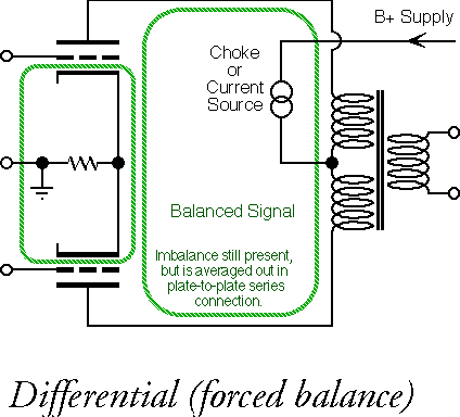

...And there's another, related, push-pull trick I'd like to ask about.
Lynn Olson, in a presentation made to the 2004 European Triode Festival, mentioned a Western Electric PP triode output circuit that's pretty standard except for a 10 to 40 uF capacitor from the B+ tap to the OPT center tap to the junction of the two cathodes in the output tubes pair.
Lynn was talking about the signal path in amplifiers and how they follow the current through the circuit (if I understand correctly, and it's likely that I don't!). I think the 10 to 40uF capacitor from B+ to the output tubes' cathodes bypasses the unbalanced current going through the tubes to ground to above ground, from cathode to plate to OPT winding to OPT CT back to cathodes, and so on.
Later on, Lynn mentions use of a CCS to force balance.
Hmmm... This is getting interesting.
Since I haven't seen these tricks put to use in any other amplifiers, I was wondering if there was any particular reason why -- especially the really easy trick of bypassing the OPT CT (B+ feed) to the joined cathodes of the output tubes. The reason I bring that one up is that I tried it with a 20uF 630V Solen cap and it seems to work really well. Nothing to measure with, unfortunately. I'm hoping to bring the amp to a friend's shop and see if any differences are observable on his 'scope.
Anyway, if anybody has experience with any of these strategies, I'd like to hear what you think of them. Always a learning experience...

Modified cathode circuit
The way the cathodes are connected somewhat resembles a differential amplifier that is commonly used in modern transistor amplifier input stages (transimpedance amplifier). That is it looks like the emmiter coupled circuit, only with cathodes. It should also provide a small amount of coupling out of phase/negative feedback, and balance, between the tubes. It is also in a way a pair of emitter resistors.
I am referring to the small schematic in the first post.
In the top circuit, there's degeneration to the extent that the cathode resistors aren't fully bypassed. My experience is that the difference between bypassed and not, results in a 6dB step in the frequency response. So a partial bypass as shown would adjust that shelf in the FR to somewhere between 0dB and 6dB.
In the Western Electric circuit, the CT of the output tranny is a Ground for AC due to the 100uF PS cap, so the 40uF or so cap would have exactly the same effect as if it when to DC ground, bypassing the cathode resistor.
Putting a current source in line with B+ , I don't see how that balances anything.
MagicBus said:
My interpretation is that he makes a distinction between "push pull" and "differential". Without the CCS, the tubes work in parallel - the definition of push pull - while a CCS will force the tubes to work in series - differential.
No, they work in push-pull in both cases - not parallel, not series. The CCS in the anode feed merely forces AC current balance but in a somewhat awkward way, because the anode is a poor place to influence a pentode. I suspect it is as likely to increase distortion as reduce it; it could reduce 2nd and raise 3rd.
The reason why you will not see these tricks used very often is that they are are tricks. Sometimes they work (with a particular valve, at a particular time) sometimes they don't. They sometimes swap one problem for another problem.
Indeed, I realize these are not universal tricks. I spotted that Lynn Olson avoided to speak about pentodes and class AB. Still not guaranteed to work with all triodes in classA. I just tried to focus on how the push pull power stage handles its own imbalance. It seems to me that the summation of the two antiphase signals is done in a different way in the "parallel" and "in series" models.
The impedance as seen by the two cathodes affects the overall harmonic spectrum, as well as peak current demand. A differential pair with a current source (as used by the late Allen Wright in his PP 300B amplifier) hits a hard current limit when one tube cuts off. (The current source sets a hard limit to the peak current delivery of the entire amplifier.)
