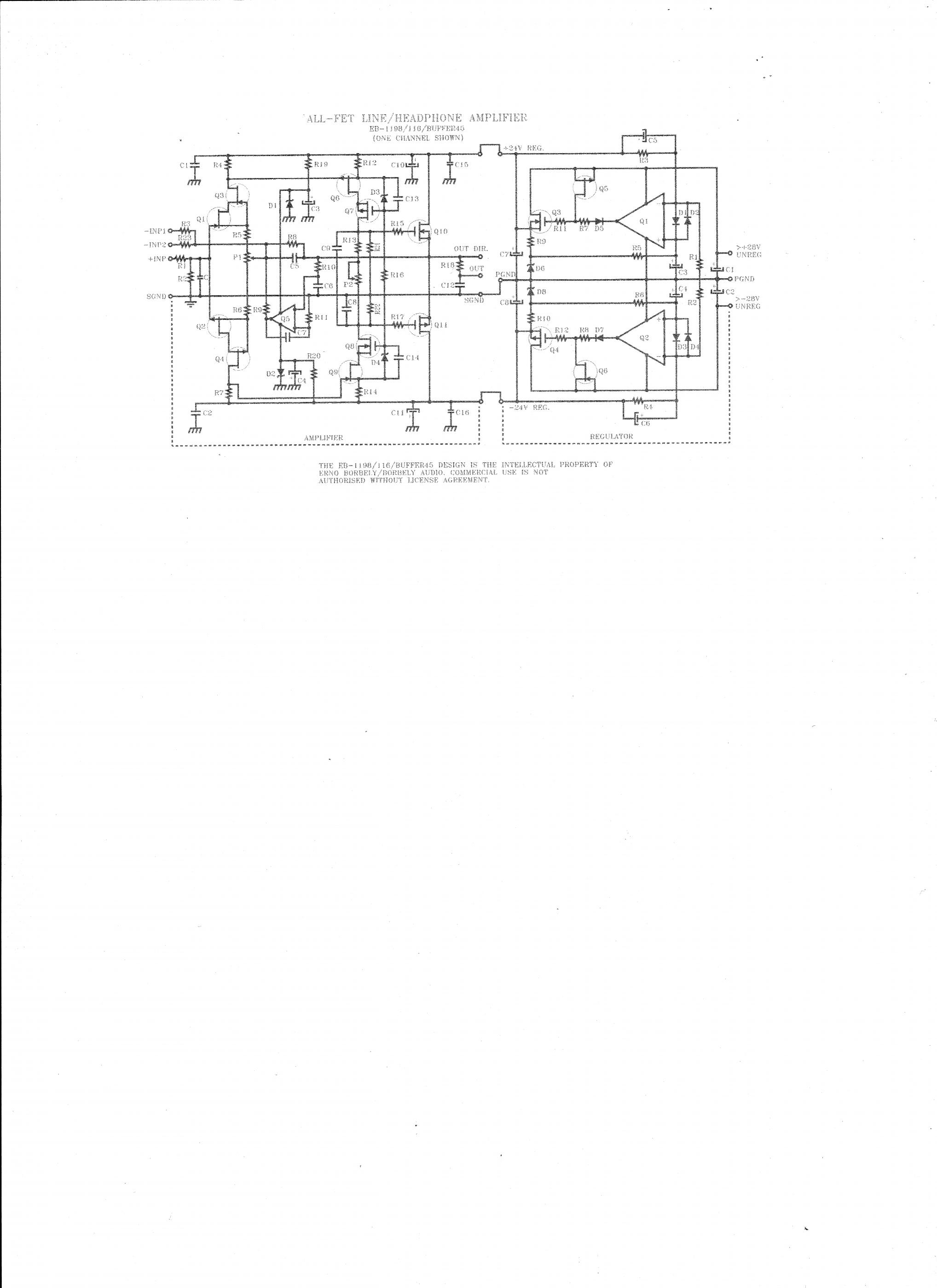

I use Erno Borbely stuff I/V DAC, lineamp/headphone amp and 75W RMS monobolocks amps. I'm using balanced with two separate PSU and two stereo preamps in two chassis (one for 2 PSU and the other chassis for the 2 preamp)
Preamp topology
"The input JFET-Cascode, consisting of Q1-Q2-Q3 and Q4 are operated at 2 mA. Q1 and Q2 have to be matched to 10% of Idss. The second stage, consisting of JFETs Q6-Q9 and MOSFETs Q7-Q8, are operating at just below 10mA. Q6 and Q9 have to be selected for Idss>10mA. Note that this also provides matching between the N- and P-channel JFET. The output devices: Q10-Q11 are Hitachi TO-220 MOSFETs. They are operating at approx. 70mA; proper heat sinking is therefore mandatory.
Q5 is a JFET-input servo amplifier, providing tracking of the output offset to less than 1mV. The RC-networks of R10-C6 and R11-C7 filter out all AC signals over 1 Hz. The servo is therefore only operational at less than 1 Hz, and should not affect the sound of the amplifier. Nevertheless, if you feel that it does, don’t hesitate to try different opamps for this. D1 and D2 are IC shunt regulators, supplying Q5 with +-10 Volt."

Merlin, how do you drive such low impedances?
Opamps are ruled out. Most of the buffers too. I'm aware of only one buffer which could drive such load, but it cost quite a lot for an IC, and is out of production. TO-3 cased LH0063...
Alternatives...
- LME49600
- Opamp-wrapped BUF634/AD815...
Borbely 116 lineamp schematic
Q. What is a line/headphone amp?
A. A headphone amp used, for some peculiar reason, to drive a line.
