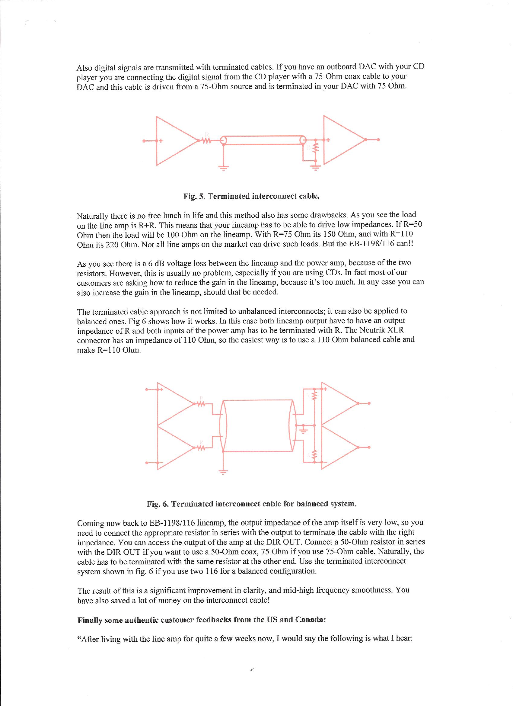

If your source could drive 100ohm load without any distortion increase, with 6db loss in mind - to get 2VRMS at the input.
And if your connectors have really good contact/low resistance.
Otherwise... don't bother.
BTW, output stage being able to drive 100ohm load with no additional HD, with 8VRMS is nice to have, no matter which cables you use and how you terminate them...
But hey, it's 0.5W amp!
For the reflection maniacs - just terminate these cables on HF where it really matters, and leave the LF as is.
few-pF Cap + series resistor of 50ohm to ground terminates the transmission line on HF and doesn't loads the source.
And hey, who said you need to terminate both ends of TL? Throw a series 50ohm at source (that's what everyone do).
