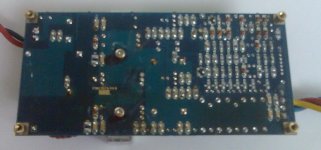

Hi everyone,
I'd like to find pmh3000 behringer power mixer schematics, in fact just power amp section.
I'm just curious about the way they implement class d topology in their power mixer.
I've just downloaded pmh1000 Schematics (N and P mosfet halfbridge for 200W/4 ohms)
can someone help me finding this schematics ?
thanks !

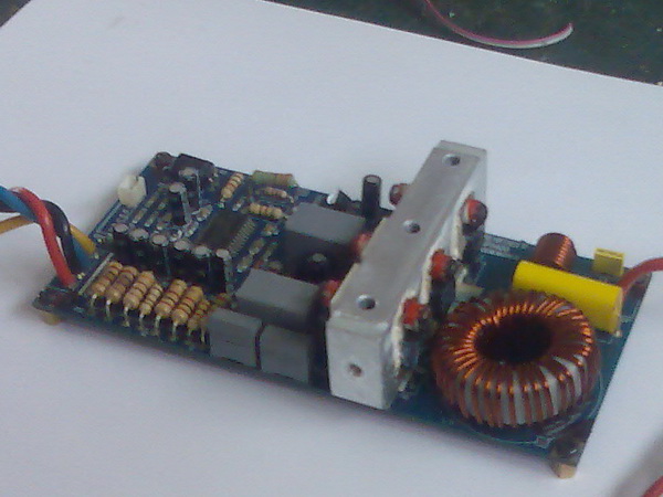

I have't once this unit for repair, not sch, but i remember it uses 2*IRFP640N with 4 diodes (paralel-series), drived by some integrated ic (like tc429, smd), optocoupled with some BP ic, feedback after the filter (20uh+1.5uf), many smd caps for decoupling vcc.
PMH5000 class D:
