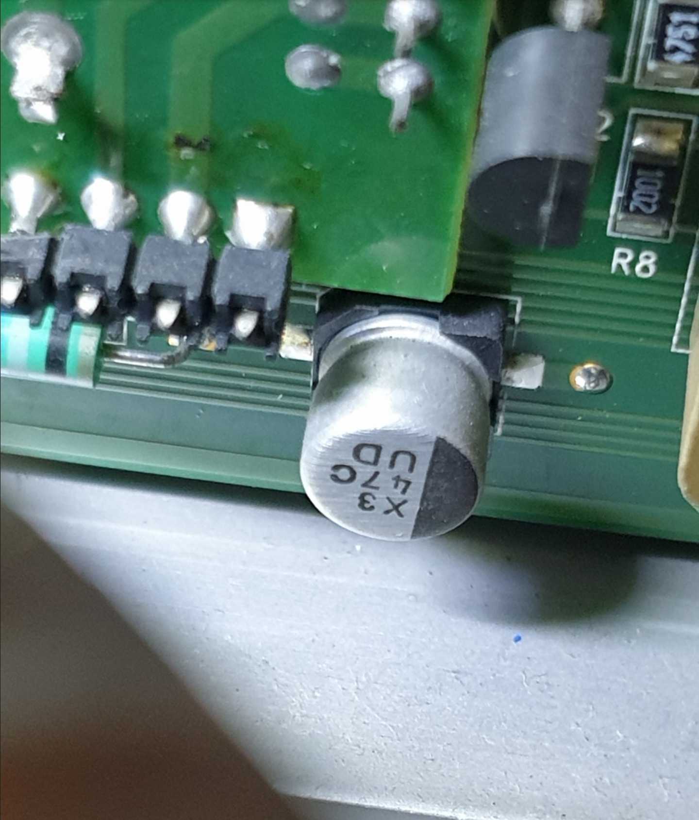

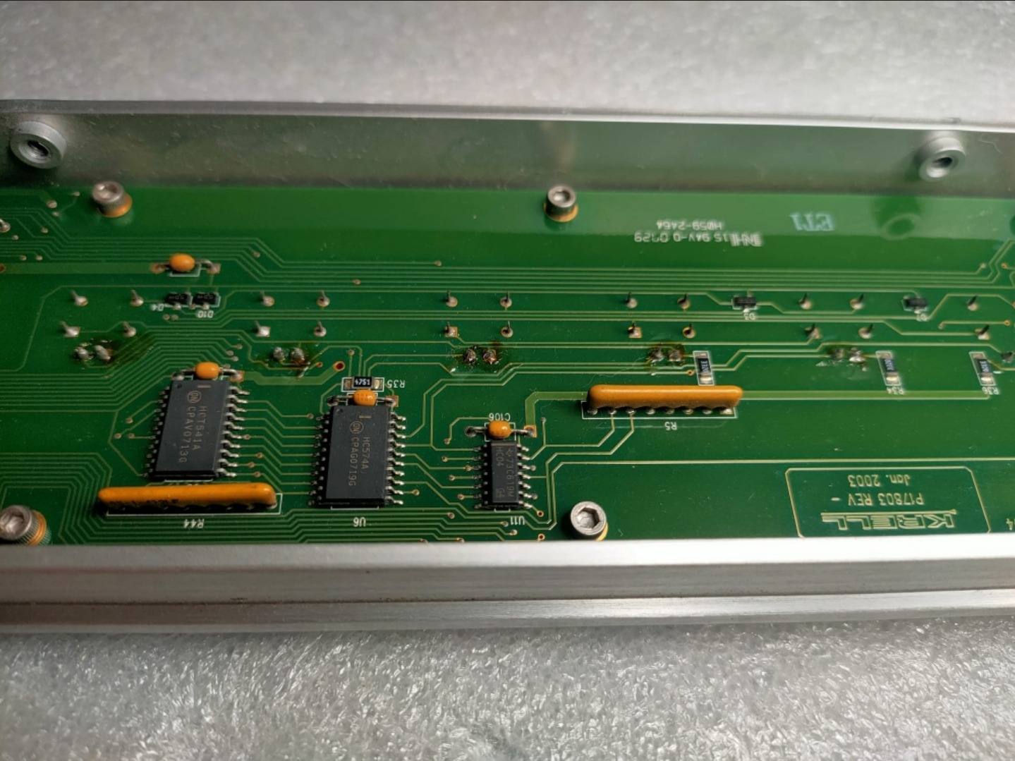

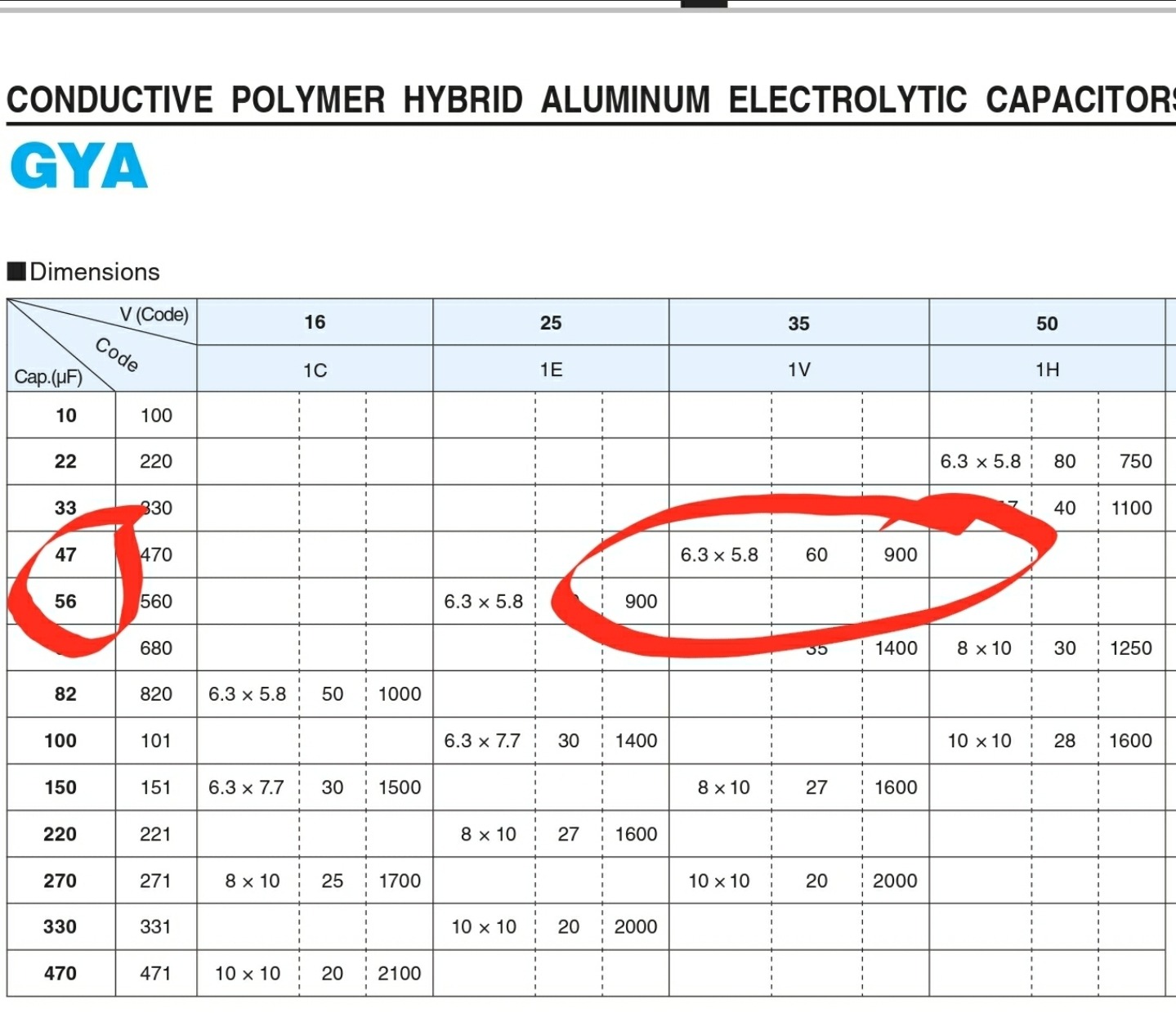

Aaaah .. my apology 🙏🙏 .... those smd ones instead and yes, I am using 25v ones since same size and my stock ones did not read 16v like yours as well as not knowing better and guessing but now more resilent albeit already newer gya hybrid polymer and not stock nichicon uud polymer type as well as in fact 35v version being the lowest rating ? 😅😅 Cheers.

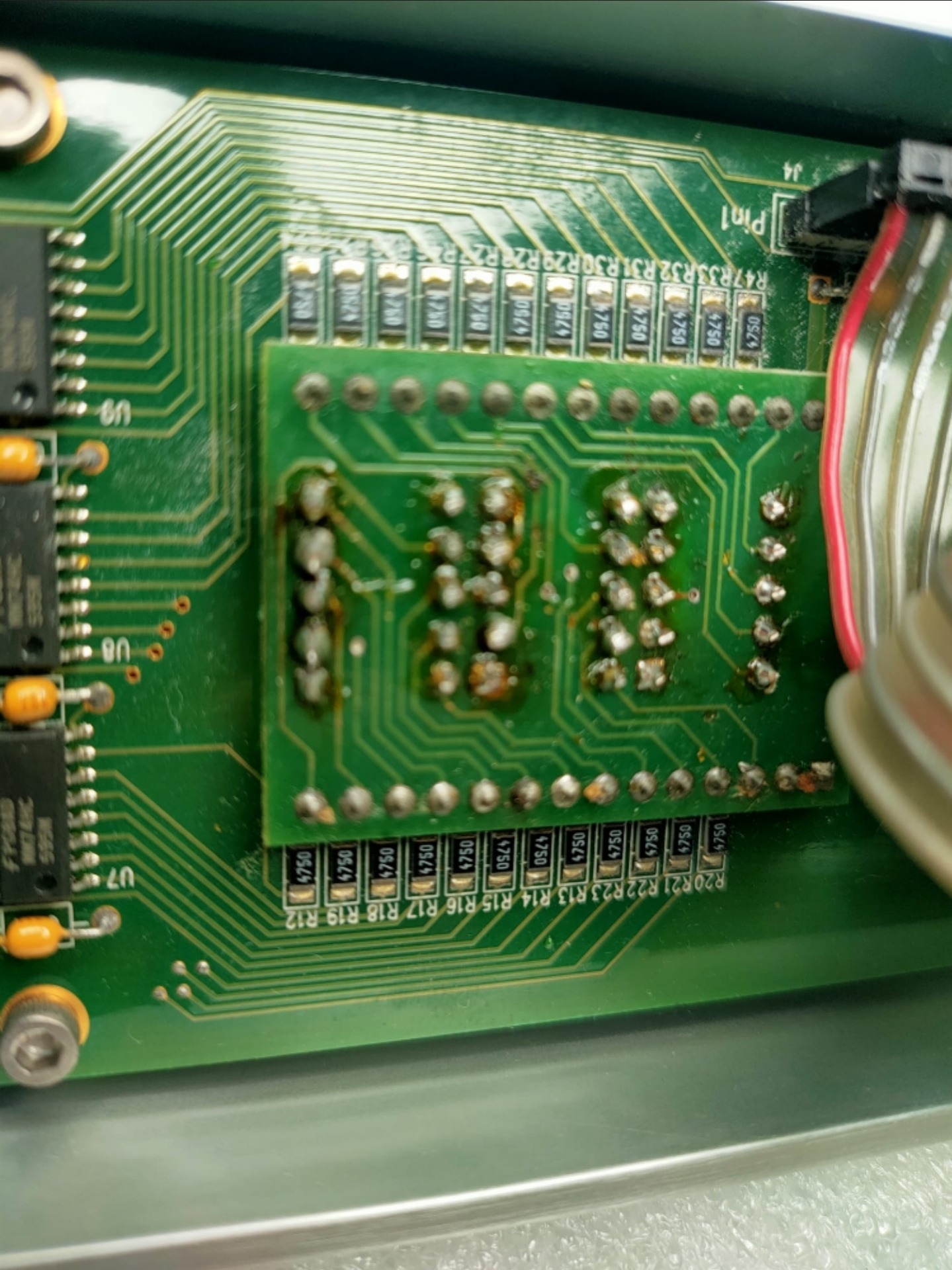

Haha .. you saw wrong .. not capacitors but resistors for the display .. 3 more in my case for the leds.

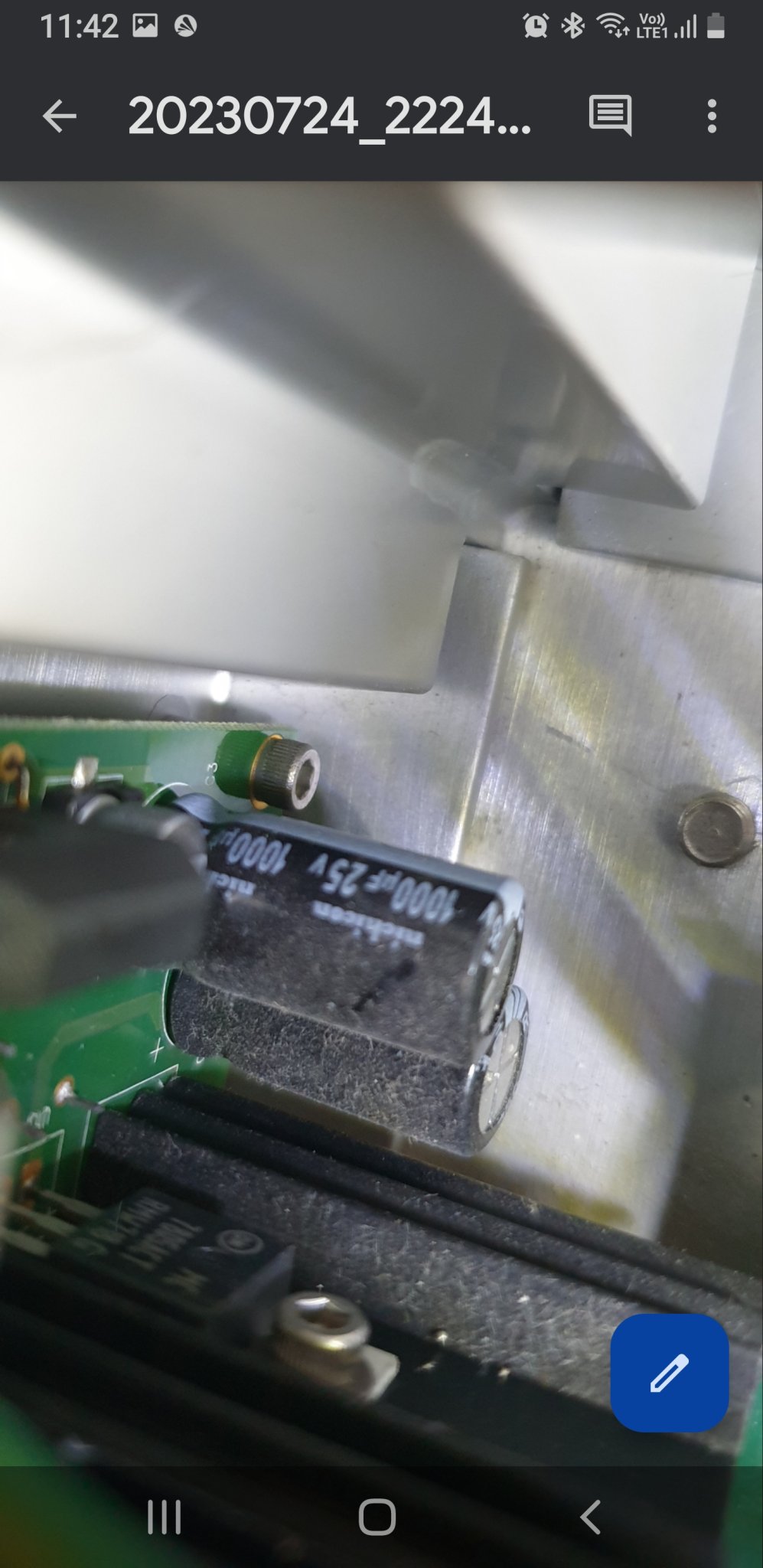

For front panel e capacitors, mine are certainly 25v ones of 1000uf Nichicons originally but perhaps 16v in yours are fine if stock or found needing update/upgrade or simply run of 16v ones in mine.
Cheers.

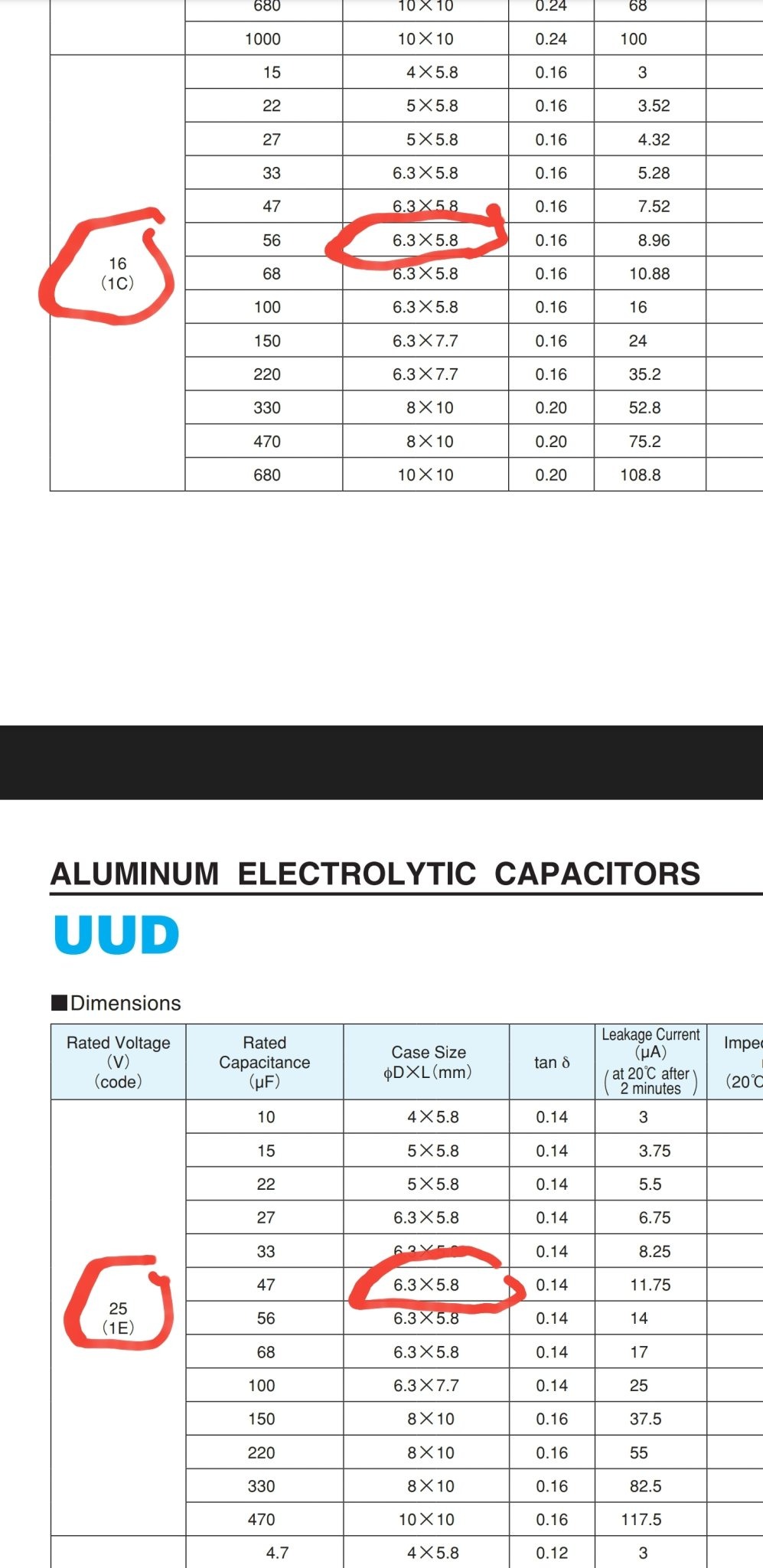

Oh yes, I was more so referring to this.
It says the front panel capacitors being 47uF 25v and I knew I put in 16v so I had to run downstairs and check my pulls to make sure I didn’t make a mistake lol.
Edit: oops, didn’t scroll down far enough and see your next post.
Dan

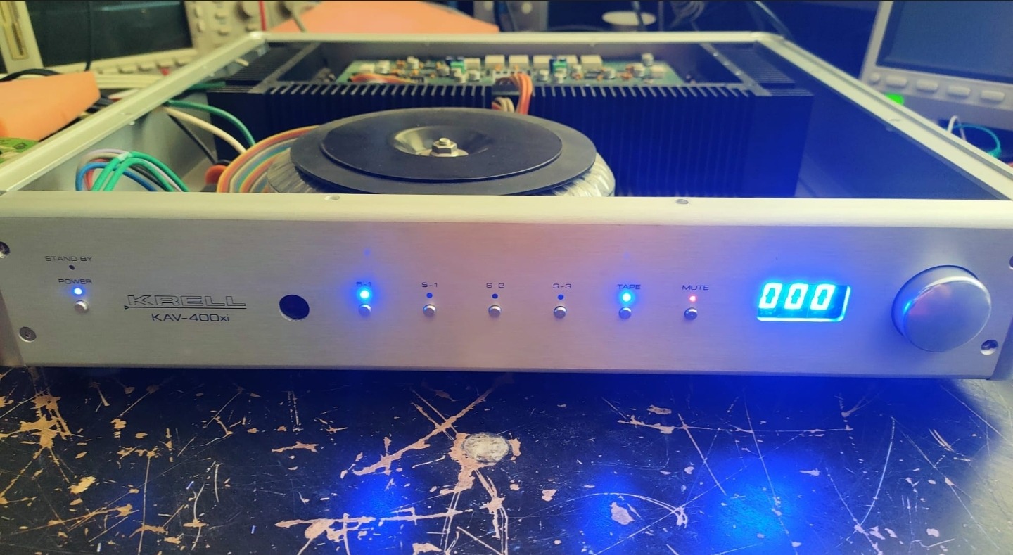

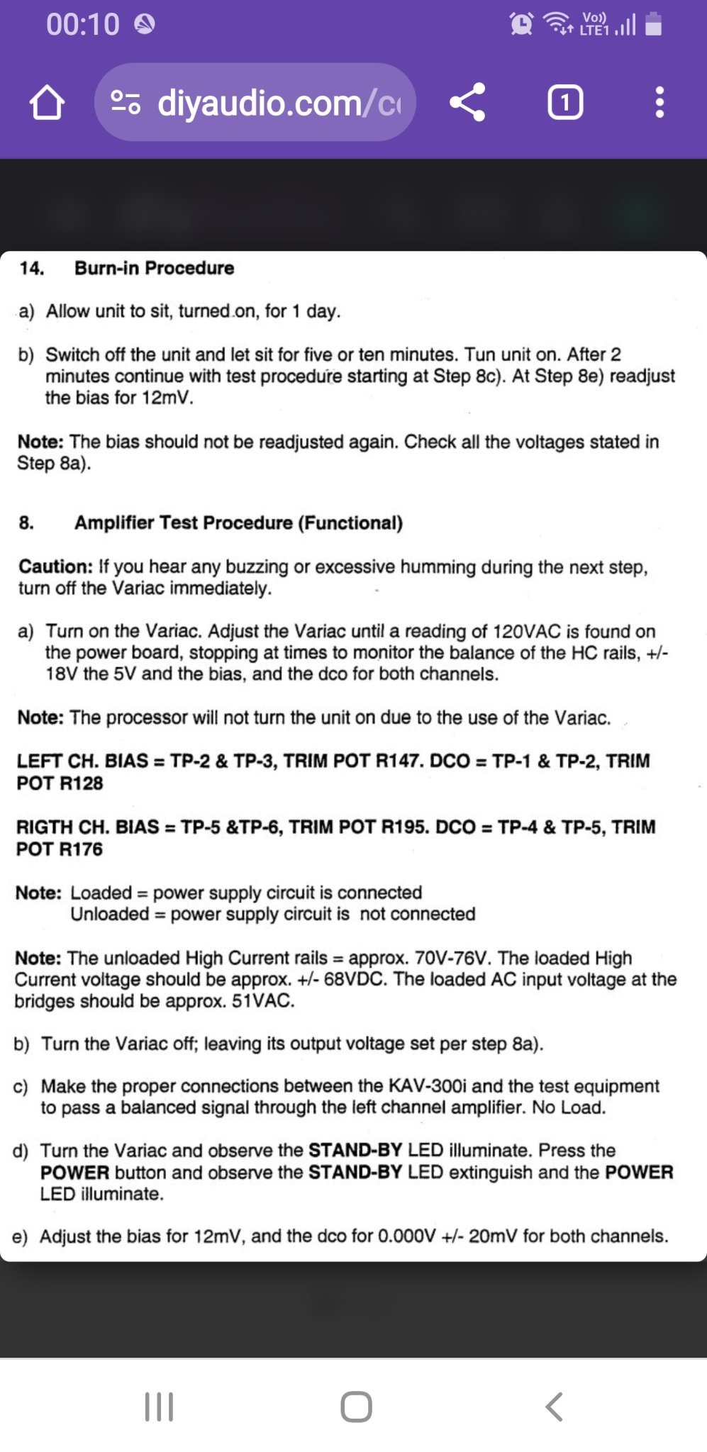

I’m curious Richloh, did your tech make any adjustments after the work was done? I’m guessing I don’t need to make any adjustments, I have about 3 mV of offset on each channel and the amp idles warm, but not that warm and again, after cranking it for awhile it wasn’t alarmingly warm. My OCD would like to take care of it though.
Dan
Dan
Hi Dan, I asked and he said he did not ... his measurement did not indicated any need to do so while I did not verified what he measured or saw them myself to share and I left it as that.

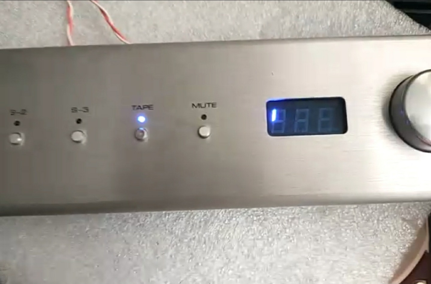

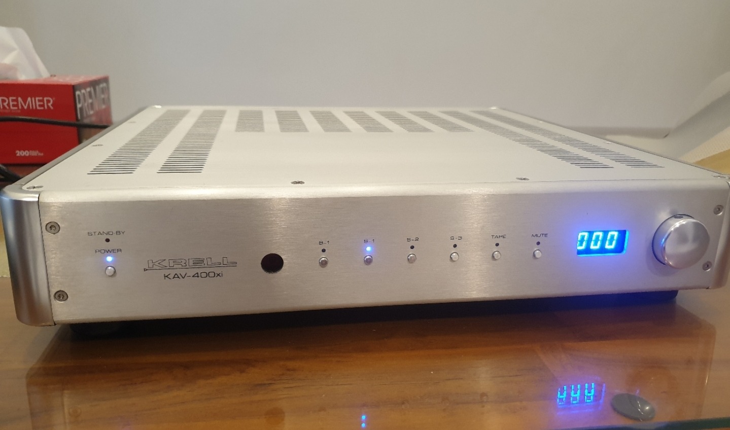

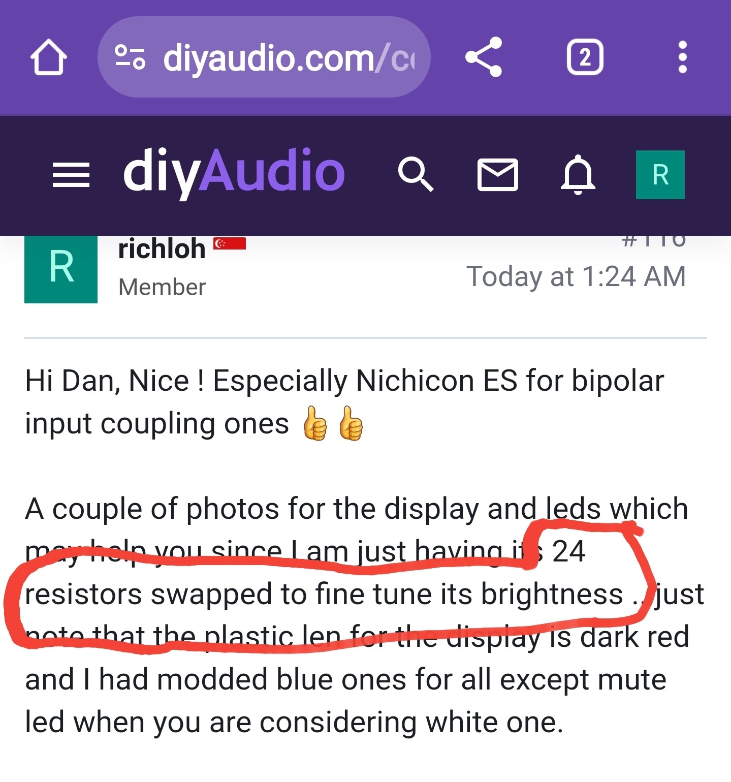

Before and after resistors change to fine tune brightness modded blue leds and display to stock power led .. sunglasses on ebay sales 🙂Hi Dan, Nice ! Especially Nichicon ES for bipolar input coupling ones 👍👍
A couple of photos for the display and leds which may help you since I am just having its 24 resistors swapped to fine tune its brightness .. just note that the plastic len for the display is dark red and I had modded blue ones for all except mute led when you are considering white one.

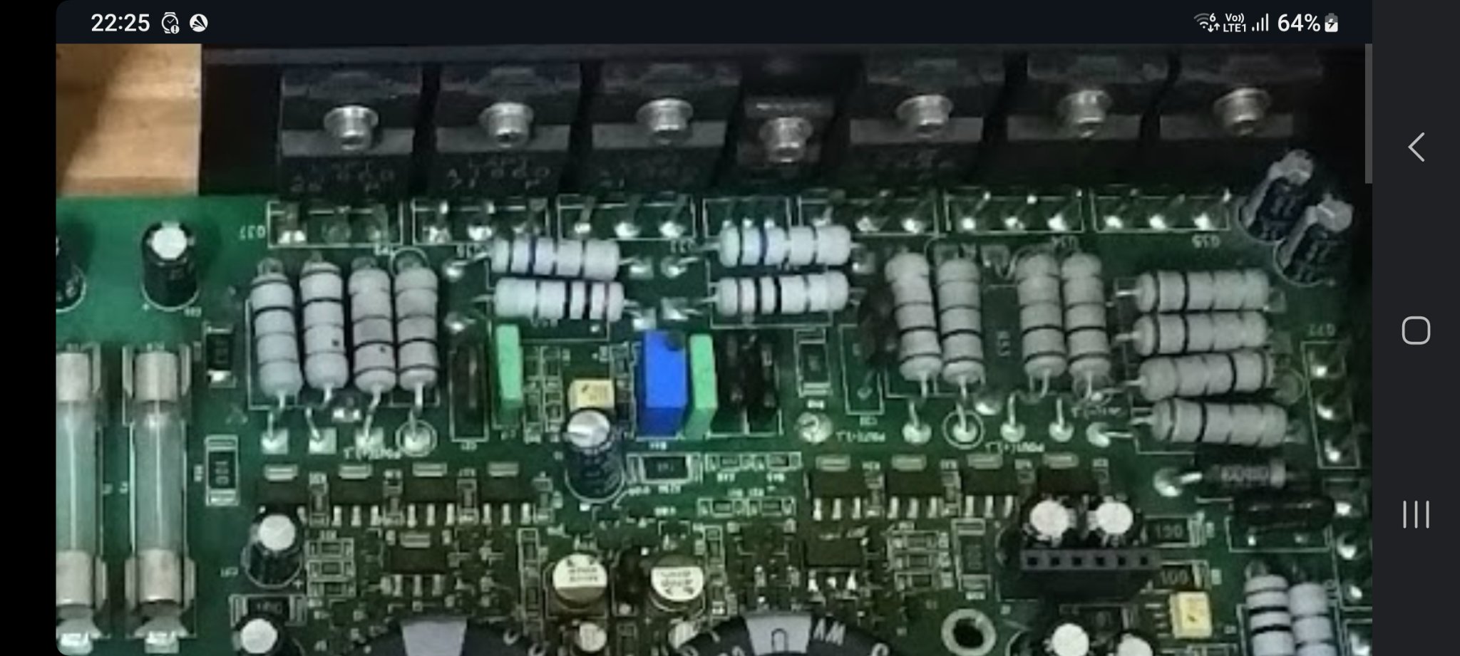

just picked up a nice example of the 400xi. As with all amps I buy I like to check the bias & DCO, so I looked into the 300i series bias procedure in this thread when it became apparent its not applicable to the 400xi.. as voltages at the bias test points don't make sense, they were all way way low, like 2mV when it should be 12mV.
A few notes. I didn't use a Variac, just wall outlet of 240v (Australia). I've not performed repairs so don't see the need for a variac. I also didn't feed the 400xi a balanced signal. Are these 2 items absolutely mandatory? To me it seems odd a signal is applied in the 300i procedure. All other amps I've biased you don't want a input signal
Generally you want zero voltage at inputs when biasing
Does anyone have the correct bias and DCO set procedure for the 400xi please?

The SMD electrolytic capacitors are very bad quality beter to replace them asap otherwise you PCA copper and via's might suffer from the leaking fluid.If the amp works good, I am not recommend to recap.
