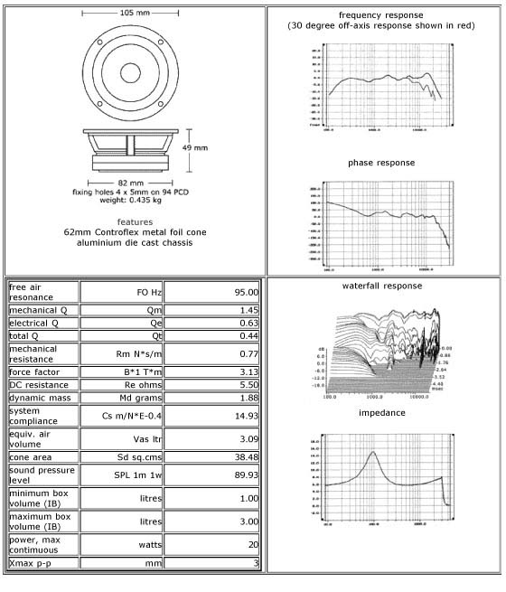

I have the original spec page from the website available as a PDF. It's 250kb so if you'd like to send me a PM, I'll forward it to you.
Re: JX62S
Looks very much like Mark Audio's driver.
http://www.spectrumaudio.de/breit/jordanJX62.htmldavecandialex said:Hi Earplugs, if you still have the Jordan info for the JX62
could you post it?
Apparently we have the technology ... albeit at low res.

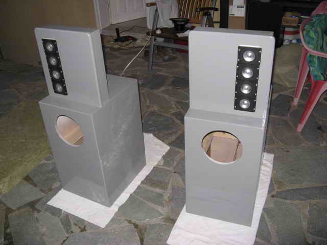

Hi Colin,
after I bought your JX53 I was thinking what to do with them!
I put them in a wide baffle as you suggested at the time and sounded quite good, but put them aside as I liked my other system more.
Last month I decided to finish my project as I had some JX150 sitting around. Hope tomorrow will be finished.
I am going to use the compensation circuit suggested by Jordan and a 4.5 mH coil for the bass. Hope they sound good. You can see some pictures, hope you like them.
Geroge
Geroge
They look excellent - I hope they work well. The wide baffle approach certainly sounded good when Ted demonstrated it, giving the array a lot more weight and depth than my TLs managed. It should make crossing to a woofer a lot easier.
What enclosure are you using with the JX150 - sealed or vented?
Sealed, about 75 litters. I' m only not sure about how low to cross the JX150. I think Ted recommends a 9 mH coil,but it sems to me very low. I will try and see. I have an 6.8 sitting around and test if I don' t like it.
When Ted was using a system like this he crossed over around 100 or 120Hz, letting the array run without any high pass crossover. He was also using a single JX150 per channel in a sealed enclosure. I'll be interested to read how you find the sound.
I will only use use the frequency compensation circuit for the line array and use various coils for the bass and let u know. Thanks for all the information and help Colin.
George
George
Well, I just put the speakers to play and I think they are amazing. To a great part I think to the JX150 woofers. I cross them with a 6.9 mH coil at the moment, after trying with a lower value. I will get a very good 9 mH as ted recommends, it should make thinks better I thing.
The only think I find missing is image height, but that could be due to placement. Maybe they sound better close to the rear wall?

If you have the capability to measure impedance of the finished speakers, it would be a good idea to see if flattening out the impedance peaks would make the sound better.
Hi - They look very and glad to hear they sound good too. Image height is, I think, a function of using an array - the sound at HF drops off a little as you move below or above the array's field of fire. So raising the cabinets or sitting farther away may help sort this. It's also worth experimenting with toe in - Ted has his at 60 degrees in. The woofer is only rolled off at 6dB octave so it will contibute weight and warmth to the lower midrange, filling out the sound.

Yes, I have all the cables measured to the same length.
Unfortunately I can' t measure the impedance of the finished speaker now.
I once did it with another speaker and a demo pc program. I still have the wires and resistors required, but it was quite complicated, and using the sound card of my laptop, I wouldn' t really trust the results. Do you know an easy way to do it?
I think Ted's comp circuit may be all that you need. It's designed to reduce the LF gain of the array, caused by close coupling of four drivers. (Below 4kHz you'll get a gain of 6dB.)
A proper crossover may help - ie one which has both low and high pass sections - but that could be a more complex undertaking.
Colin, I think the reason I did not like them so much before was that they were playing full range, without the comp circuit.
Tried with different placement and sound even better! I will experiment more and cross them lower and with a better quality coil than now and then decide what to do, but I prefer to stay as simple in the crossover as possible. Anyway, I am really exited with the speakers now!
