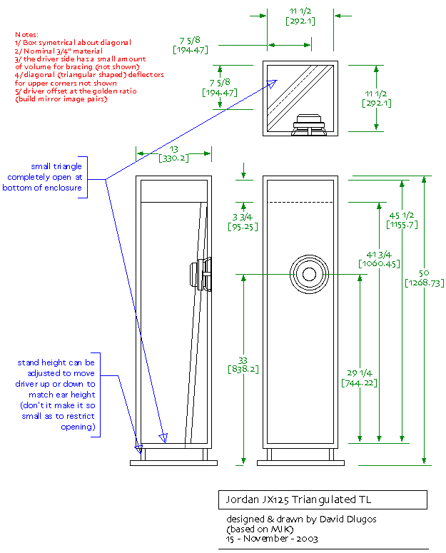

You have the makings of an excellent sat/sub system. The 92 differs from the 'S' version in being a little less efficient and, I believe, no sheilded magnet. The current TL design on the Jordan website should work ok if you want to run these from 45Hz up. I'd guess that the MLTL designs are more critical wrt driver parameters. Alternatively, build a nice, solid sealed box of around 8 litres and crossover to the JX125s at around 100Hz.
Regarding the 125s, you could run these sealed or use in a ported enclosure. Although the old Jordan site gave a design for two 125s per side in a 66 litre box, it never gave an enclosure for a single 125. I asked Ted for a one a while back and he suggested 33 litres with a vent of 2 inches diameter and 11 inches long. You could use the 92s without any form of crossover (let the enclosure roll off the bass) and put an inductor in series with the JX125s to roll them in. (I have a value for that from the old site, if you don't have it.)
GM has also produced a MLTL for this driver. The enclosure would be bigger than the BR - It depends how you want to go. Any of these options should tell the Tivoli where to get off ...
Colin
and here is a tapered triangulated TL for the JX125....
dave
