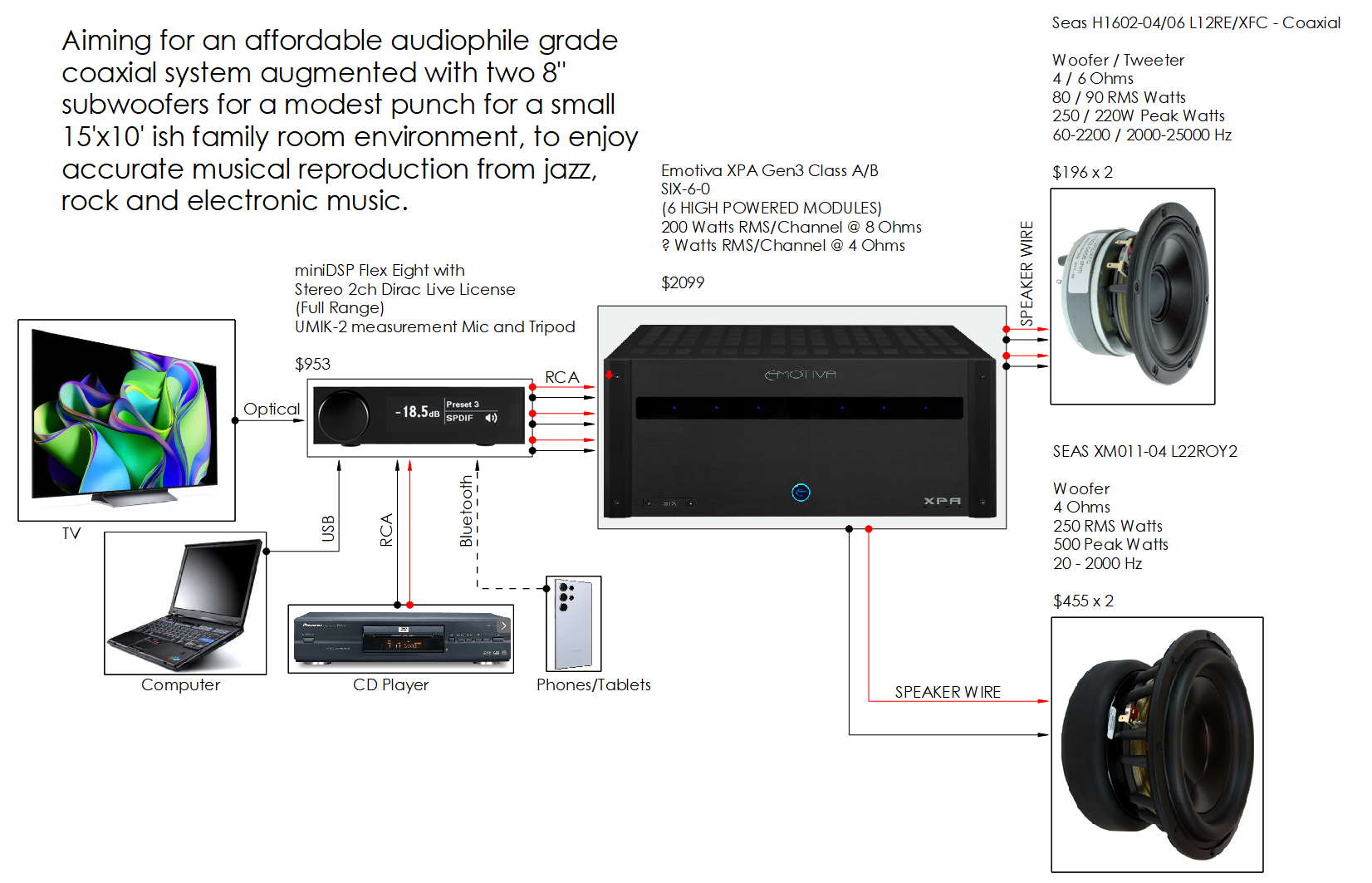

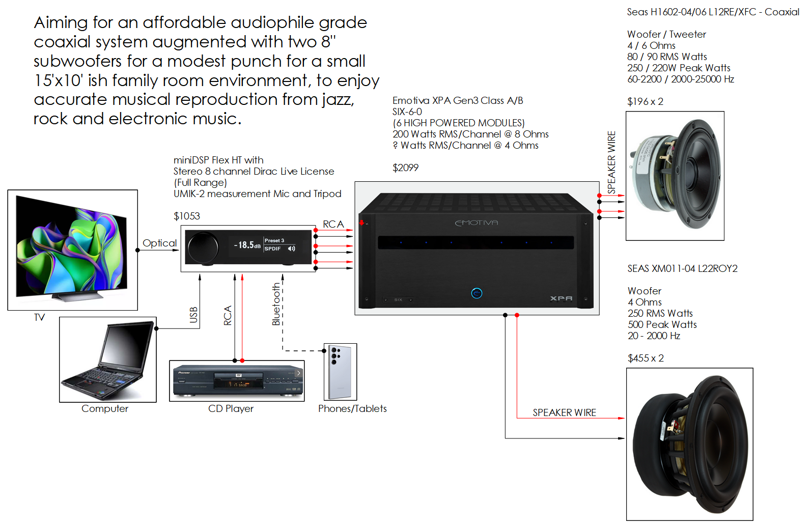

Well maybe Sygnalist on the PC with an OKTO 8 pro is a good BET. But sure the Flex 8 with Dirac will be easier for a newbie...

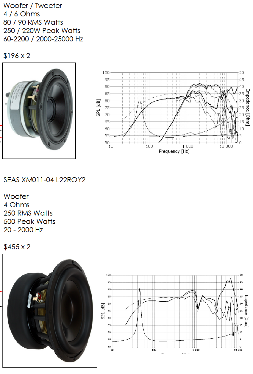

Youcould consider also a SB26CDC in an augerpro wave guide, some prefered it to a non wave guided T34B ! Patern matters. Anyway all those tweeter list are very good ones but will have different presentation. The Seas being excelent sounding for a fabric but very low SQ/P proce. Bliesma is expensive too.

Look at the system diagram the OP provided - he's not sourcing everything from the PC. Running a software crossover into the 8Pro will not give him that.Well maybe Sygnalist on the PC with an OKTO 8 pro is a good BET. But sure the Flex 8 with Dirac will be easier for a newbie...
He could get some ADCs to AES/EBU but then the whole system clocks from the AES/EBU on input 1.
