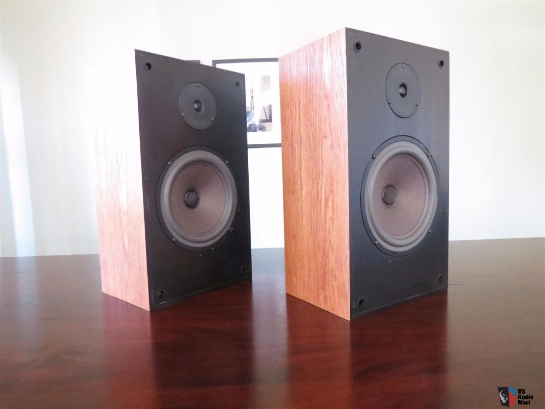

Can you guess who made these sealed examples?
Those aren't over bearing within size limitations at the smaller end.

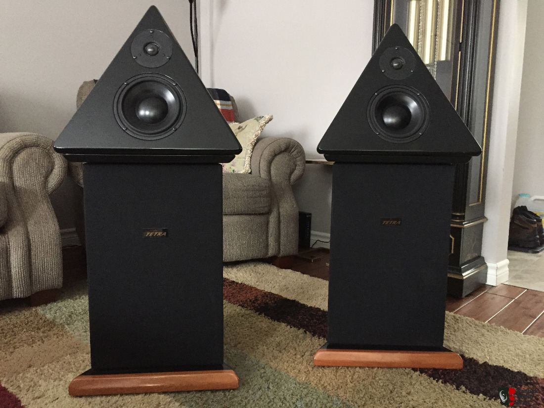

I wanted Tetra 406's for the longest time. Something had me thinking they were sealed, there not. Doesn't matter, they sound great.

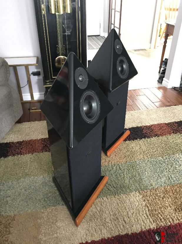

I got to thinking today, how cool would it be to clone the 406s in a sealed version?
I'm not sure if my cabinet making good enough to pull a pair off. I'm somewhat of a perfectionist, I can see myself not being happy with them if the joints were shoddy. That or I could go through extra material until I get them right. If needed. But thats not logical.
The Tetra's are Made over here too. I think I want to go for a clone build....I'll give it some more thought.
I made a set in the '90s. May I suggest you don't use the idea of cloning if you can't track everything down. Instead just work out a suitable volume for a woofer of your choice, calculate the size of the front panel then try to fit the two on to it. If it doesn't look good then change the cabinet size or change the woofer to bring on a different cabinet size... maybe you would prefer to do this in the reverse order 😉

The Morel's that were recommend earlier on. How would pyramid shapes be any different than more conventional boxes? Its still a matter of lining up the interior boundaries to suit, no?
I can't understand why that wouldn't work. A sealed cabinet is a seal cabinet. What am I missing?
What components did you load them with back then? The Morel's that were pointed out could work. Its a matter of lining up the interior boundaries to suit, no?
..a sealed cabinet is a seal cabinet. What am I missing?
The more I want to built the pyramids..
Yes, to some degree the closed box is just a closed box, no matter what it looks like. This way involves the bass resonance.
There are two basic ways it could be different, one is the way that internal reflections happen inside the box. Some feel it is better to change the shape of the box by tilting walls so they aren't parallel. This is also the reason we use damping material inside the box.
The other is the exterior diffraction. Some feel it is better to vary the distance to the cabinet edges and choose different shapes for this. This is also the reason people round over the edges.
