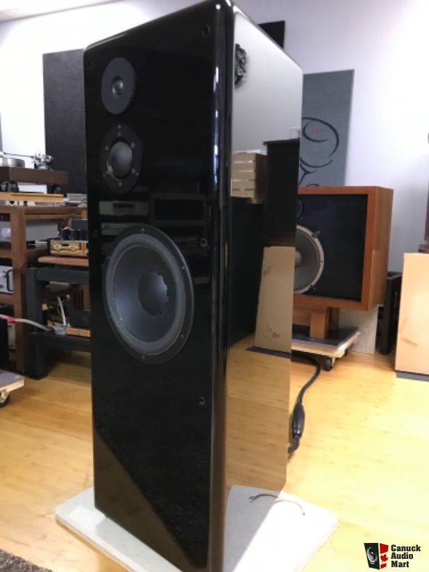

I wanted Tetra 406's for the longest time. Something had me thinking they were sealed, there not. Doesn't matter, they sound great.
I got to thinking today, how cool would it be to clone the 406s in a sealed version?
I'm not sure if my cabinet making good enough to pull a pair off. I'm somewhat of a perfectionist, I can see myself not being happy with them if the joints were shoddy. That or I could go through extra material until I get them right. If needed. But thats not logical.
The Tetra's are Made over here too. I think I want to go for a clone build....I'll give it some more thought.

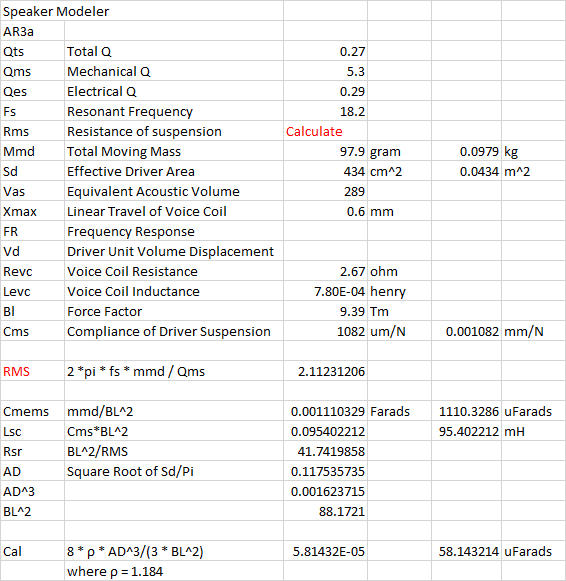

As an owner of an AR-1*, let me point out that the essences of the AR-3 have not be presented clearly in this thread. Here's my best memory.
You have two upper-range drivers with excellent dispersion and a woofer with a very low Fo (maybe 13 Hz) in a well-stuffed 1.4 cu foot box with the thickest walls anybody ever used before or since. And a somewhat complicated XO (like all good XOs) and volume adjustments (depending on the model).
The sound is wonderful, neutral, clean and with a speaker peak around 38 Hz (guess), a surprisingly satisfying bass in a small box.
I wish I knew where you could buy a woofer driver like that. Anybody know? In the absence of such a driver, you could duplicate the AR-3 with a more conventional driver and a larger box.
