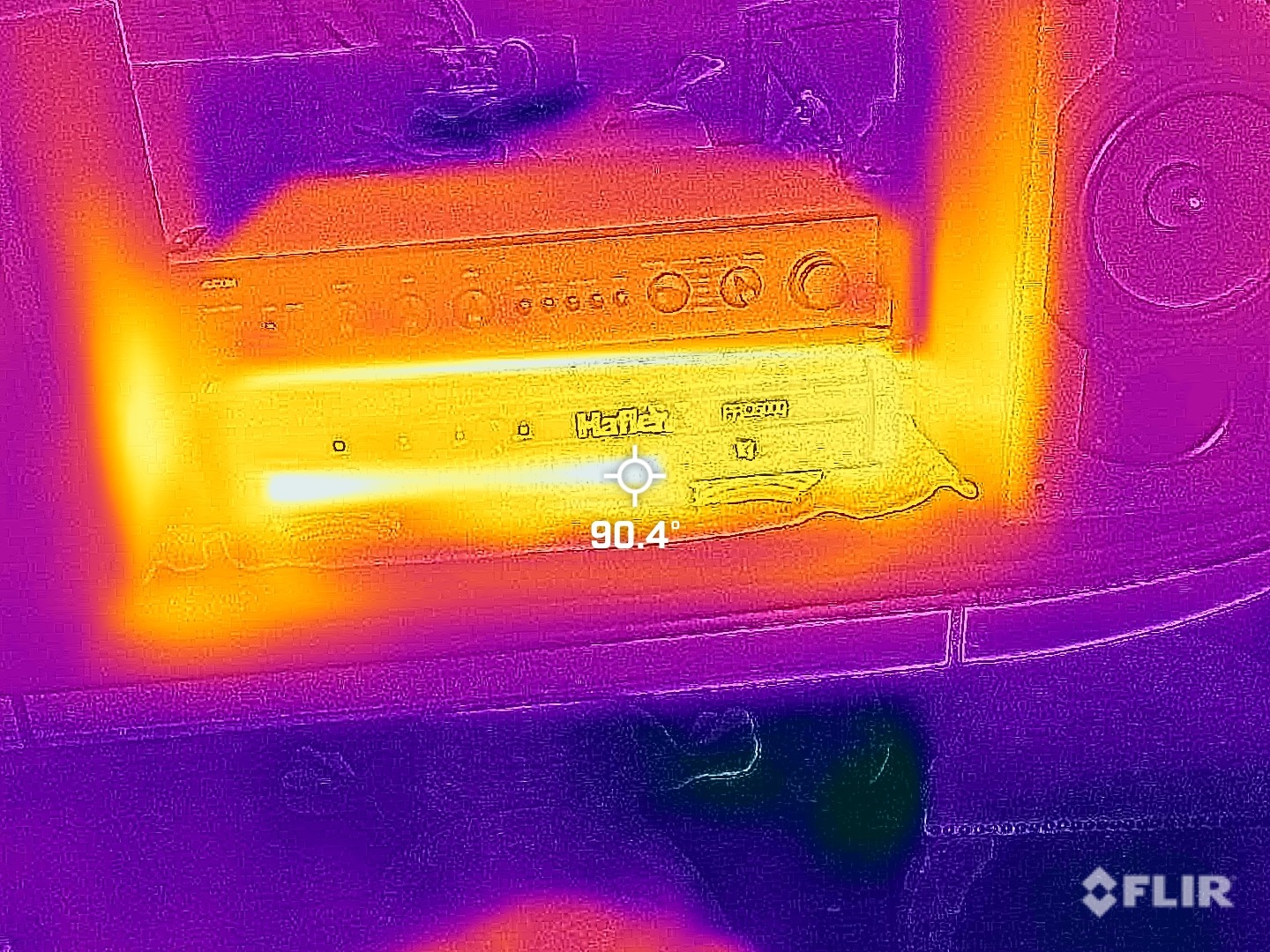

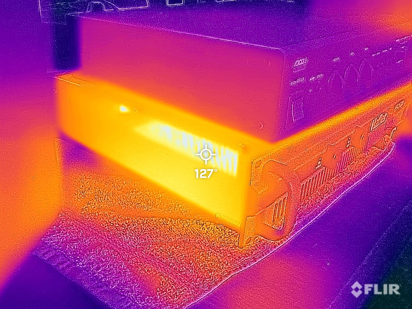

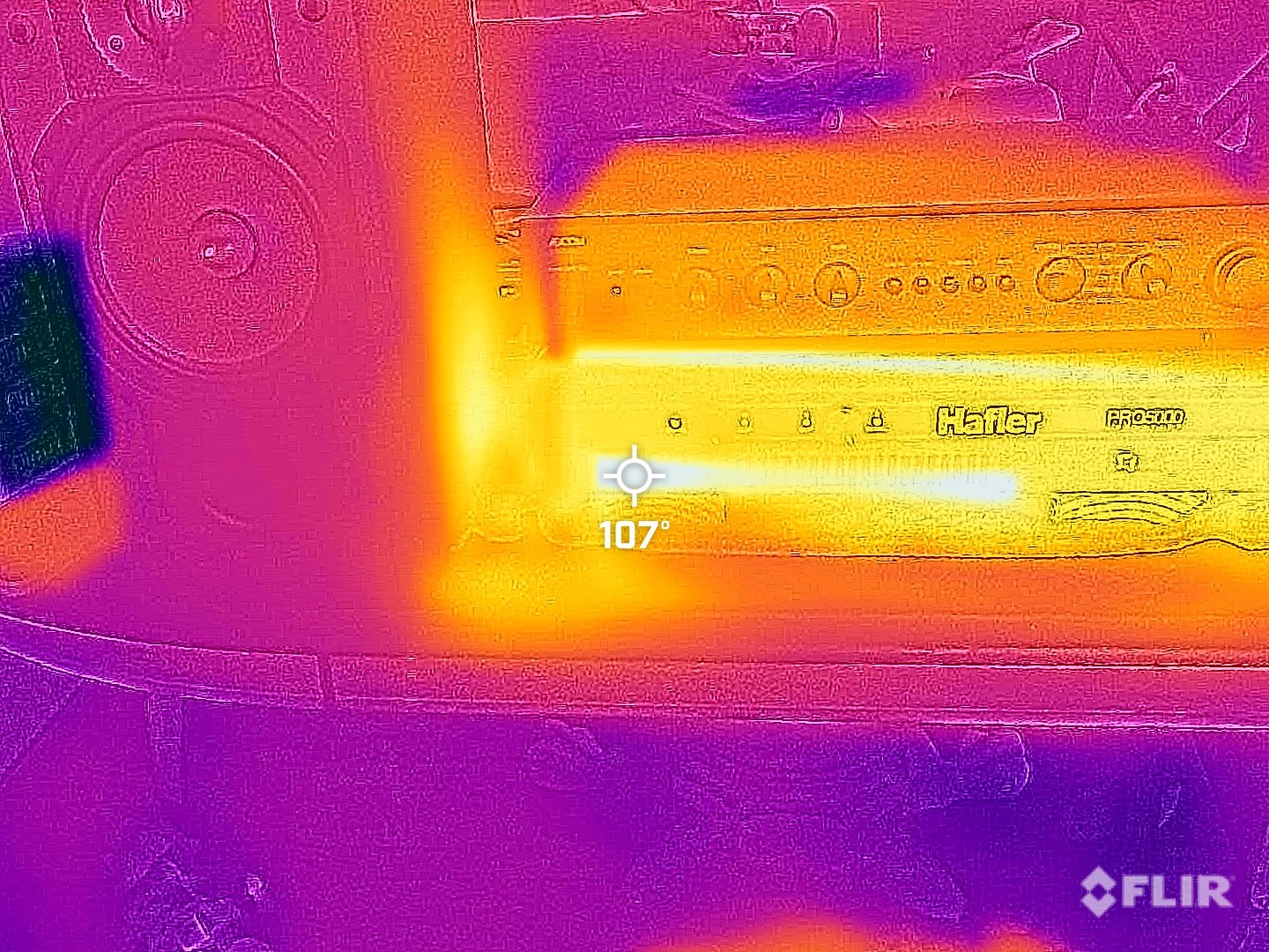

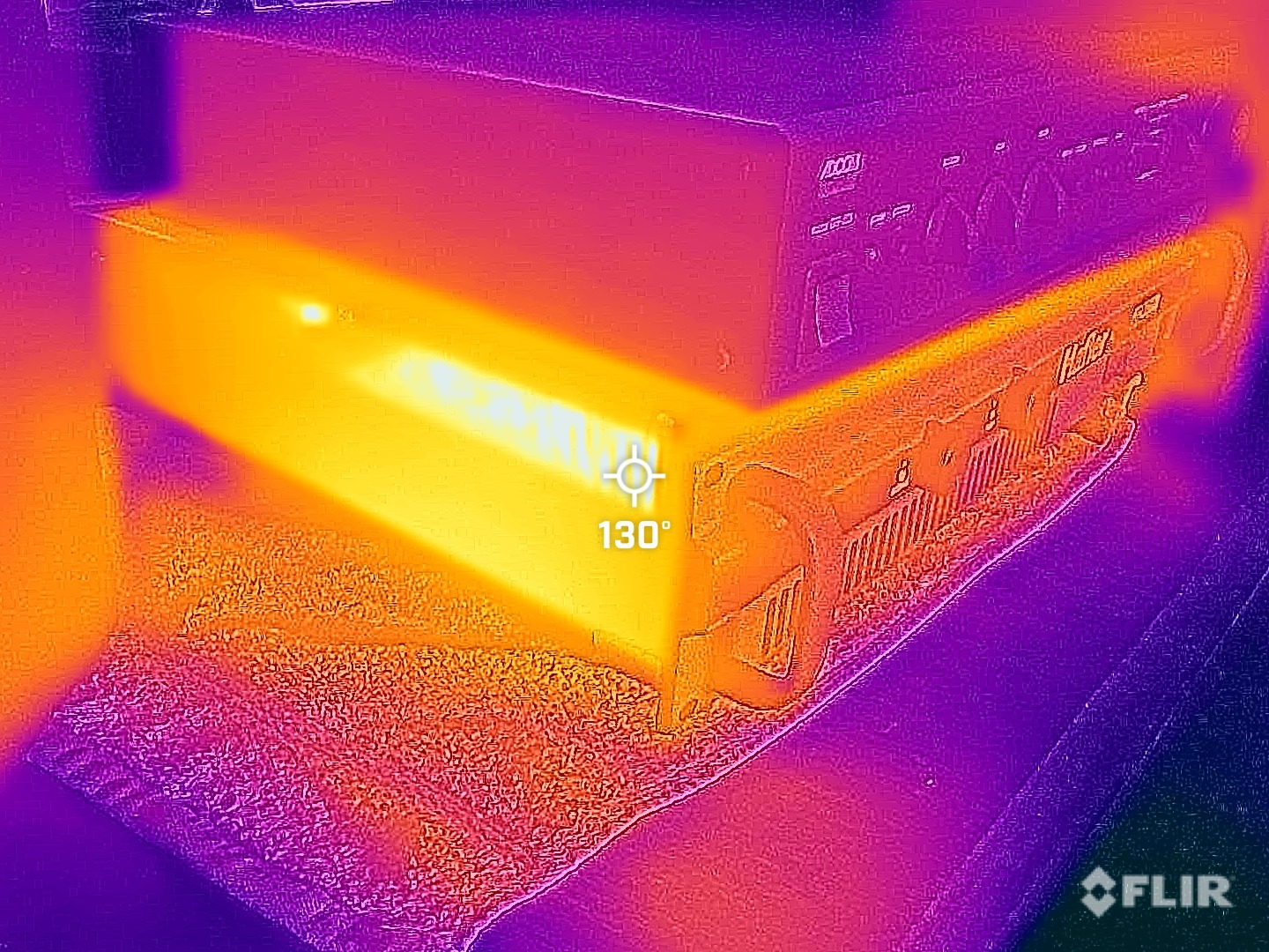

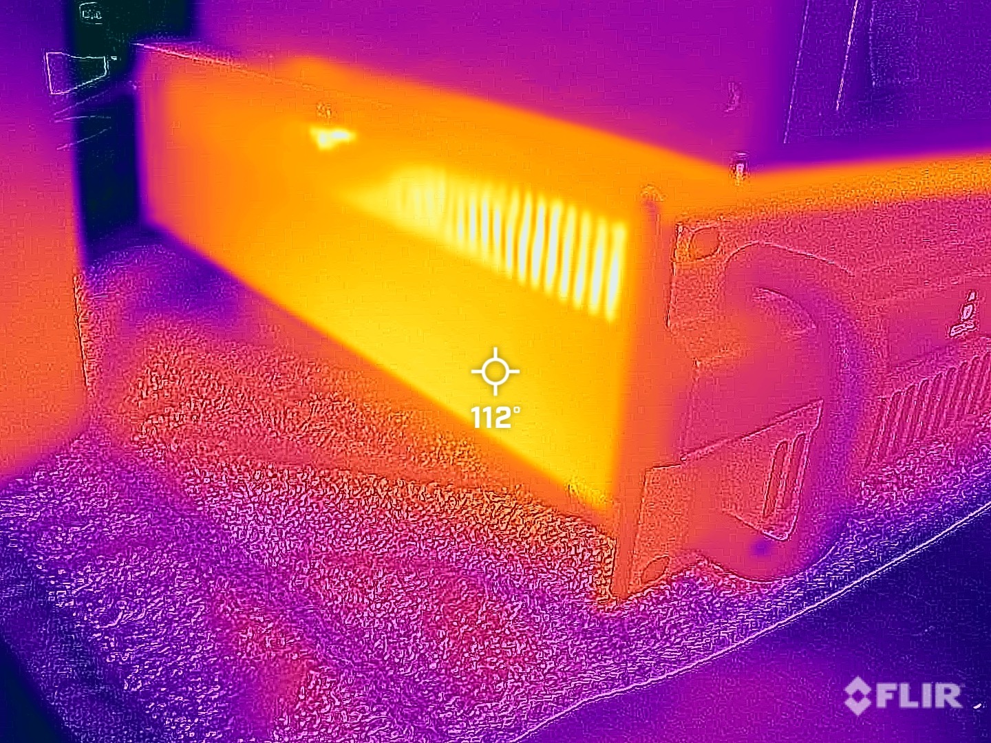

Here is the amp drawing 2.4 A after several hours of playing music and not a very loud level. Even with no music playing the temps seems to be the same.
Those are the air intakes. The exhausts are much warmer.
The side of the cabinet metal

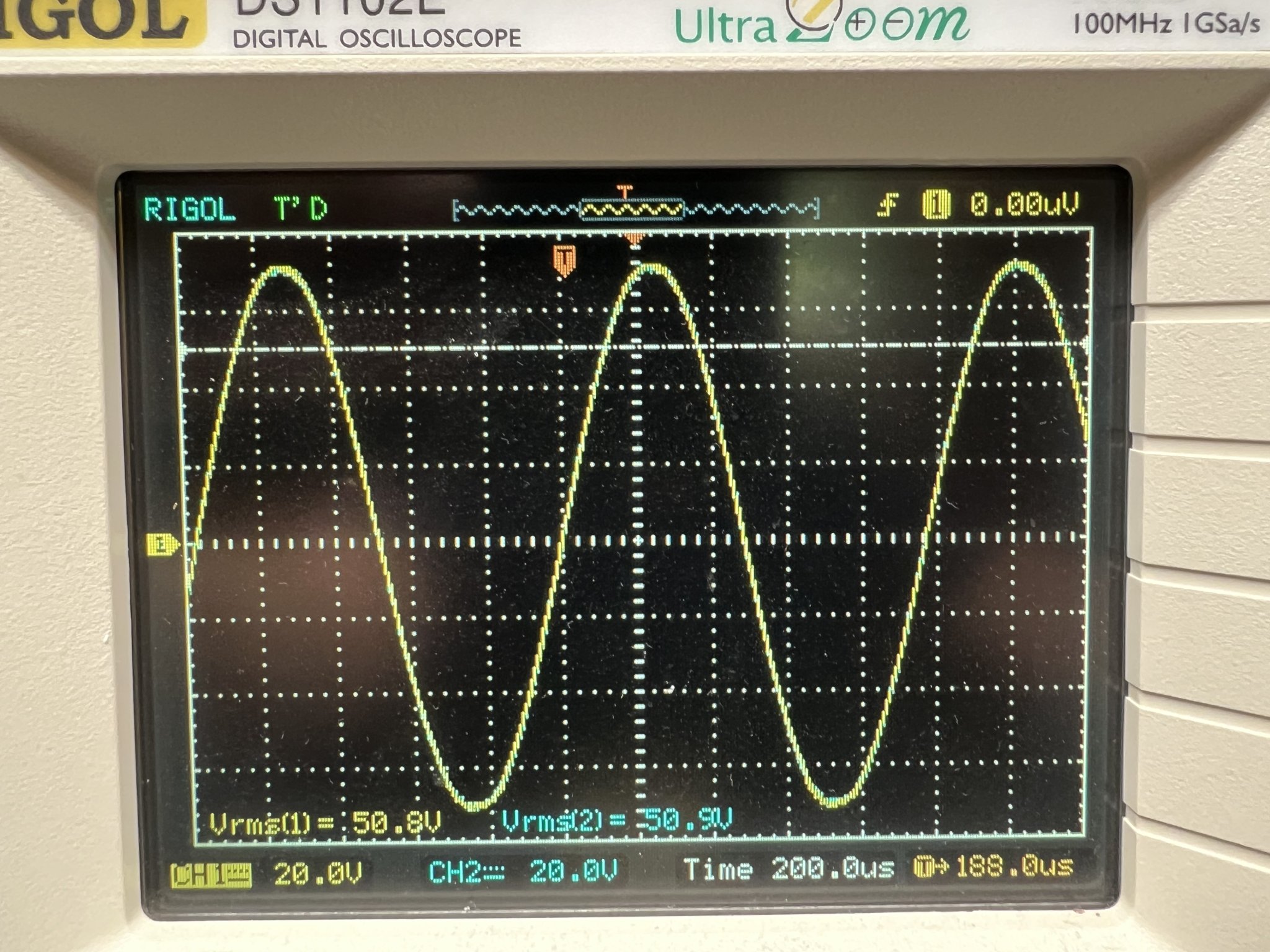

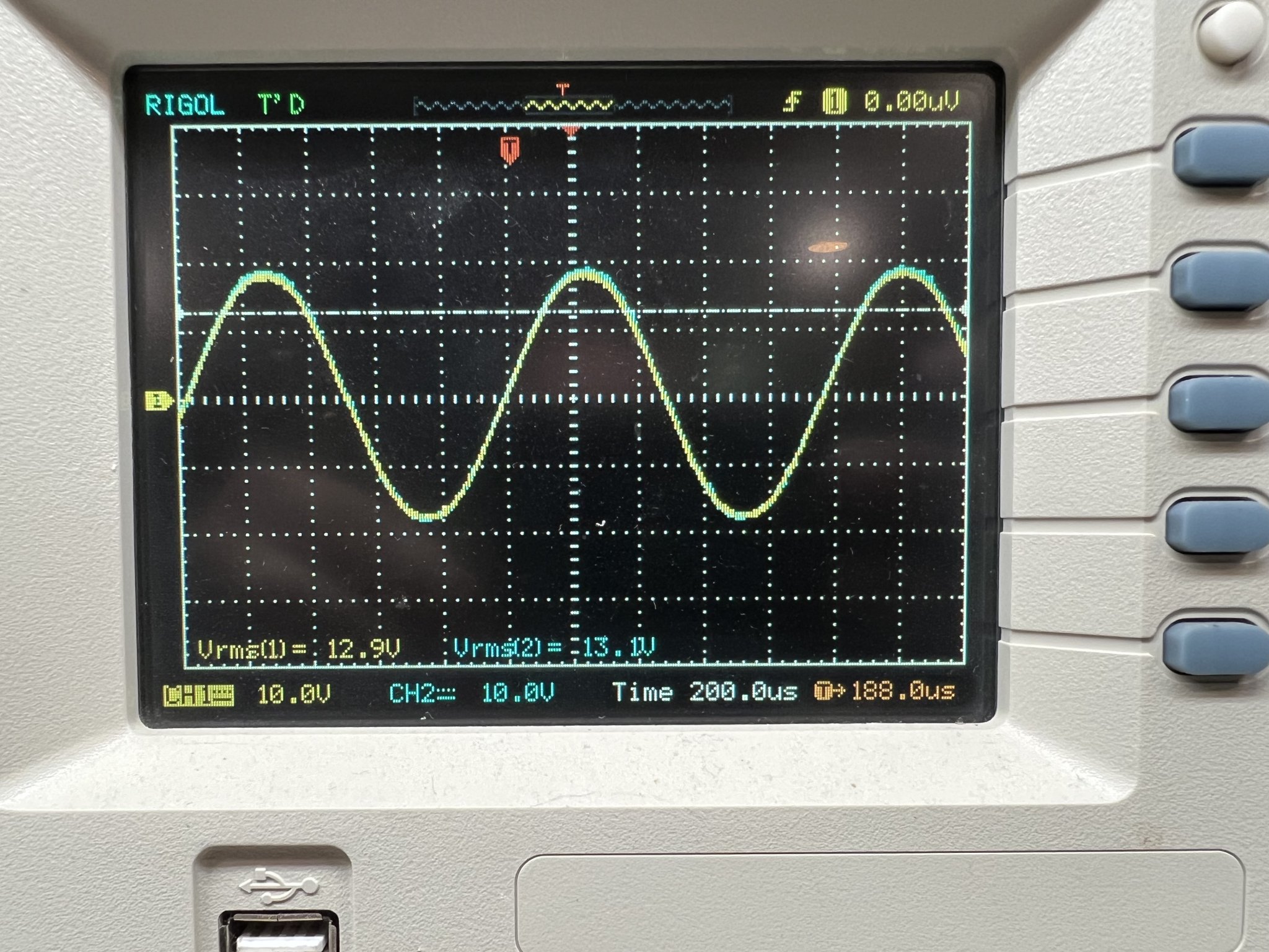

Puts out full power and clips symmetrically.
This is roughly the 325w and this is right before clipping.

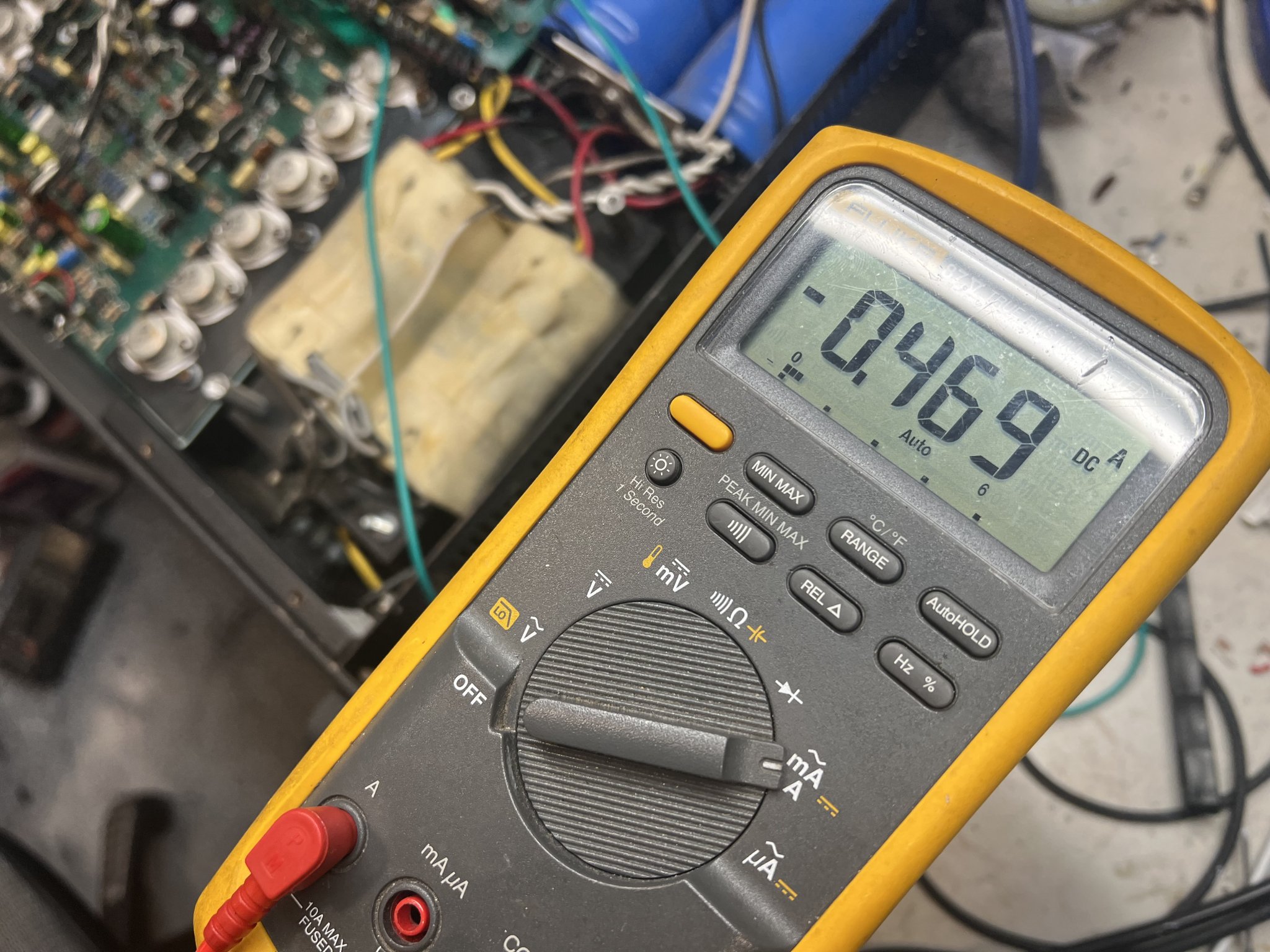

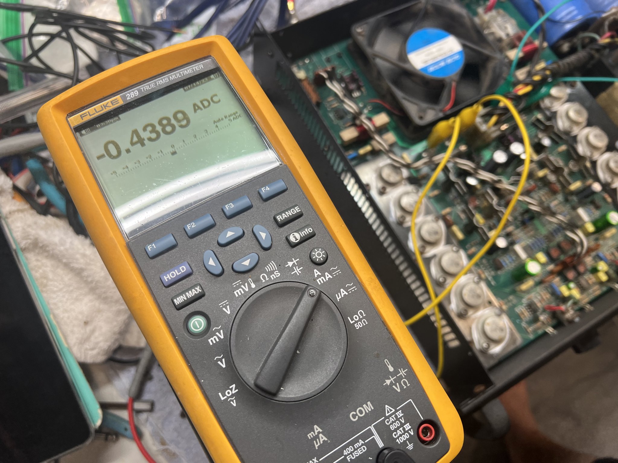

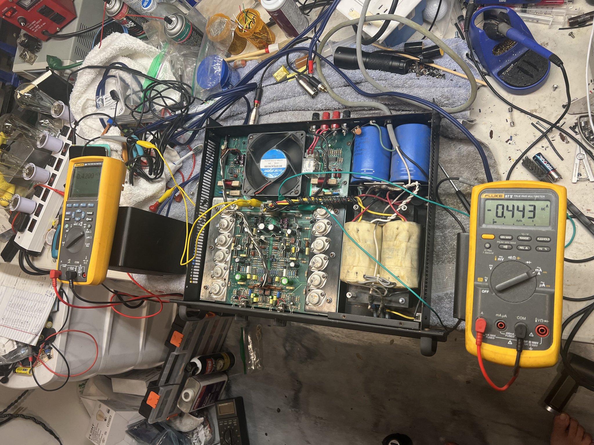

Awesome, I will take a look at that thread. I figured they did like some bias as every other MOSFET amplifier I have runs pretty warm. Going off of this information that you just mentioned here I went ahead and measured the current at the positive rail fuse on each channel. Thinking that it was possibly 300 mA I went ahead and use the 400 mA section of the meters. Quickly turn the amp off when I realized it was going over 400.
This is how I have it setup, no input and no load.
Please excuse the mess, once I’m finished with a piece I completely clean my bench and then the next piece gets it dirty all over again lol.
After warm up I had about 440 mA on channel A
And about 470 mA on channel B

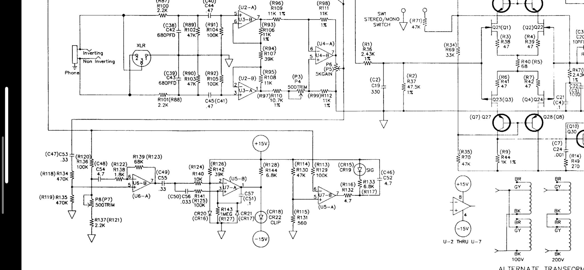

Does the cooler amp seem like it might be biased high? I don’t know this circuitry all that well but I’m guessing it’s pretty good at pulling current equally from both the positive and negative rails. Meaning that the negative rail was probably at 440 mA and 470 mA respectively. Should I turn those down closer to 300 mA so that they get about 100 per device? I’ll go ahead and take a look at that thread, it might have the answer for me. Another question I have, which also may be in the thread is about offset. The manual just states that if the offset gets high to contact the manufacture. There for other trimmers in the circuit, other than the bias in the gain.
There is P3/P4 and P7/P8. It looks like P3/P4 would be used to balance the output of an opamp in the input stage.
So my guess is those would be the trimmers I’d want to use. The offset is not horrible, about 30 mV on each channel. Nothing to worry about, but if I can get it closer to zero, why not. Thank you so much for the help this far.

Look for a trimmer marked P1 or P2 depending on the channel. Going to be closer to the output mosfets. Near Q31 and Q32.

P1(P2) adjust the idle current.
P3(P4) trim common-mode rejection balance of the input stage.
P7(P8) set threshold of the clipping detector.
Of course P5(P6) are gain.
I believe there are no offset trims. It would be possible to improve offset with a pot and fixed resistor on each channel, but probably fine as is.
