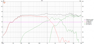

The FRD Like this:

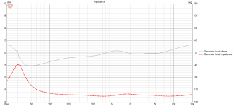

Impedance:

There is a lot of overlap between the drivers, this may have been intentional, but the combined response is above the individual responses for almost the whole speaker, the lack of breakup suppression on the mid is why it is still visible in the combined response.

1- I don't think that tweeter will meet the RS125-4 all that well. The 125's upper limit really is 3kHz, and you have to make it steep/elliptic to even get it there.
2- Agreed on the woofer coil being too small.
3- The aluminum coned drivers need to have the breakup damped to -25dB or more to made benign, with -40dB being much preferred. I don't see any notching to accomplish this, and the RS225's breakup is usually pretty audible without it.

Your impedance is low also, going below 3 ohms. You would need a good amp to cope.
If you used an 8 ohm mid to help with higher impedance then it would also decrease sensitivity which would help with baffle step on the woofer. Also the tweeter would need to be padded down which would mean a series R on the tweeter which would increase impedance in the tweeter section.
Yeah, I've noticed the low Impedance as well - I'm planning on building a new amp as well (based on either Hypex or ICEPower) - nevertheless I 'm, attempting to fix the issue.
I switched both the woofer and the mid to their 8 Ohm equivalents but I still get drops around 3.2 Ohm, so I'll have to see how that goes when I finished evening out this crossover.
