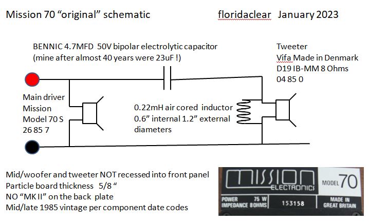

Detailing my Mission 70 original design in the attached schematic incase a MK II owner stumbles across this and has the equipment to describe their speakers. As far as I can ascertain "everything was changed" is circular routing the inside of the front wood panel to locate both drive units maybe 1/4" closer to the listener, a redesign of the X-over, and a new badge !. My thanks to all for their comments, floridaclear

The minimalist crossover arrangement shown was used to good effect in many loudspeakers, including the late 80s Mordaunt Short MS100 "High Definition" speakers I still make use of today.
The low pass filter is inherent in the design of the mid/woofer, producing a 6 dB/octave downward slope at the crossover frequency without the aid of an external inductor.

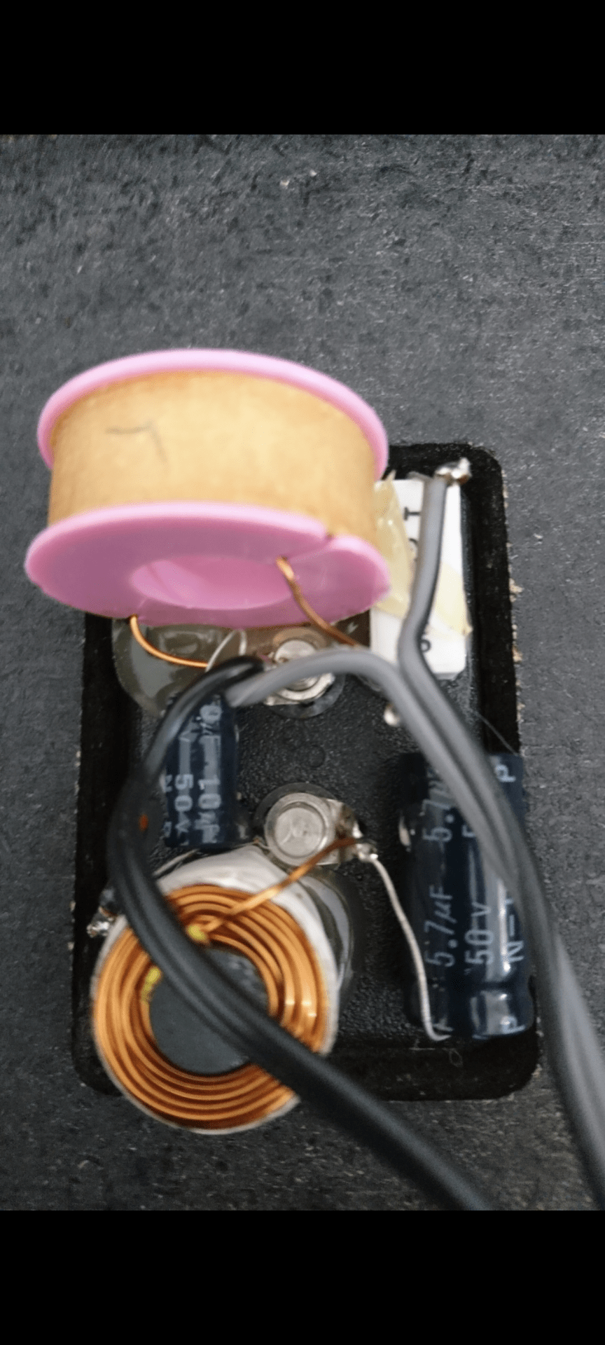

I haven't worked out the crossover yet on my pair but they have a further variation on those mentioned in this thread so far. They are a 5 element design which in due course I will try to get more detail on. But they have a 50V 5.7 micro farad capacitor (pretty sure it's an electrolytic) and, I think, a 50V 1.0 micro farad one. As I haven't worked out the circuit yet I'm assuming that the 5.7 is in the tweeter circuit with the 1.0 bypassing the bass/mid driver. There's one air cored inductor and one iron/ferrite cored inductor, additionally there is a resistor.
I'm attaching an uninspiring photo of the crossover.

Comparing your crossover to the crossover image shown in the attachment of post #49, the woofer is not simply rolled off gently by a series inductor (the iron core one), but more severely through the addition of a capacitor in parallel with the woofer.
The result is that both your tweeter and woofer are rolled off at 12 dB/octave instead of 6 dB/octave for just the woofer in post #49.
Your basic circuit is as below, with the addition of an attenuating resistor in series with the tweeter following the inductor.
P.S. Those capacitors are non polar electrolytics.
