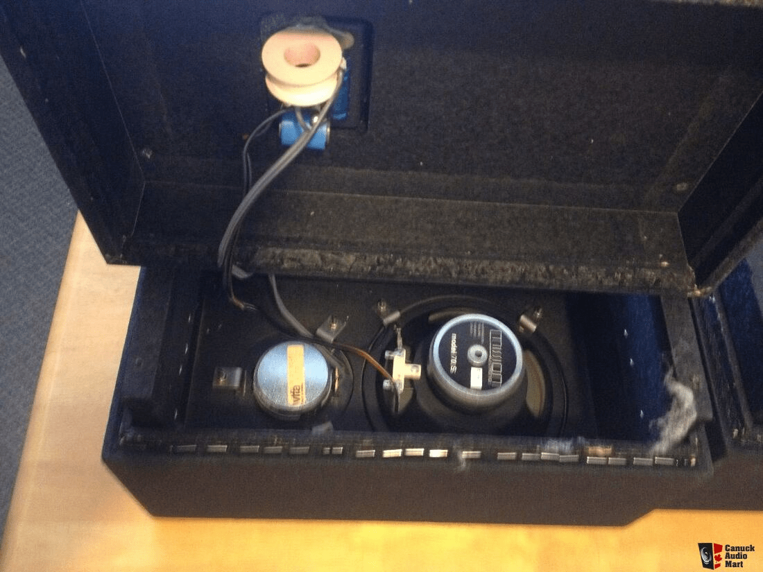

After years of being overdriven [ because of the simple first order XO ] is that tweeter even working ?
The problem with these tweeters (they where lower middle class at their time) over time the ferro fluid is getting thicker and drys out.
Apart from that (they may not have FF), the capacitor did sound bad even when brand new.
While you may not hear the difference between a WIMA 1.95$ 4.7uF industry film cap and a 98$ Munktorf "platinum in fish oil" cap, changing Benic for the 1.95$ part is in most cases clearly audible.
The whole x-over is a bare minimum and the cheapest it can get. If I see it right, it is 12dB/Oct for the tweeter and no limit for the woofer.
There are many woofers made from paper, that just tapered down without any resonances and can be used without x-over. This one got a foam surround and a bored out pole piece, so even with a steel basket, this is a well constructed, modern driver.
When these speakers where new, plugging a 200$ pair of speakers into a 2000$ amp could give very surprising results, compared with expensive speakers.
Mission sure made something right, using cheap, but well build parts, while many "high end" manufacturers produced horrible speakers, containing expensive components.
For example TSP parameters, the following construction rules and simulations where considered nonsense and not matching the reality by many involved in speaker building. A lot of sales talk and unfounded voodoo nourished by not knowing how to do it right.
Like today, where a well made x-over from good industry parts beats any carelessly constructed x-over from expensive boutique parts.
So please put these antique test reports in the right context.
These where speakers that did nothing wrong, while this was not the norm at that time.
Sure they can not match a well made speaker of today, but they do not sound “ugly” as many expensive, ear punishing products of that time and are still well suited for back ground music in a kitchen or workshop.
If you really want to step up in sound reproduction and keep the cabinets, buy a good, proven and well reputed loudspeaker kit, 300-400$ a pair, matching the cabinet. Follow the instructions and don't get creative!
Leave one speaker as is and then compare to the converted one. You will be very surprised, even as the real surprise will come with both in stereo.

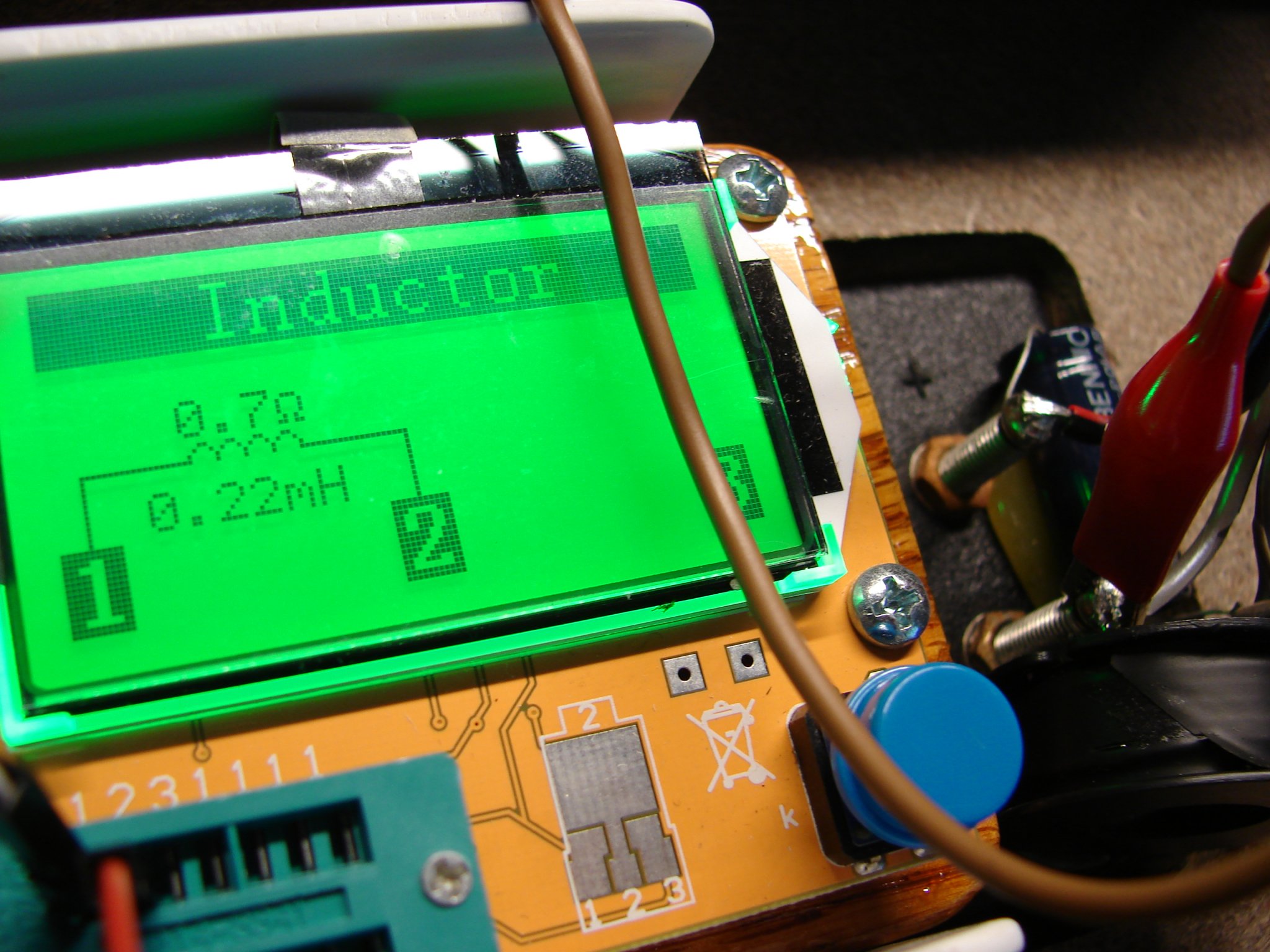

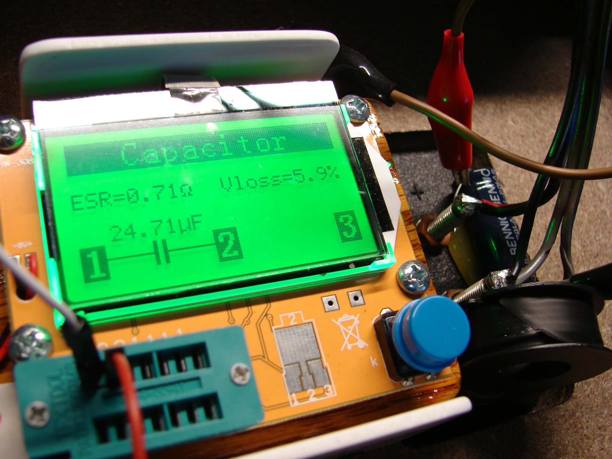

Thanks to all for the advice - great to get replies from Germany, Australia, Belgium etc. I'm in Florida, from the UK originally, recently retired electrical engineer - my career was nothing to do with audio, but I'm handy with a meter, soldering iron, etc.
@ Moondog55 I measured the Mission 70's 40 year old Bennic 4.7MFD capacitor at 24uF (please see picture), both directions the same, my meter is accurate - so yes agree the first thing to replace !. Interesting how after time it is now larger capacitance - probably the plates are now closer together as it dried out ?, increasing the capacitance.
Amazon US have a 4 pack of Nichicon ES bipolar 4.7uF 50V audio caps for $9, easy to order, so planning that route.
I removed a wire from the woofer unit, and connected the speaker back up to the amplifier, the original Vifa D19 tweeter still "works" after 40 years. Sounds clean, no "grating or clipping", though very "quiet" without the main driver. If the tweeter "works" at all, does that mean it still has ferrofluid and has not "dried up" ?, or how do I tell if it has dried up after almost 40 years ?. There is no mechanical damage and it has always been in controlled climate.
If I understand right a bigger capacitor in series with the tweeter would allow more midrange frequency signal, so maybe damaging it over time ?.
My stands are 17.5" high, with the tweeter at 21" off the floor - a bit low maybe ?, but fits my furniture.
@ Galu & TurboWatch2 Appreciate your thoughts, it's tricky when you see both glowing and damming reviews of the same speakers !, and have nothing to compare to. Yes, planning on changing the "tired" electrolytic first per above, then reevaluate.
If someone with a Mission 70 MKII could open it up, and send us the X-over schematic, that would be great. Maybe I should start a separate post ?. The original Mission 70's I have use a simple 2 component tweeter cross over. 0.22mH inductor (see picture) in parallel with the tweeter, clearly measured with tweeter disconnected, then the series 4.7uF (or in my case 24uF !), connected to the positive post. The main unit wired straight across the posts.
@ waxx Thanks for the interesting Seas link, should sound European !. The Loki maybe more the size I am interested in, will keep it in mind.
Plan of record :
1. Update one speaker then the other (so can compare) with a new Nichicon 4.7uF series tweeter capacitor.
2. I see the Peerless-D19TD05 reasonably priced at Parts Express, looks like a modern version of the OEM Vifa 19D, and thus plan on getting a pair. Unless the Tymphany D27TG35 at $10 more each would be a good upgrade using the same X-over, per Moondog55 ?. But that route unliked by Turbowatch2 if I read right ?.
3. Update crossover to Mission 70 MKII design if can get it's details.
Goal : Better sounding speakers, with not too many $$ spent if ultimately decide to buy a B&W CDM-1 SE/NT, Focal 608S, or a DIYS build. Hope of interest, and will update as task progresses.
24uF is certainly a high reading. You say your meter is accurate and I presume you've checked by measuring another electrolytic capacitor.
Whether or not the tweeter has been compromised in some way will be revealed when you wire in the new capacitor - so hold fire till then.
I'd upgrade to the better tweeter, others will disagree but as per Galu I'd wait until the new cap is wired in.
If someone with a Mission 70 MKII could open it up, and send us the X-over schematic...
There's a wee glimpse of a MKII crossover in the photo below. It looks to be a second order capacitor/air cored inductor filter on the tweeter and a first order ferrite cored inductor filter on the woofer. Not a lot of help without the component values, but interesting to see what the difference is compared to the MKI.
Sorry I needed to post such a large picture!
The changing of the capacitor (best sound for the buck is a non audio film capacitor, MKP, MKC or MKT) is the only thing you should do with your old speakers.
Changing a tweeter will need a new constructed x-over, even if you still don't believe that. Such a simple, two part frequency divider is much more complicated than you think. To get along with such low part count, you need extremly carefull matched chassis. I'm quite certain the tweeter is a special construction, with lowered sound pressure, so no resistor is needed. It was only build for this loudspeaker, not taken from any existing programm. Any large speaker manufacturer does such OEM chassis for customers like Mission. Just as Mission builds speakers for others, like Denon.
Any "similar looking" tweeter which you may wish to be an exchange part, will be much louder. The result will be a hissing speaker with a huge frequncy gap or peak. You do not want to understand the concept of an x-over to keep things simple in your imagination. You are not the first one with this mindset. The resistance of a chassis is not constant over the frequency, why it is called impedance, which makes any linear thinking useless and dead wrong.
If a tweeter has lost it's ferro fluid, it may distort audible or not. Some just loose load-bearing capacity and burn up when played at party level. Some, even after many years of use, still have a functioning liquid inside. A impedance test would give some hint's.
Don't waste money on this speaker's internals, 10$ including P&P is enough. Your measurements, which sure do not show the reality (maybe you got the decimal point wrong? 2.4uF would be probable), indicate that a correct 4.7uF capacitor will notably change the sound. Listen to both juvenated speakers for a while and decide what your next step is.
