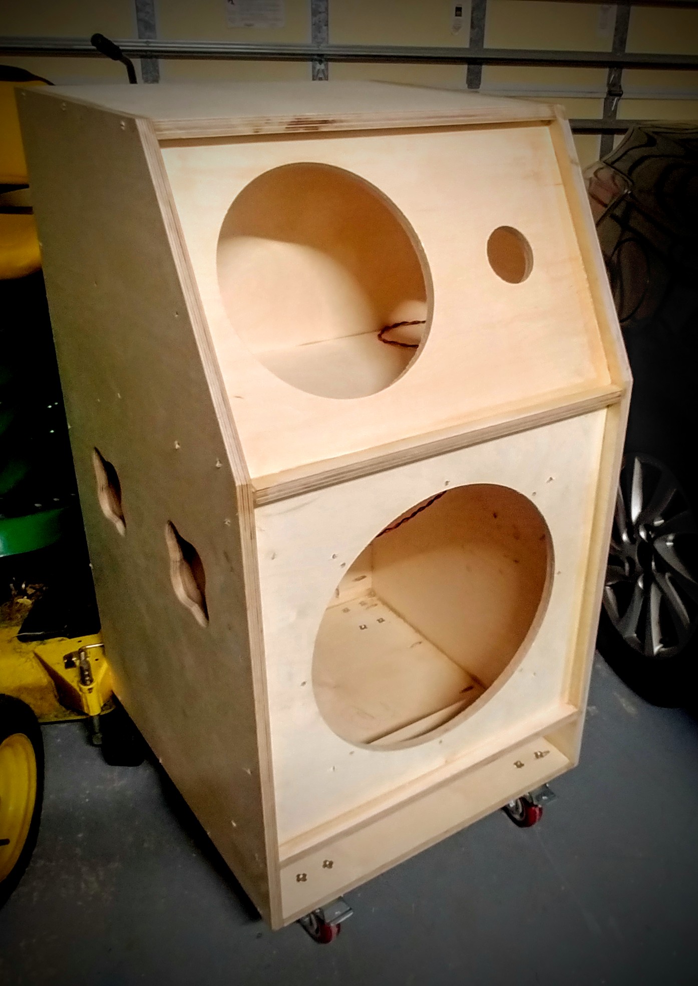

Here is what they look like for now. I purposely left room for larger horns, specifically the 1" horns on my current mid/high tops that will be upgraded next. These bullet tweeters were left over from another project
Measurements probably next weekend.

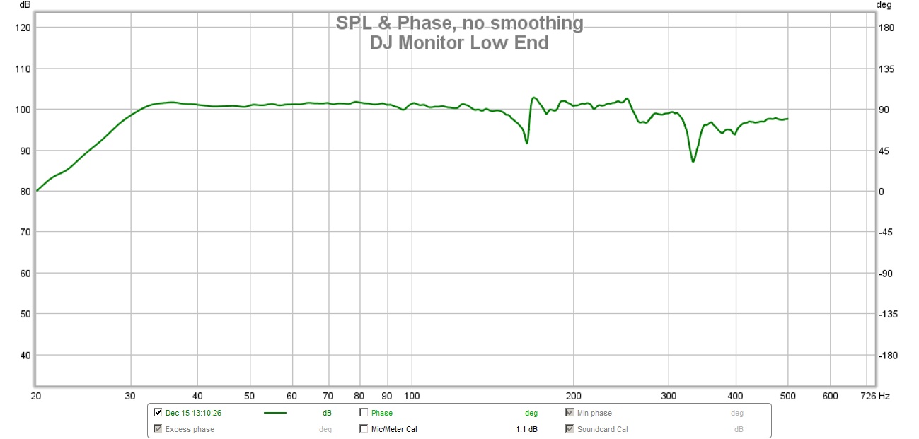

Wow, that looks much better than WinISP was predicting! So I believe you tuned closer to 30Hz rather than the sim'ed 37Hz. Sorry for asking, I'm on my cell, did you go 7cubs or 10 on your enclosure?
Also, what voltage was that SPL curve sampled at?
Just goes to show, even though bjorno modelled this design to the moon, the original spec's I posted seem attainable.

Freq response only, amplitude not calibrated....just adjusted the volume to get a nice signal for REW.
It is approx 10cu ft. Tuned close to 30Hz, had to make some adjustment to port length for the slot loading rather than just a rectangular port. I actually had the port set up for 37Hz with an extension piece to drop the tuning. I set up the first one for the lower tuning and liked it so I decided to set them both up to 30Hz.
Again, really good value for the money if you can live with a huge box.

I'm also kind of wondering if the Qts on these Dayton's made a late production rebound? Maybe they went back to original magnet slugs when they were rated mid 0.3x Qts?
Your Fq measurement looks to good for a driver that's supposed to have a weak motor assembly. Even in a large cab.
