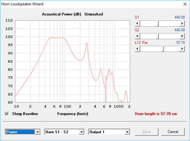

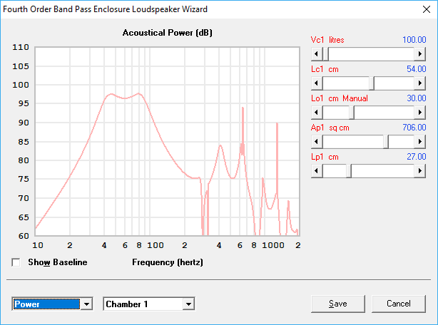

Thank you for the Sim.
You would certainly reside in the aforementioned camp-guru!
Man that seems crazy small, like 3.8cubes should be the open chamber vol alone.
Unfortunately, with high-pwr PA drivers I think the sealed chamber on a 4th order BP would prove to be a performance detriment. Pumping EDM material would cause the inside magnet to reach Fry-an-Egg Hot in <30-minutes. Which I could see degrading awesomeness to flabby one-note wonder in that same timespan.
I thought a read a few post of your's stating your mindset was favoring Mass-Loaded Off-set TL's nowadays. I also have read that alignment does pretty well with high'ish Qtc. Any thoughts?
Well, you could go with a magnet-out single-driver 4th order BP, but the net box size will increase (219L for this option). Vent will be larger, but it will be easier to go with dual-vent magnet-out design, which will assist with cooling.

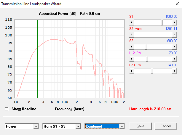

A basic 30 Hz offset TL with the same driver looks ok, but that's before semi-inductance is taken into consideration (second image). Box size also works out to be around 220L.
In box cases, sensitivity is lower than the "PA" target of 100+ dB/2.83V/1M

I got to tell you the TL graff looks better to me. Especially with four cabs. The phase curve on either end of a PB's bandwidth goes crazy, along with the GD.
If one enters in middle of the road semi-conductance #'s, does the FR go downhill? These Dayton's have 11mm Xmax which would almost be a waste in an BP. I think the TL design would allow it higher excursion = better VC cooling.
On the conservative side (TL) lets call 30Hz = 91dB, so 2x = 97dB, 4x =103dB and 40Hz = 107dB at 2.83V.
That seems crazy good to me for $480 of drivers.
I really need to download you TL worksheet! I'm curious if the low-pass was set to a max of 120Hz, if eliminating the offset would be a plus? Seems like it would gain a few dB's, but would the first null drop from it's 190'ish to at/below 120Hz? Would in-band ripple go way up too?
The other obvious +'s are better GD, much easier integration to the mains, and a tall'ish cab (easy to load into pickup truck). 100+Lbs cube shapes are not fun to deadlift past your waist, long cabs are a tilt on tailgate-lift- & slide in affair.

Definitions of portable may vary. My cab was around 2'x2'x4', and actually fairly easy to move with wheels, and fit through doors just fine. Handles and wheels on the back - just tip it and roll it into position.
In your case, then, I'd go for a pair of 4th order bandpass enclosures. Isobaric. I'd expect you could get it down to 150L.
With regards to sound quality, I was actually quite impressed with the bandpass design. It hit hard, but wasn't a one-note wonder - it played notes! They do rely on good design and constructing the cabinet as close as possible to that design. Car audio is an entirely different beast, and I'm not surprised you experienced variable results there.
When it comes to power levels, 6KW across four drivers will be plenty. Doubling the power gets you 3dB more level, minus heating and other compression effects. Bridging that Powersoft amp was more to find out what the cabinet could take. Apparently, quite a lot. I should've brought my big amp...
