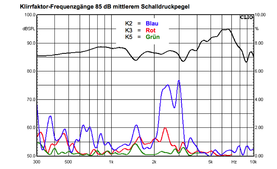

Did you look at the measurements?
The response is all over the place and the 2nd harmonic has peaks of up to 5%, even the 5th has a peak close to 1% and this at a level of 85dBSPL (I assume at 1m).
regards,
Gerrit
looks indeed like an error, even then 2e order is not that interesting 🙂 still there are peaks of 2% in the third to..... not to great
