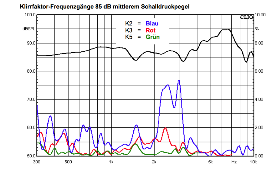

Did you look at the measurements?
The response is all over the place and the 2nd harmonic has peaks of up to 5%, even the 5th has a peak close to 1% and this at a level of 85dBSPL (I assume at 1m).
regards,
Gerrit
not totally believable given the 2-3kHz HD2 85 and 95 dB don't track by the expected ratios - I would expect its a measurement error
maybe there's a problem with using Kapton film instead of Mylar or PEN: http://www.diyaudio.com/forums/planars-exotics/44910-film-laminate-planar-driver-4.html#post2482009
