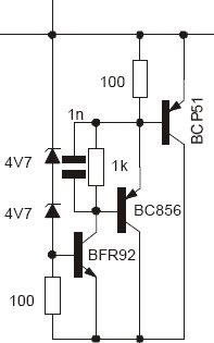

Hello
I this Thread is very good and interesting learning
I have taken this shuntreg from an old zapfilter (Lcaudio) I know it´s sound very very good, using it in my modified cdplayer.
It gives constant 10V out.
The Shuntreg is supplied like this:
Transformer-> Rectifiers-> serie resistors to set the current flow-> shuntreg -> load
Trans BCP51 take 100mA by it self (sinks)
Can some off you simulate this??
Eks: 15V DC supply, Current to circuits 150mA (100mA BCP51 and 50mA pulled by load.
Kim
