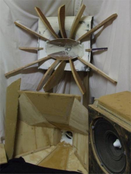

Below is an old photo of my elliptical waveguide during construction, which I used for several months. It was built into the old round waveguide (the white square section) which was around 60cm across. I then went back to round and extended it to 80cm where it reaches 180 degrees. 500Hz performance is better at this dimension although the old (60cm) one could do 500Hz with some tweaking. At higher frequencies the ceiling reflection is a few dB higher but a ceiling absorber does more for that than the shape of the waveguide can.

Yes, to a point. I have tested profiles using floor mats (especially at the mouth) because they are easy to shape and are fairly well damped. That said, some parts of the horn need to be solid, eg. mid/mid-bass horn rear chambers and throats out of seasoned hardwood. The seos would require more of a lip at the middle of the top and bottom than at the corners.What do you think is the best (time efficient) way to make extensions? Can they be pretty lightweight?
The problem with an extension is that it is not mechanically terminated and can ring at the edges. I have made roundovers using floor mats with thin fibreboard backing, or a piece of wood and wall spackle (polyfilla or plaster) to build up the curve. When a mounting surface exists but the curve is not yet at 90 degrees, I have bordered it with halved cardboard tubing.

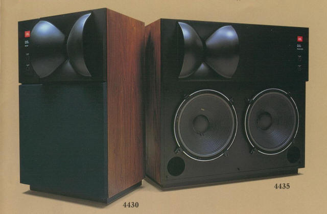

The 2360 looks like the horns in the 4430. There is anecdodal evidence about.
Here is a photo of the 2360... Doesn't seem like the same horn as what's in the 4430.
Those are the 2404H, AKA 'butt or baby cheeks'.
