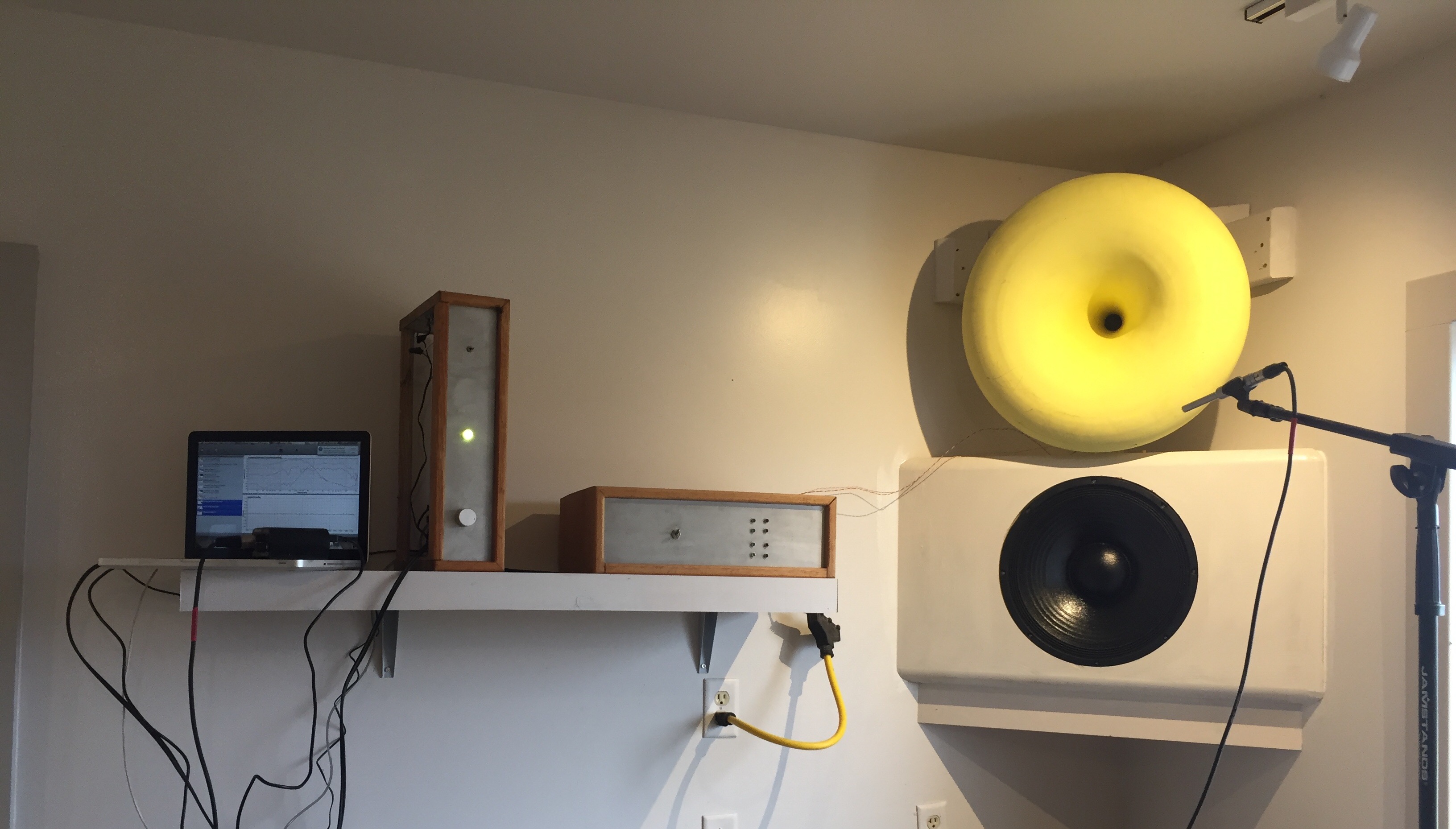

Okey dokey. They do have common features both appearing to be radials with a diffraction slot. I'd assume they'd have similar properties, such as those Greg mentions in post #31..
Seems reasonable, JBL obviously couldn't build anything that infringed on Altec's patent, but from just looking at the 2360's published data it may be a better sounding horn in a typical HIFI app, though a mouth foam surround smooths the mantaray right out.

Yeah , from reading around on the various forums, people do seem to prefer the JBL 2360 over the Mantaray mr94.
Shipping isn't really an option though with these large horns as the shipping ends up costing more than the horn. I've got my eye on eBay though if any come up nearby. Also still considering building a horn. It would be nice to have something that fit tight in the corner so the wall would be an extension of the sides of the horn. I have the space for the 30" wide horn, but the 30" depth plus the driver itself pushes the horn out away from the wall.

Although I have reservations about fitting a tweeter tight into the corner, the problem you have is the loading properties of the horn which result in the diffraction slot and the spacing away from the side walls that this causes. A plain conical will fail to load adequately somewhere around 1k. Another option which is probably more correct for the situation is to turn a radial so that the conical parts quarter it based on the side walls. Something has to give. If anything though, a compression tweeter can get past this in a domestic situation.
Thanks Allen, let me see if I got this right.... you don't love having the horn tight into the corner, but it would be even worse if it was out a couple inches since that would create a diffraction slot.
I lost you on quartering the corner with a radial horn.
By Radial horn you mean something like the JBL 2350? Not sure about the quartering....

The horns in this (your last) picture are also radial. Imagine four of them side by side would form a circle as seen from above (like four adjacent corners). The picture you posted before this one has its straight walls on top and bottom (which can be a good thing which is why I like a conical all round). The diffraction slot is the second opening after the long throat.
Radial is the corner horn ideal, but considering how difficult it is to get into and out of a corner (to cut a long story short) I'm wary of 3kHz after compromises have been made, as nearby mismatched walls can potentially double your imperfections. There is a correct way to do it but the potential compromises to consider are numerous. Midrange is a different story.
