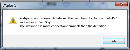

Followed the steps. Made a new AD745J.sub to the sub directory.
Then placed an opamp on the circuit, which I renamed AD745J, with the .inc AD745J.sub loaded.
What I get is this message.
Now another question. How I get to load and use the model without using the .inc command, like I do with transistors and diodes?
I missed one step, after you renamed a file to AD745J.sub, open it and replace existing spice model with AD745J spice model and save it in sub folder. It should work now, my bed...Now I have to take a nape...yes I am old enough to do that🙂

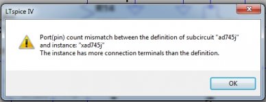

I had done that, with AD745J 1 2 3 4 5 for the pins. Got that message.
Now I changed that to:
* Node assignments
* non-inverting input
* | inverting input
* | | positive supply
* | | | negative supply
* | | | | output
.SUBCKT AD745J 3 2 99 50 37
And got an error mismatch between AD745J and instance xu7. What is that instance xu7?

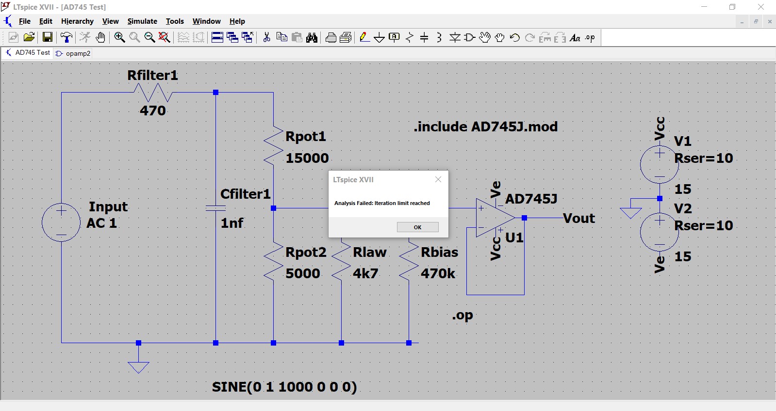

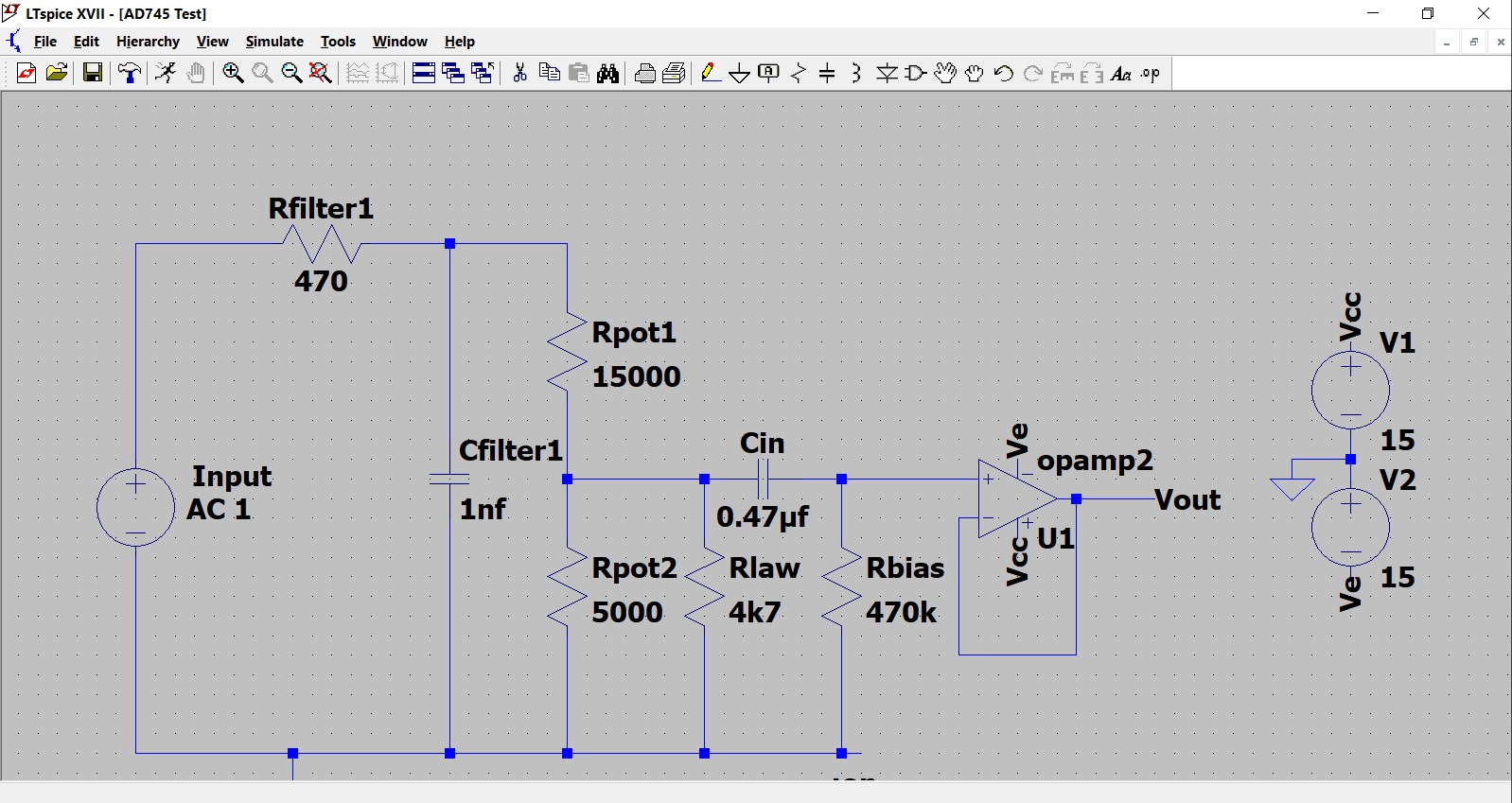

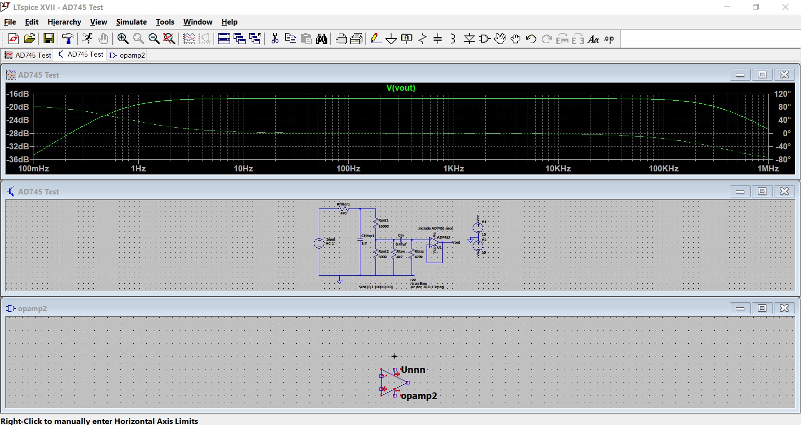

I just tried my method again and simply altered the pins in the model symbol to correspond with the text file numbers and it seems to work OK
I just want to play a little more though...
I saved the .asc and the opamp model configuration, closed the file and then reopened it and it wouldn't run 🙁
