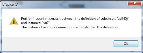

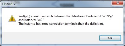

This the error message I get when I try to run the simulation.
Please upload your RIAA .asc file so I can see the problem (it seems your opamp U7 in schematic has more then 5 pins).

it seems your opamp U7 in schematic has more then 5 pins.
Yes, you're right. The AD745 has 16 pins.
https://www.analog.com/media/en/technical-documentation/data-sheets/ad745.pdf
But only 7 pins are operational. I don't know why they did put it on that body.
